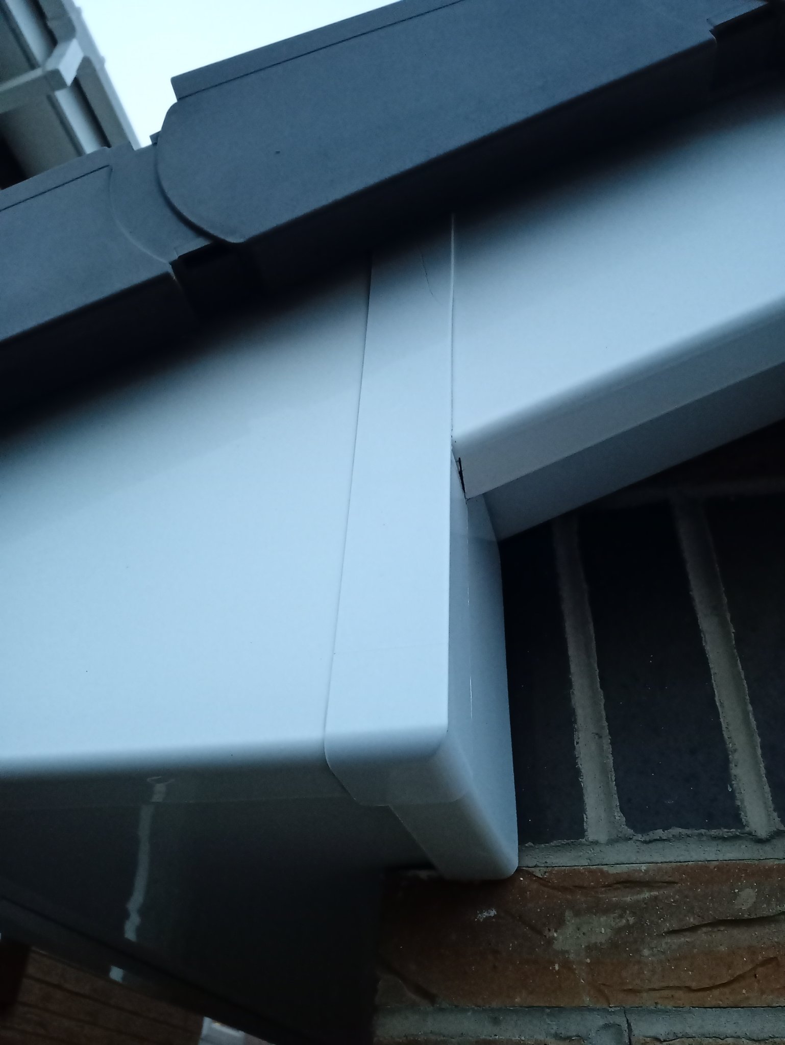

Is this just a 90 degree corner
10 Jun 2020
65
Hi. If you zoom in you can see a crack I've filled it with silicone to make it less obvious. Do I need one of these and just cut it. I know there super glued on anyway to get it off with our damage ? Thanks Paul
Not totally sure what you’re asking but if you need to zoom in on it then there’s no way it’s going to be noticeable from the ground so I wouldn’t worry. The corner trim will be stuck on with silicone or some other adhesive.
Thanks it's on the garage so low level if it was on the house I wouldn't bother
Trying to remove that trim will cause all sorts of swearing.
A little bit of super glue in that crack if you're really worried.
Mind the drop that will inevitably run towards the ground, so be ready with a tissue (quick wipe action so it doesn't stick).
You may want to silicone the saw cut and the adjacent joint too. Water ruining down the barge capping will be going in there.
