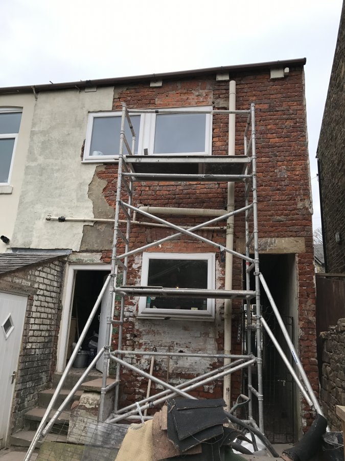

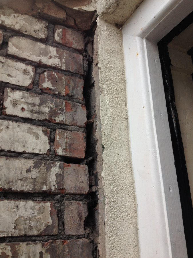

I would have expected to see far more movement in the brickwork and severe deflection of the plastic windows if there was no lintel.

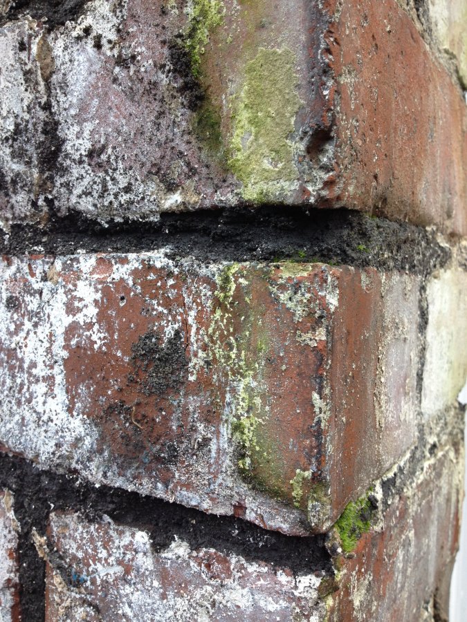

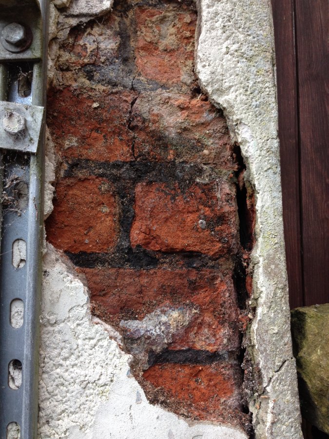

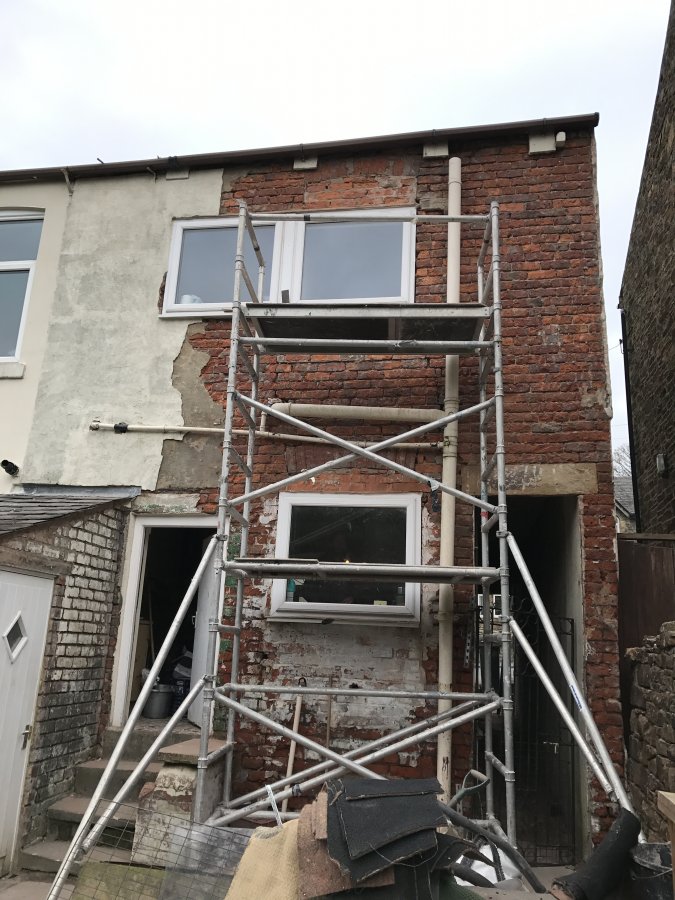

The render has been taken off the front and it's in a much better state than the back:
Again, the widened windows are relying on the original outer brick arches and inner wooden lintels.

The walls were originally built with lime mortar so any pointing, inside or outside, would be best in lime mortar but cement mortar is no big deal.
Any raking out & re-pointing would firm up the walls.
The interior "plastering" on outside walls should be in lime render, and the exterior in a modern synthetic render.

Your house is on a hillside sloping from L to R & Front to rear. You go down steps at the front and up steps at the rear. This might have some bearing on any leaning or cracking, and the parting at the rear outrigger.
