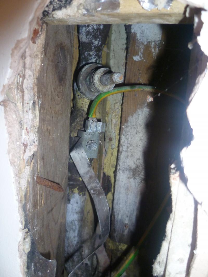

Hi all,

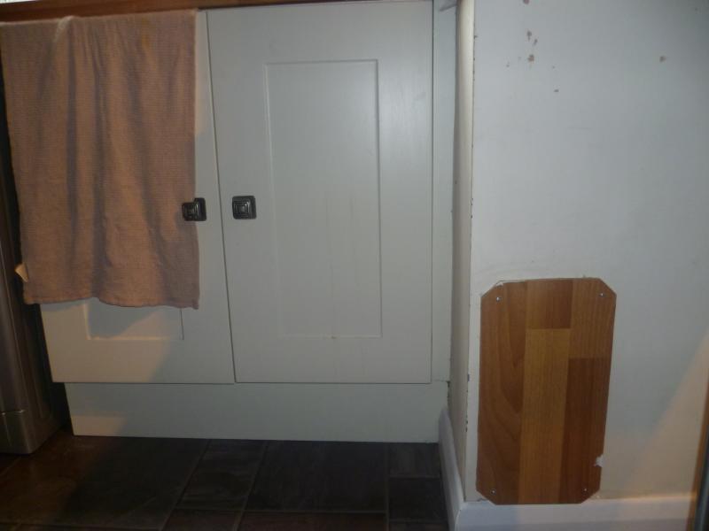

we've not been in our house too long and I'm looking for our stop valve / stop-cock. It's not under the sink and it's not under the stairs, where the boiler and meters etc are. It's a 1930s semi and has some old looking pipes and fittings etc.
There's a strange looking covering near the kitchen sink, in what used to be the outside wall which is now part of the extended kitchen:

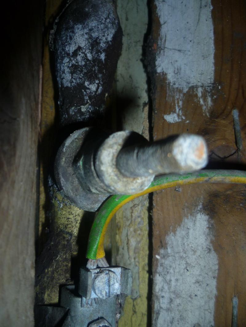

Upon removing the covering, I've found a strange looking bit of pipe work with a couple of bolts and a sticky out bit. Looks very old. Is this my stop valve?? Bit concerned about trying to turn it at all though, looks very old.
These should help:
close up:
Any advice would be great, thanks.

Yes you have found it. It's on a lead water main. The lead will probably go upstairs to your bathroom where it will be changed over to copper.
You should also have one outside the property somewhere.
Would be nice to get both working and then replaced.
Andy.

At the risk of looking stupid it doesnt look like a stop tap to me !
Its not a crytal clear image but it looks like a stop end on 15mm and its fastened to the lead with some kind of adaptor.
A perfect image would help !!
No stuffing box nut, no square end to shaft, and body just aint big enough to house everything. and It looks like a endfeed stop end on the end of 15mm pipe.
Look again Dan !
well image isnt fine enough but could be ! :confused:
It`s got 2 wiped joints on the lead :idea: I know gas fitters could only manage a taft with a blowpipe and spirit lamp on the tails from meters before they invented anacondas :LOL: The water supplier will locate their stoptap for the OP and also advise on lead replacement scheme / metering etc.
