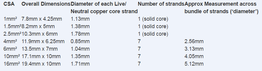

He's told me the cabling for the shower is 10mm. I'm not sure. Diameter of the live seemed around 0.5 cm including the brown insulation.
https://www.diynot.com/wiki/Electrics:flatpvccables
So 10mm refers to the overall width of the 'flat' outer insulation? If so then I think we're good on that front.
Got you. Looked at that table again properly and it makes sense. I'll have a look at the cable again.
