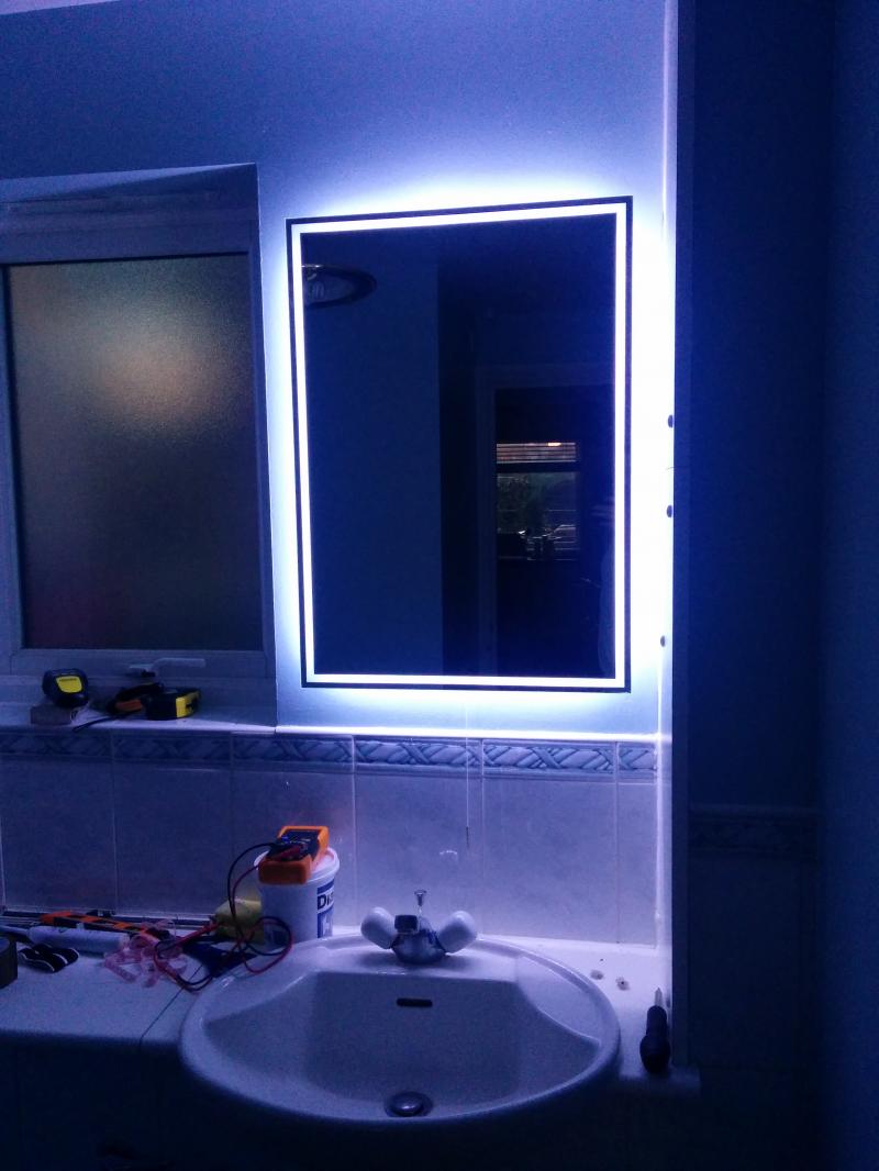

I've just completed installing a new LED/Mist Free bathroom mirror.
Previously there was a mirror with light and shaver socket so I've not had to run any new wiring. However, I did have to connect the old (1mm 2-Core + Earth) wires to the black (transformer?) box in the new mirror. I've read in my DIY book that work like this should be check by an electrician afterwards? What would an electrician do here? Is it necessary? Can I do any checks myself or should I really just get a sparky in?
Any advice appreciated.
There are a number of checks an electrician would make on a circuit to ensure the circuit was suitable for continued service.
I would for a replacement use the test required by a minor works certificate.
These would include the following:
*Confirming the type and existence of your earth arrangement.
*Method of fault protection
*Protective device type and cable size
*Adequate bonding
*R1+R2 readings (continuity of line/live and circuit protective circuit/earth)
*Insulation resistance of all circuit conductors
*Polarity
*Zs
*RCD
https://www.elecsa.co.uk/Documents/.../BS7671-Amd1-Minor-Works-Certificate-(1).aspx
These test would require the use of calibrated test equipment and a knowledge of how the the test should be performed and an understanding of the results given.
Normally I would not expect a DIYer to have the equipment or knowledge and in general they would not go to the expense of employing an electrician to do the tests. But some do consider the dangers of electricity and are wise enough to make sure things are safe.
