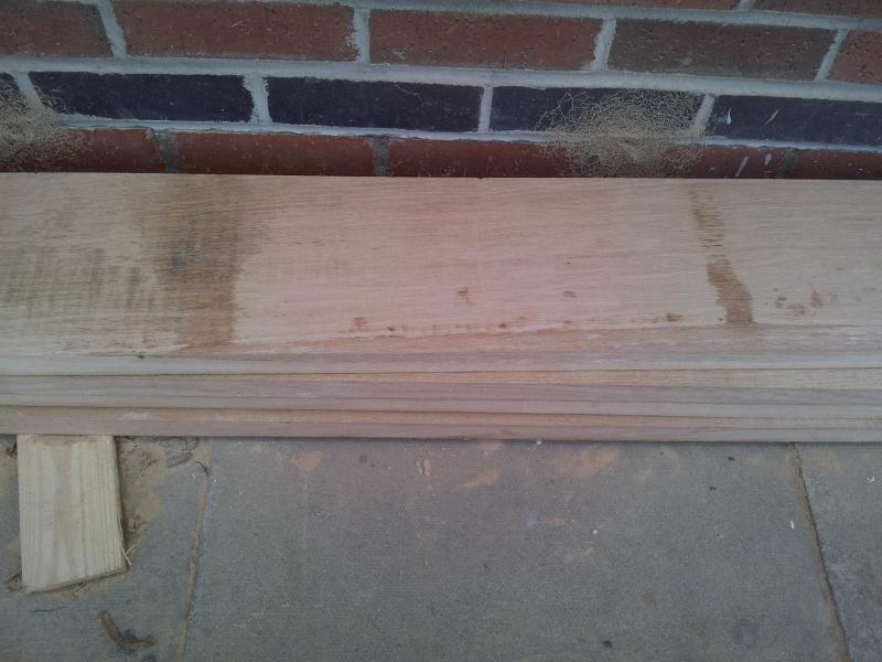

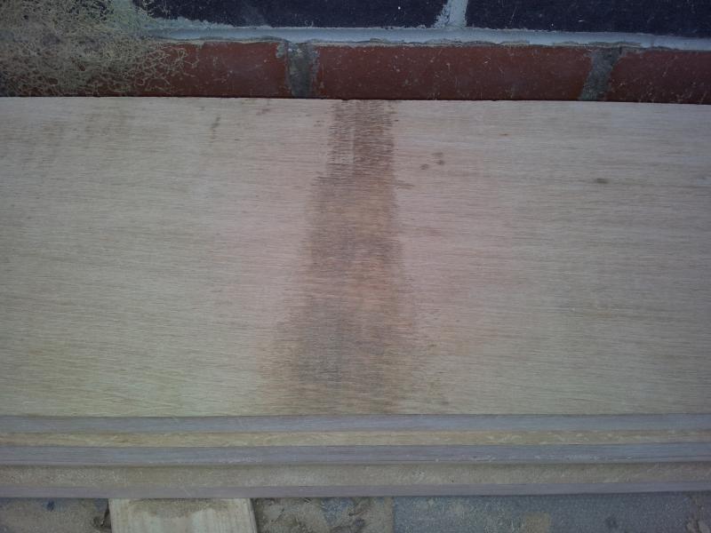

Hello everyone. I recently bought some rough sawn oak planks to make a tabletop out of,having given them an initial sanding 3 of the planks are fine but the third has got 2 dark marks across the width of it on both sides....please see attached photos.
i m not an experienced timber buyer so could anyone give me their opinion whether this is acceptable.
Many Thanks.
Those look like low spots the sander has not reached. So yes I'd say acceptable.
The first process for rough sawn timber is the surface planer, then run them through the thicknesser.
Then you have nice straight boards to work with. A local machine shop would probably do this for you.
Some hardwood suppliers offer the service also.
If this is green oak it will require months of seasoning, warping and splitting may occur.
The marks are just from it being "in stick" from the battens used to separate the boards. As already said they will plane out.
Looks like sapwood on the near edge of the top board (and others). That will need to be sawn off. It's soft, different to the heartwood in colour and texture, and won't finish well. It's not used for furniture normally. If you need a particular width with hardwood like oak, then you need to specify a clear width.
Thanks for all the replies....as you all thought with further sanding the marks have come out. regarding the sapwood i asked for some to be left on as i liked the contrast beside the rest of the wood. Hope it ll be ok !
