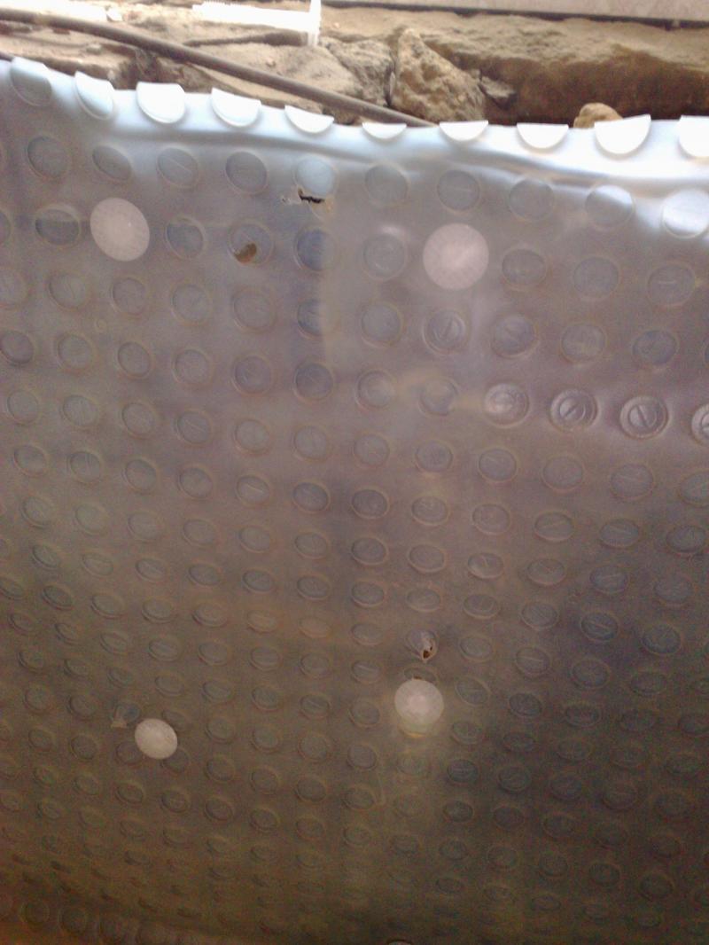

Hi everyone.
I've just had a damp proof membrane fitted today. I'm not a damp proof expert, but i thought there would be a bit more to it that running a roll of plastic around the walls and drilling it in to place. I know the materials aren't cheap (although they don't look like they cost the earth), but £600 for 2 hours does seem like a lot of money.
Also, is the plastic meant to meet the floor everywhere and does it matter that there's holes a splits in it? The damp proofer says not.
Here are some photos of the work, so any feedback is appreciated. I'm not trying to get out of paying the bill, i just want the job to be done right, but maybe i'm expecting too much.
Thanks in advance,
Rob

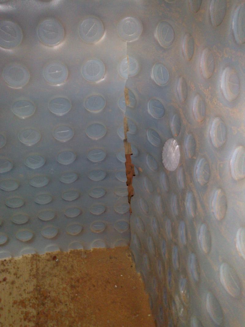

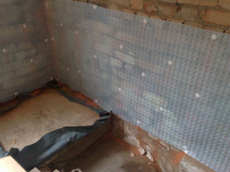

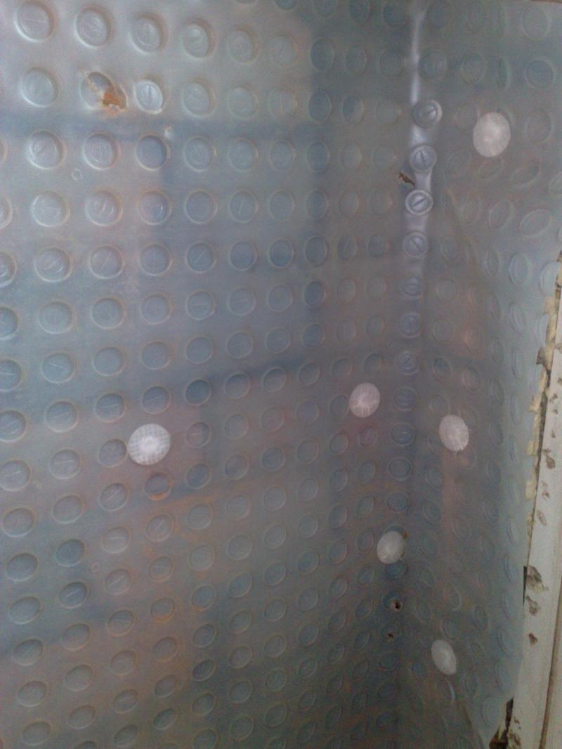

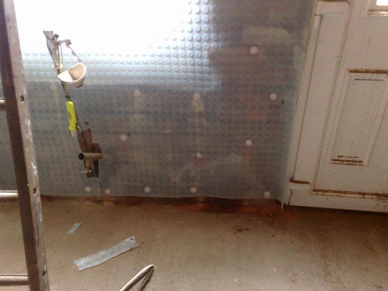

Our membrane doesn't look like all the pretty pictures in the magazines and what annoys me, is that i know i would have done a much better job myself, as i would have taken due care and attention to every detail. It's full of holes and splits, and in one place it doesn't meet the floor by 8cm's. This concerns me because the ground level is higher outside, so it actually feels really damp there.
Where do i stand now? The damp proofer says it's fine, but is it really?
Its not going to make a lot of difference whether it comes right down to the floor, normally it would have a special vent profile that sits at the bottom of the membrane against the wall that sits behind the skirting. This allows the air gap behind the membrane to breathe. What they've done looks a bit ragged, there's no need to have any splits on snags in it and the laps should be about 100mm, certainly no gaps, just shoddy workmanship really. A full description of what they should have ideally done can be found in the links already posted or the manufacturer will have a website I expect. Who is the manufacturer: is there any packaging left over or writing on the membrane? It will probably be ok but for £600 I'd expect perfection and these systems aren't brain surgery so there's no excuses really. What area did they do for that? Have you paid him? I take it the knobs are facing the wall? The last photy looks like the knobs are facing into the room! How did you end up choosing this system?

Doesnt look very tidy, and to be honest, i would have recommened a wet render system! Membrane's are quick to put up when batoned and boarded, but if the ground level is only slightly higher, you would have been better of installing the DPC 150mm above the ground level, and using two coats of 6/1/1 300mm past the last sign of damp.
The installation, as stated by freddy should overlap, as water will find the path of least resistance, but tbh, in an above ground level scenario, water penetration is hardly likely, as there is no hydrostatic pressure.
This should be a simple job, membrane, baton, plasterboard, job done! Although the wall will still remain hygroscopic, the membrane will stop anything from coming thorugh!

I had both the damp proofer and the local rep from triton Chemicals round today. I think they are both in agreement that it's below standard and the rep highlighted everything that needs to be to rectify it.
The damp proofer has said he'll send some guys round to finish it off properly, including digging a channel for any run off from the dampest wall.
At this moment, it looks like we may get a reasonable job done, but it annoys me that it wasn't done right first time and the completed job will be a patch up one.
I guess you live and learn and i'm incredibly grateful for both of your comments, because they gave us the confidence to argue our case.

You may want to check that the guy is registered with the BWPDA (bristish wood preservation damp association). Triton, (techincally) should only sell their products to qualified professionals!
The problem with these smaller damp proofing companies is that they are just not qualified to specifiy these sort of waterproofing jobs! To be honest mate, you dont even need a drainage channel if the ground levels are under no hydrostatic pressure. I assume the system will be relying on natural drainage? That system is basically there to deal with the problems of hygroscopic salts that you get when you have problems with rising damp!
