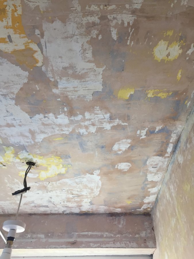

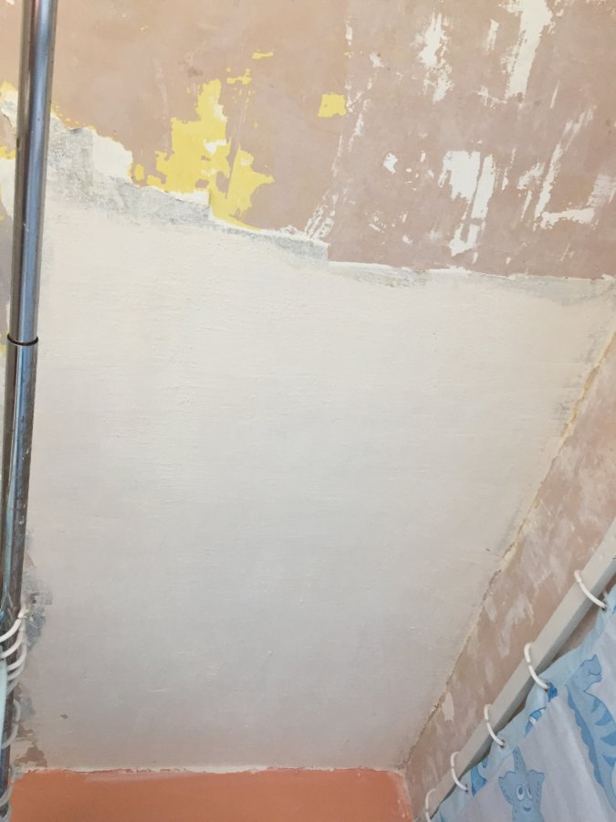

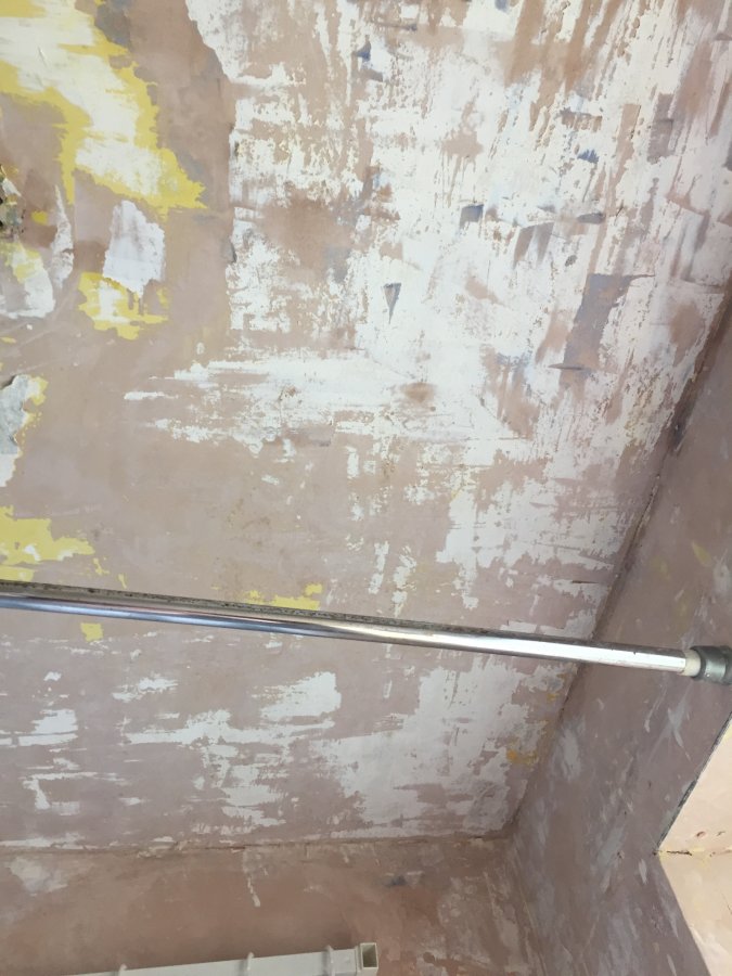

My bathroom ceiling had multiple layers, silk paint, removed with steamer, artex also removed with steamer underneath the artex was PVA and under the PVA some kind of sand textured paint I am down to bare plaster in about 50% of the ceiling area, the first picture shows the area still to be tackled I've been using xtex with ok success and a lot of graft I'm now left with areas I can't scrape any more off as it's too thin and the scraper slides over do I stand any chance of getting a good finish on this ceiling without a re skim, aside from the area still to be tackled, my thought process is sand the whole ceiling to remove any loose or flakey bits, give the ceiling a thorough wash with sugar soap to remove any muck dust and grease and paint with something like zinsser bin to seal anything that remains on the surface, fill and sand any imperfections once the zinsser bin has fully dried then water based undercoat and top coat was thinking water based satin, am I ****ing in the wind and should I save a lot of time money and effort and get it skimmed?
also please ignore the standard ceiling rose in the bathroom this is purely temporary so I can work in there after dark.
