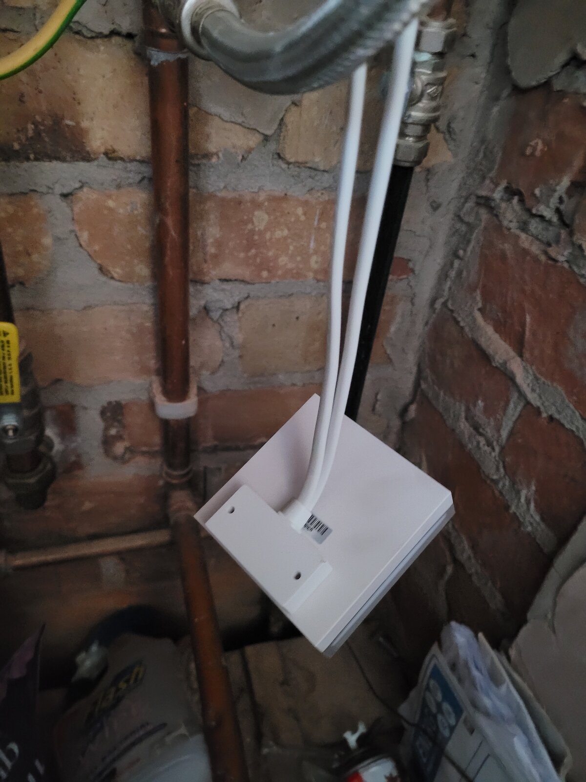

Is this thermostat compatible with this boiler?

Where would it get connected into this boiler? From connecting it to thr gas boiler I think there was two wires that just needed Screwed into a certain place on the electrics of it
Afaik, It’ll get wired into the wiring center, not the boiler.

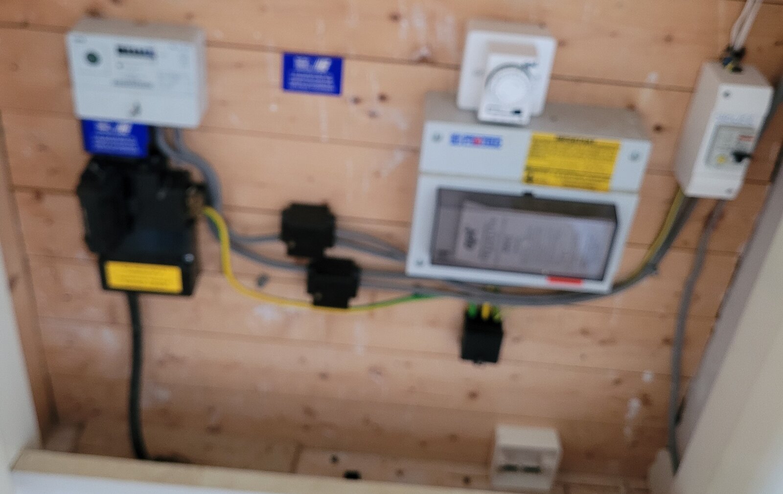

Okay so I am guessing my reciever in the first photo needs wired into the timer which is in my electric box?

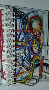

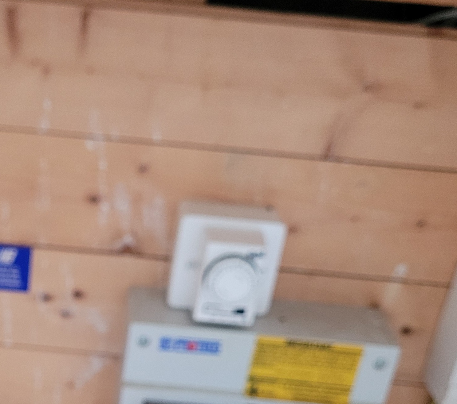

Is that timer for the heating? You should have a wiring center somewhere, which links the pump and any motorised valve(s).
I am not at the House now this was taken the other day. Its not the clearest does anything in there look like it could be it?

No, that’s all related to the consumer unit (fuse box). Try near the airing/cylinder cupboard.

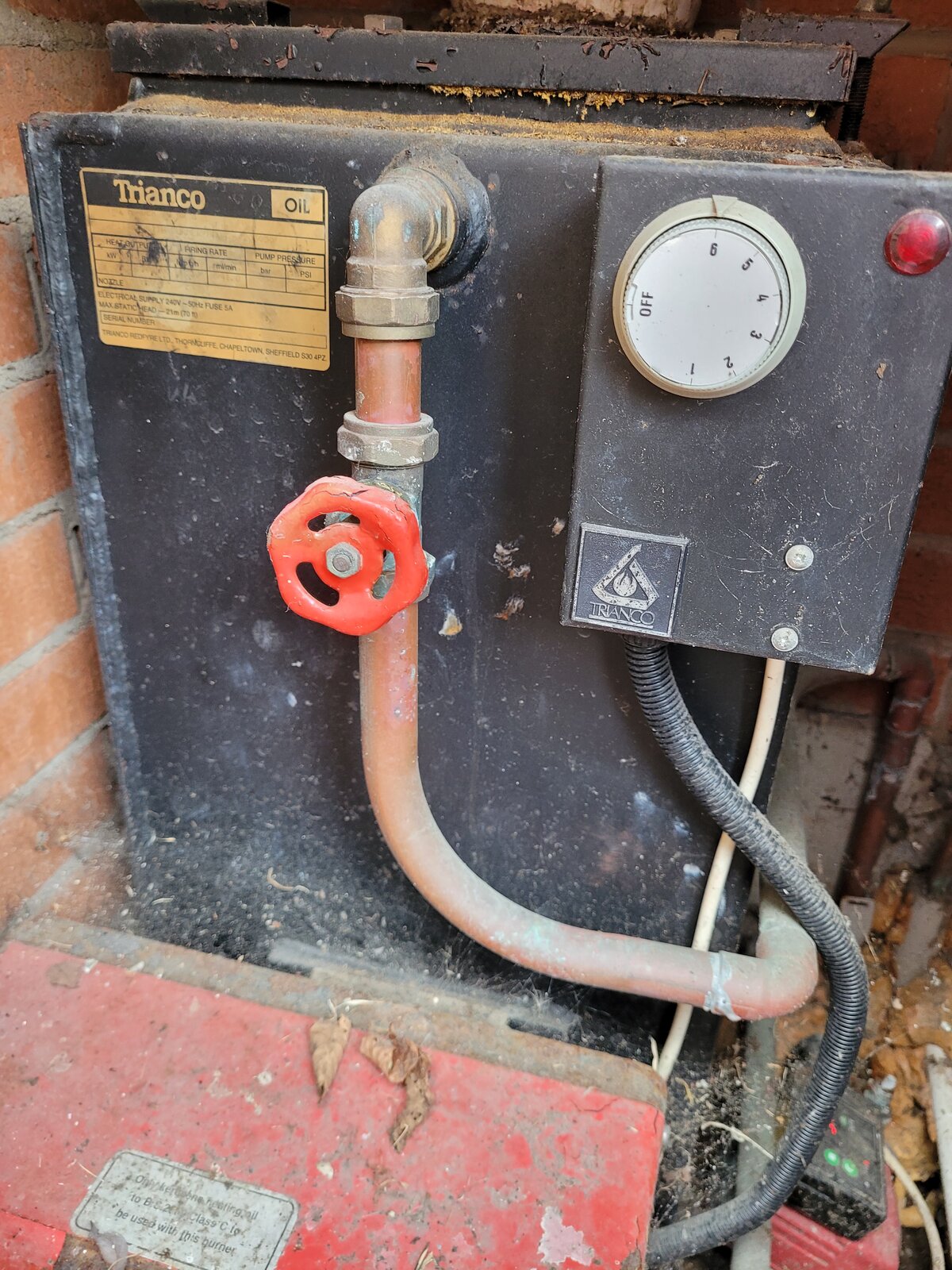

Looking at the picture of the boiler installation, I doubt whether there are any motorised valves, and if it does hot water, then it will be gravity, with a pump on the CH circuit. Like I said earlier, get some professional advice from someone who can identify what you have got.
I was talking briefly to a plumber yesterday. He reckons I need to wire the receiver into the existing time clock. But I can't get into the house yet to see if that's the case
