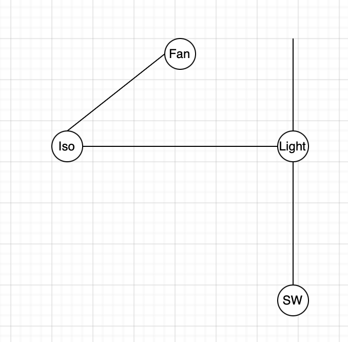

Im refitting my bathroom at the moment and getting electrics sorted before the ceilings done.
Current fan and isolator are as pictured.
Plan for wiring is as follows;
When I moved in the Isolator lead was gone so can't test it, does this mean it's connected to switch live currently?
Can I remove the isolator ? Is it needed on regs? I read it's on Isolator for maintenance so won't be a problem tbh for me.

Which lead do you mean and what do you mean by 'gone'?
Plus we would need to see which wire is connected to what; not just a cable between two accessories.
Yes, you can remove it. It is not a regulation requirement.
It looks to me from your drawing that the isolator can be used to switch thhe fan independantly, but can't say for certain without a proper circuit.
You may be able to short out the isolator but it depends whether you have a timer model or not.

It is not a requirement, but is sensible to have one fitted. If the fan has a built-in timer, then a three pole isolator would be needed, to isolate neutral, live, and switched live.
I mean the Isolator cord has gone, it was obviously pulled off.
Come to think of this, in the other bathrooms I've got the fan coming on when I don't have the isolator on.
The Fan's don't have an overrun they are from 1998 lol. I'd probably want the fans being controlled in some way when they go in as I wouldn't want it on continuously when in the bath for example.
So if you don't want a fan running when your in the bathroom and you take away any switches specifically for the fan, how do you propose to run the fan.
The idea of a fan is to remove moisture from the air before it forms as condensation on the cooler surfaces (Walls. windows etc) so should be running during the bath/shower etc then run on for a time afterwards until the air is dry.

Can of worms on this, I'm wondering whether it might be better to just move the light switch and isolator to a switch outside the room near the door and then do an inline fan. The original build of the property only ever had a bath not a shower.
The rooms 1.7m x 2.7m so not big though so I'd worry about noise tbh.
Sorry, only experienced noisy fans over the years.
You can get very good quiet ones now, with ball-bearing motors on rubber mounts, and redesigned fan blades. Also online fans by the same naker, but more powerful and very suitable for a steamy bathroom.
You are allowed to have switches inside a bathroom, provided they are away from any fixed bath or shower.
