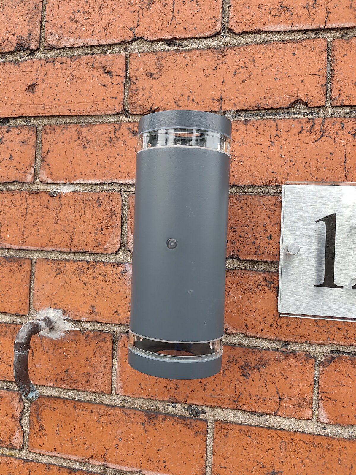

The lights were working perfectly for over a year , then noticed that one of them wasn't working , so turned off at the mains switch , the light came back to life and was working fine for maybe 30-40 + minutes , then back to the same..... only one working , and idea what this is and how to fix as I can't seem to find the same light anywhere.

I have a light either side of the door , one works one won't come on even if it's pitch black unless I turn mains off then on
Replace the photo cell in light that doesn't work or if that isn't possible override them both (disconnect inside the lights) and fit a new photocell to control both.
Any idea where I can get new photocell
This is the light

Of course, you did not state the Brand/Model of the Dusk to Dawn sensor concerned.
However, such devices utilize some type of Photo-Sensor,
which usually Fail/Deteriorate - within about ten years.
If the Photo-Senser is integrated within the device,
the entire device needs to be replaced.
One should never utilize a device with an integrated Photo-Sensor - because of this reason.
Always have a separate Photo-Sensor to control any such device.
In that way,
when the Photo-Sensor fails (as it will) it is necessary only to replace IT.
