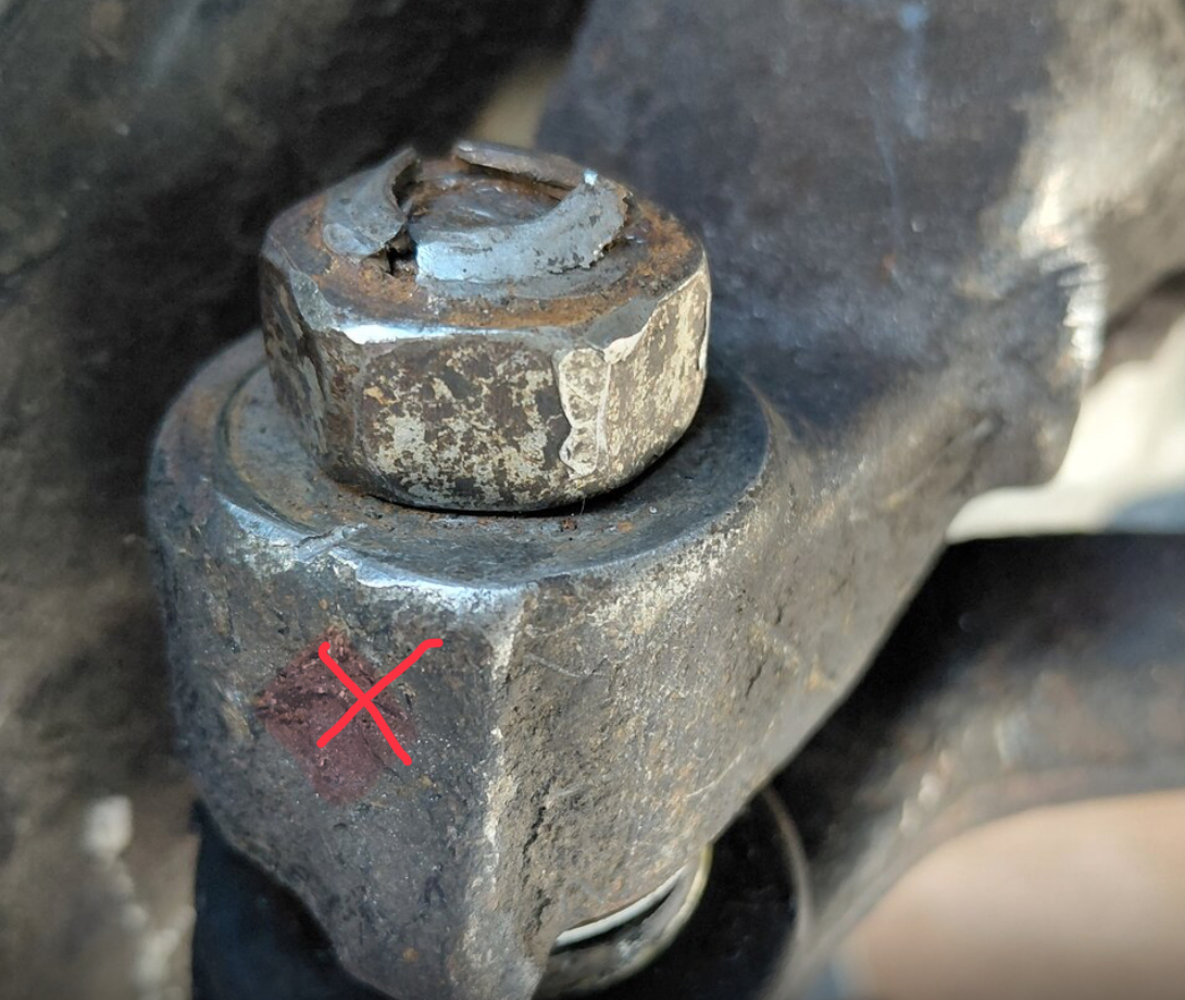

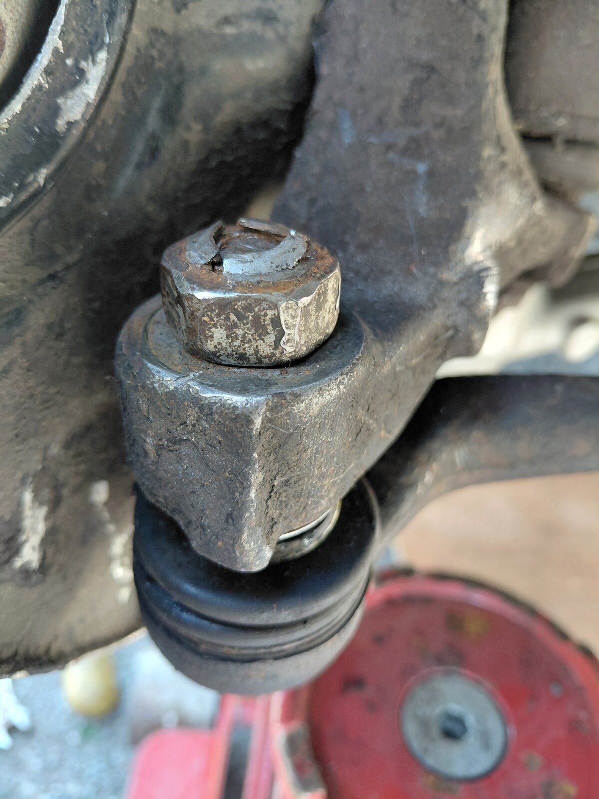

I've cut some threads off of the track rod end cos couldnt get nut on .. will it pass MOT like this ? Pic included
6 Jul 2025
56

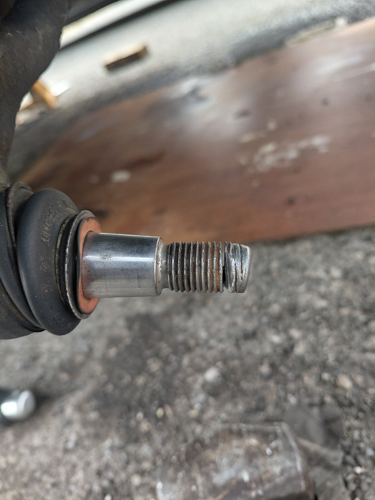

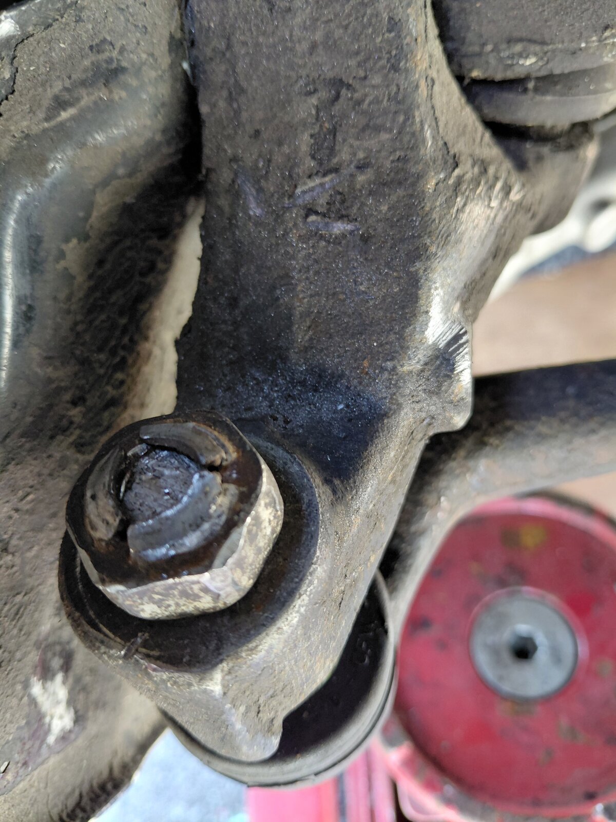

I couldnt get the nut back onto the track rod end cos I damaged the top of it when using a hammer to hit it outta the hub.. so I used a hacksaw and cut off a few threads that was damaged and was able to get the nut to go back on .
It doesn't look great but still.. its securing the track rod end solidly so i dont think it will be an issue .
Do you think it will be an issue when the car goes for the MOT on tuesday or should it be fine ?

It looks like you knocked the crap out the nut too. New trackrod ends and nylocs required for you and other road users safety. With the correct tools & technique there's no need for that damage.

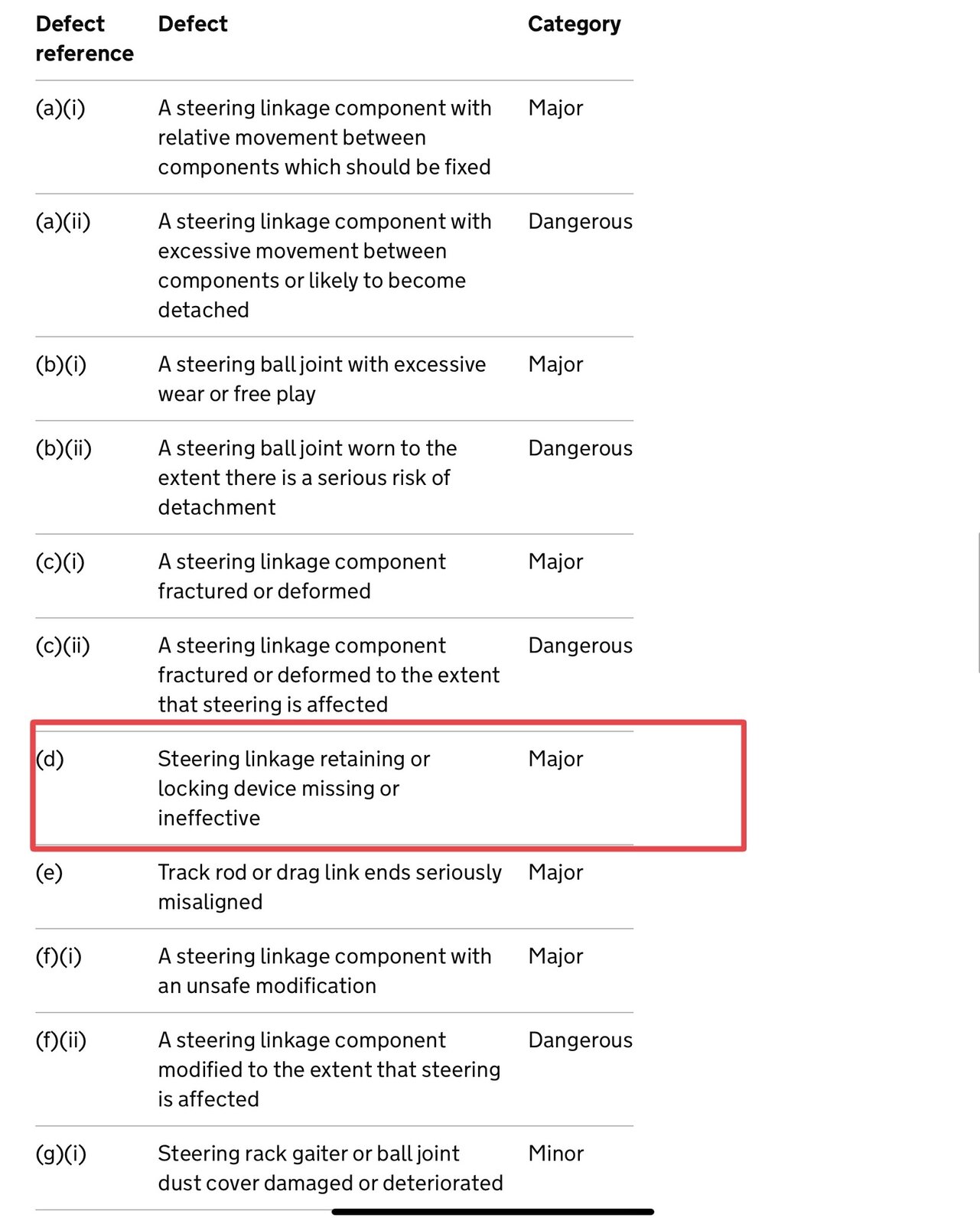

I think you will be wasting the MOT testing fee. There must be reason why the threaded section is longer.

Until it unscrews itself and falls off. That is a nyloc nut, they are intended for single use, and locking onto a thread which passes fully through the nut, so it can properly grip.
How much does a track-rod end cost, £10, £20, and for that you are willing to put your life and that of others at risk?
The correct way to release a track-rod end, is to partially undo the nut, then taking a pair of hammer, one as an anvil, the other to hit the side of the track-rod socket, to free it.

You asked the question,the answer is it it is highly dangerous and that nut will fall off eventually. You quite obviously do not like that answer and will probably go ahead with it as it is anyway. Good luck with that , hopefully it wont kill someone else.
Either of my family's two testers would take one look at that and issue a failure notice. This would be done to protect other road users and not just yourself. Having seen that steering, I do have to ask myself what the rest of the vehicle is like.
