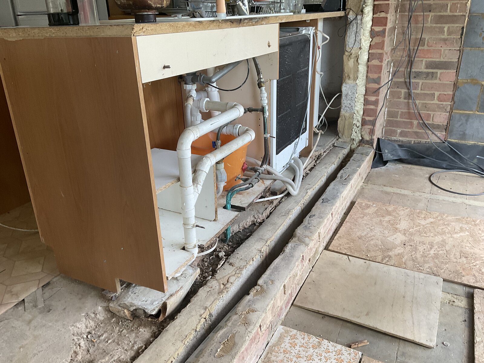

Hi,
The existing waste setup in the kitchen is a bit unusual! The waste enters a drain via a hopper, inside the house, which then goes all the way under the house to a manhole at the front.

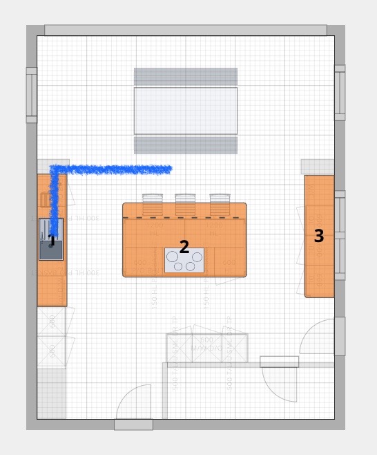

I want to move the kitchen sink and connect to that existing drain. The new sink will be against the side wall. It's not an option to just run a new waste out the back of the wall where the new sink will go.

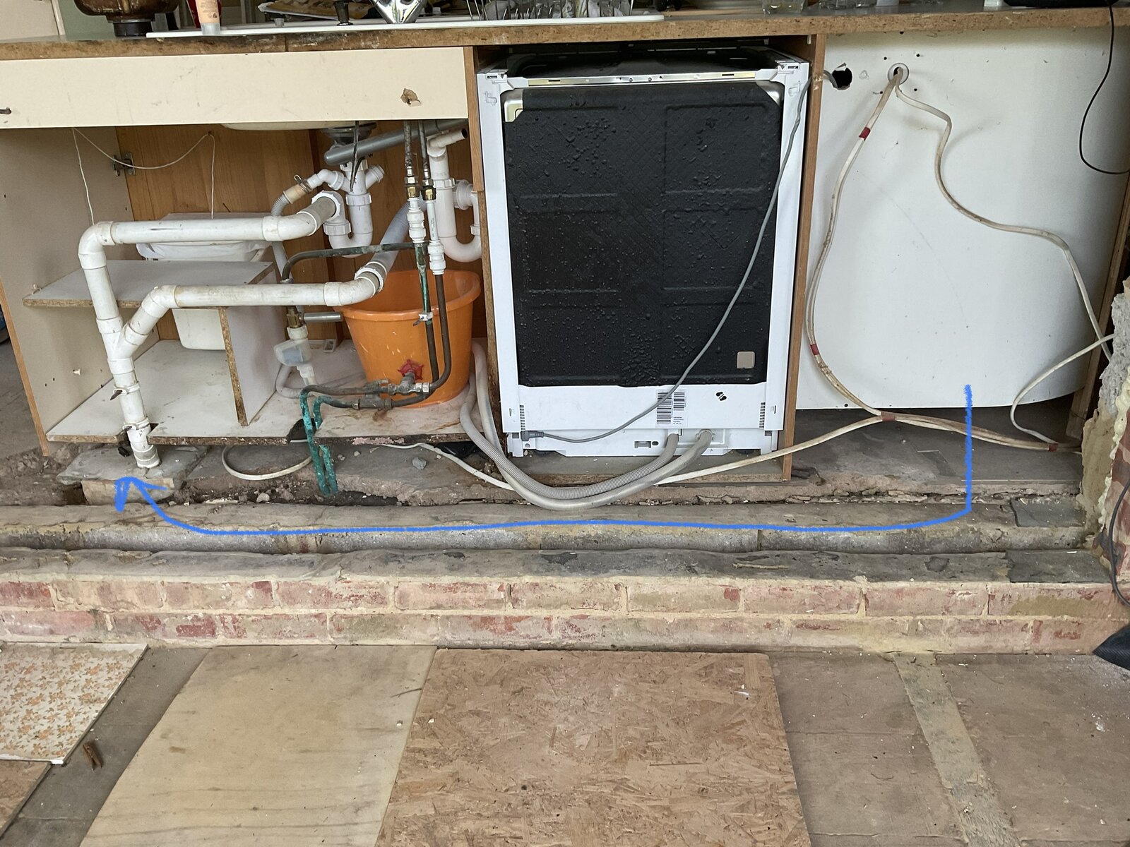

I was thinking of running a new waste from the sink and through the old cavity as shown in blue below then somehow connecting to that old clay pipe. Is that possible?

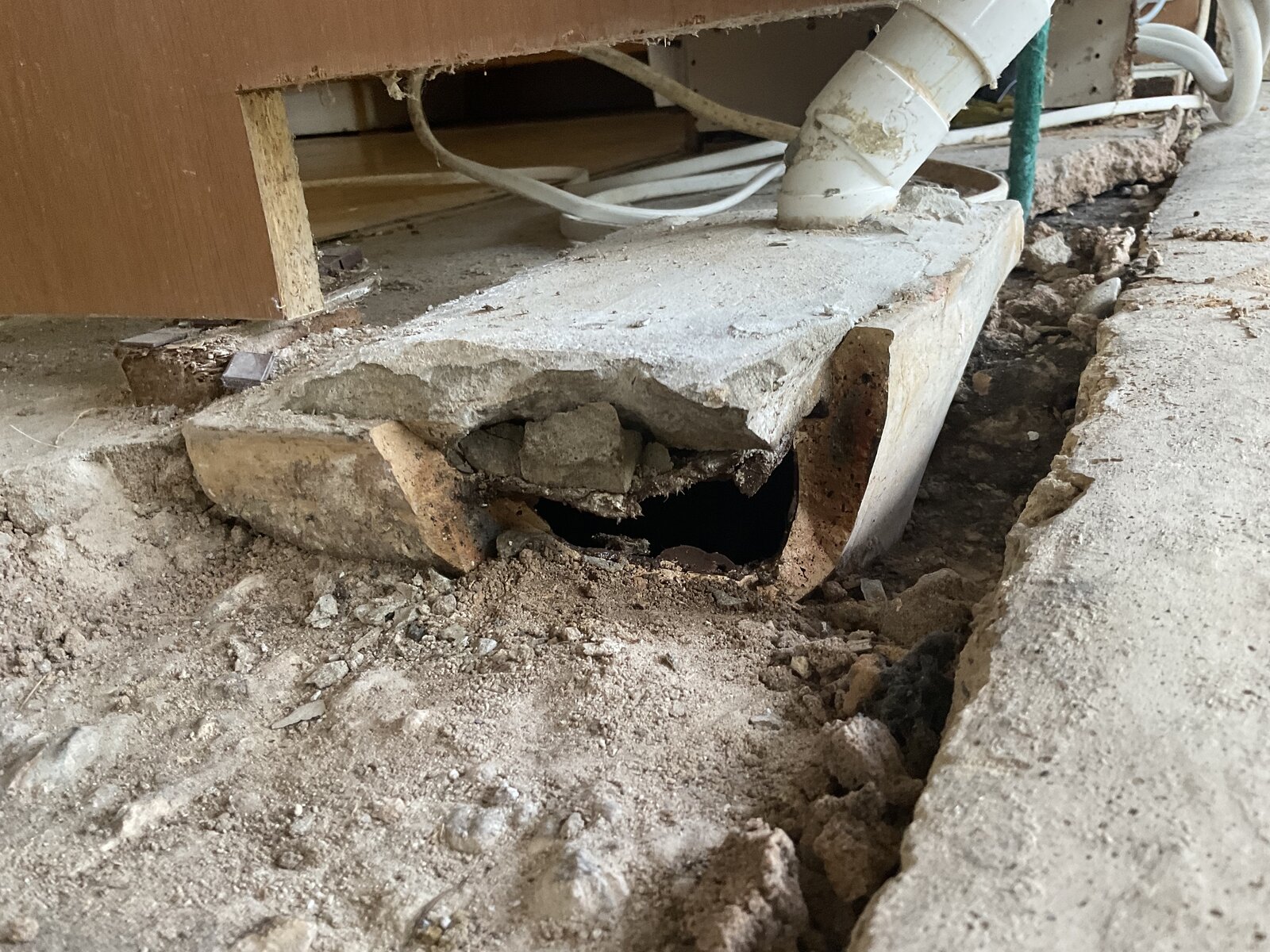

As you say I'll dig down and see. How about running the new waste in that cavity? -It's about 70mm wide so was thinking 50mm waste pipe, long sweep bends.
Best option would be, as said previously, dig down and expose the pipework under the hopper. (It could even have a trap under there!) Once exposed, you should be able to carefully dismantle the old stuff, it looks like HepSleve, (note which is slightly different sizing to the current Hepworth Clayware, Supersleve.) Once back to a suitable point, fit a suitable collar to get you from Hepsleve to Plastic, come back up with 110mm plastic to a suitable height, fit a Boss, and run your 50mm from there under the screed, I really wouldn't be putting in the cavity!

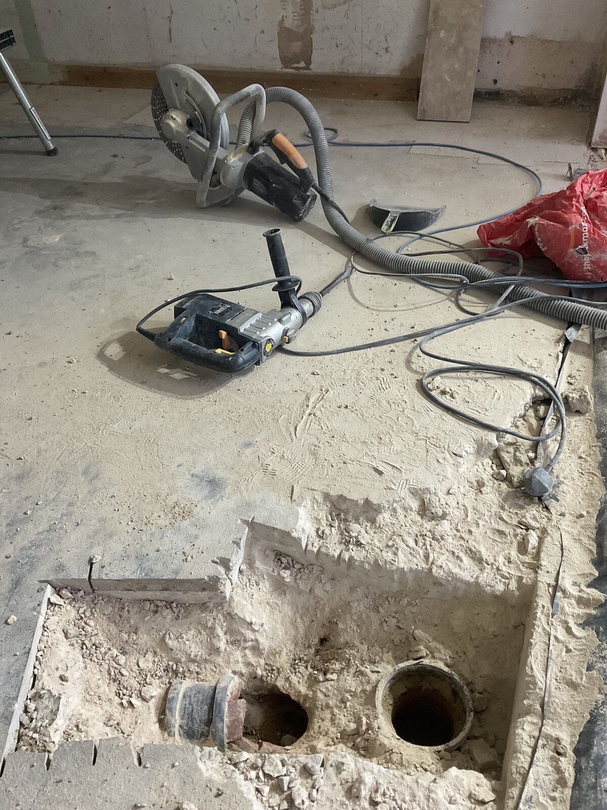

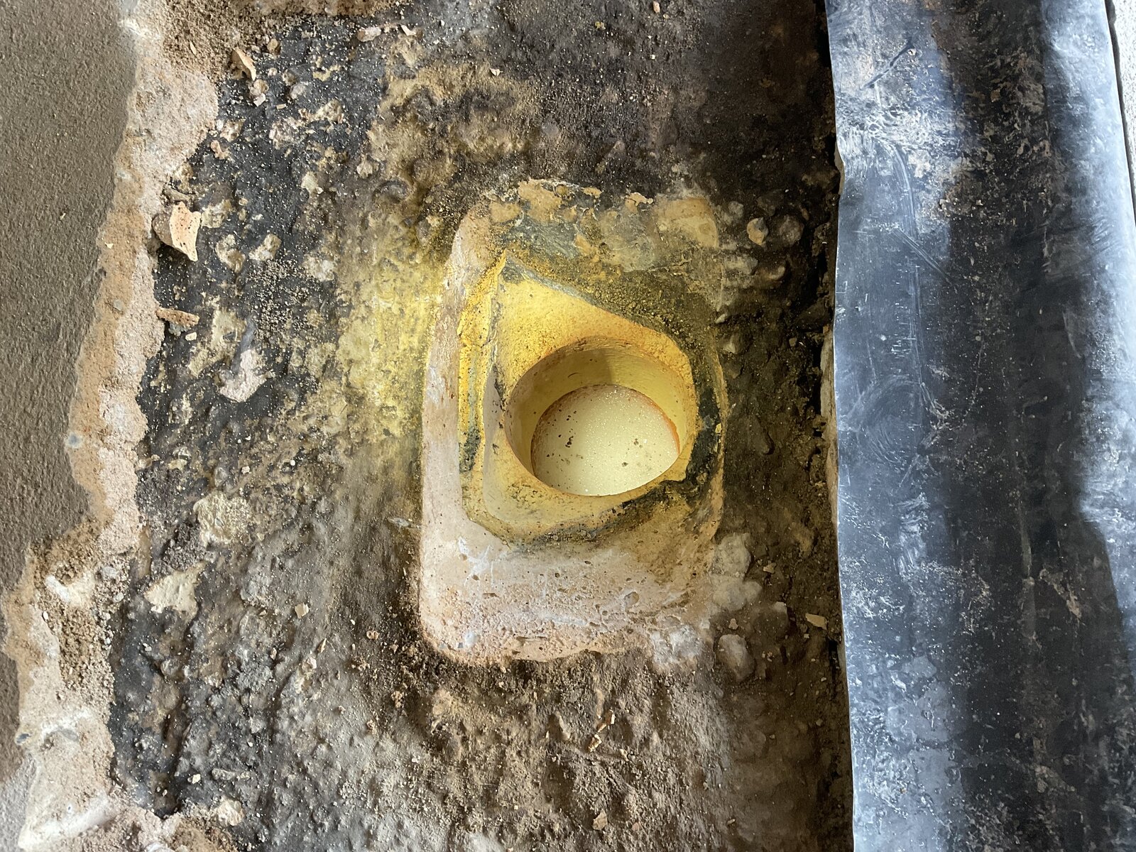

Finally got to round to doing this.
Here is what it looks like. You were right Hugh Jaleak, there is a trap/u-bend under there. I've just put my hand in there to clear it out. Nice! The start of the clay pipe is level with the foam (bleach) in the picture. It's about 190mm below the floor level.

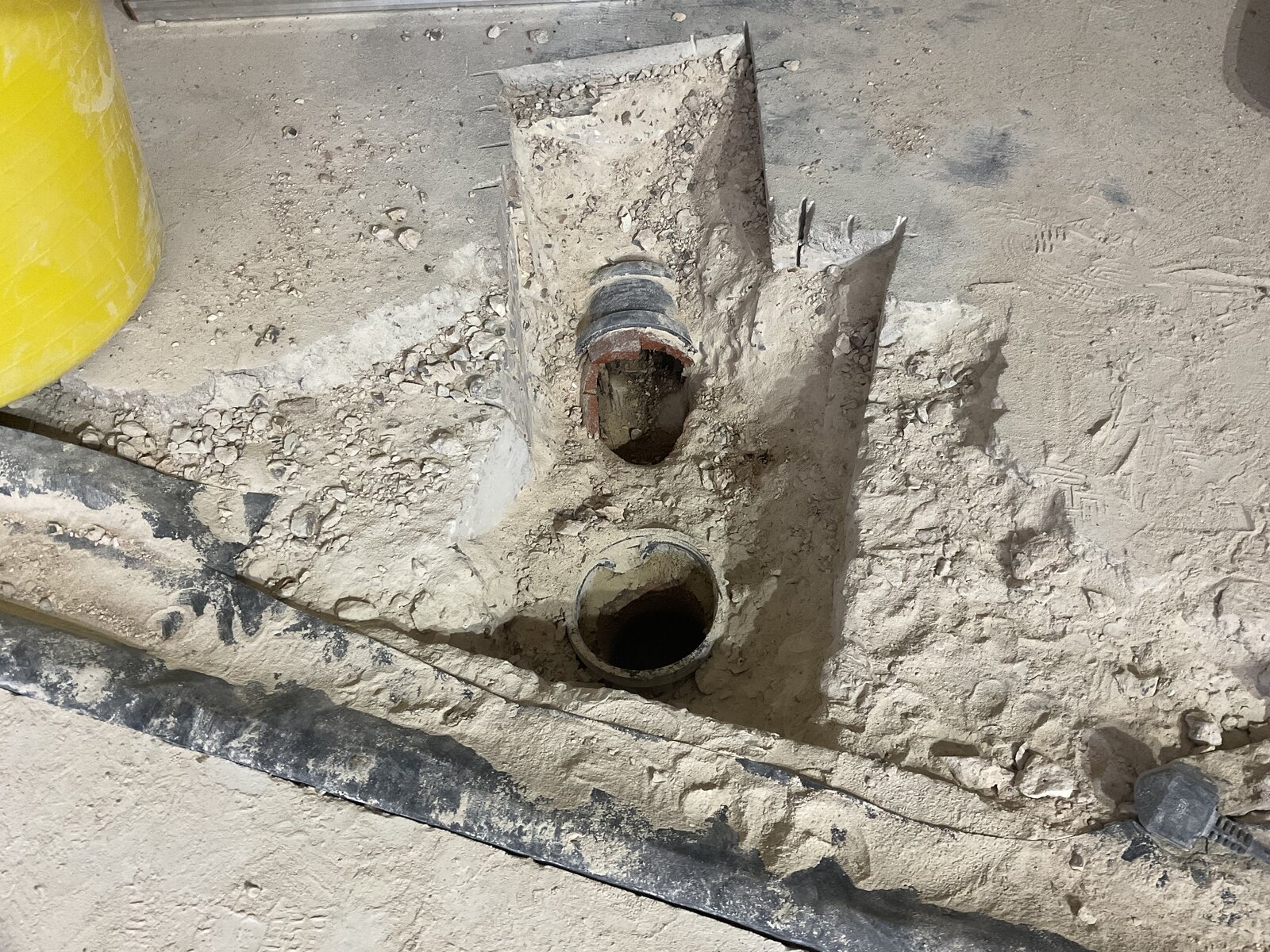

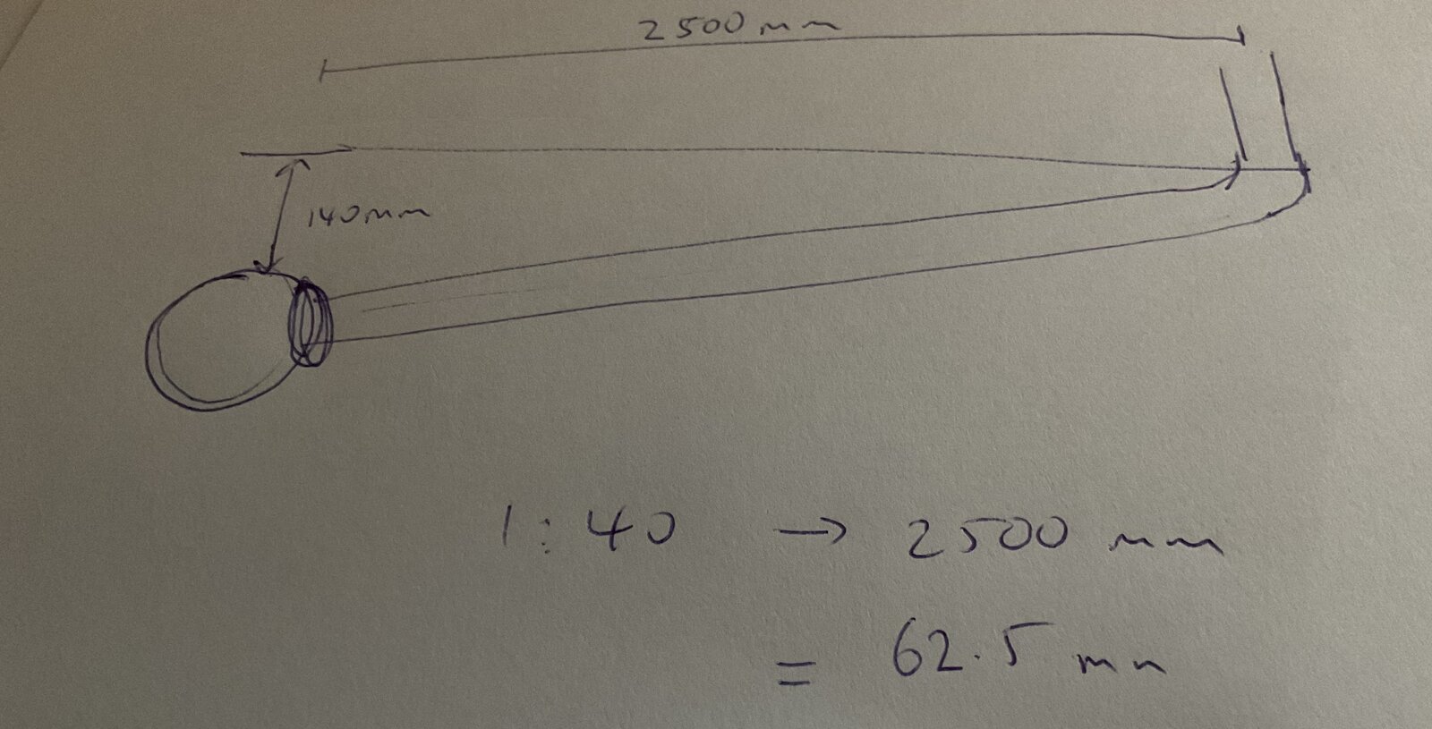

After spending a few hours getting dusty here is what I've found. The trap is joined with Hepworth sleeve to a clay pipe that runs horizontally (with a fall) under the house.
Do I remove that sleeve and fit a flexible adapter like this:
I can't see how I'm going to get some vertical pipe in there so instead do I fit a stub of pipe horizontally with an end cap. Then put a boss on to feed the waste pipe like I've drawn below?
