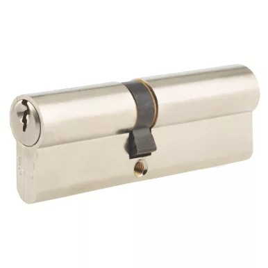

This is a Eurocylinder.

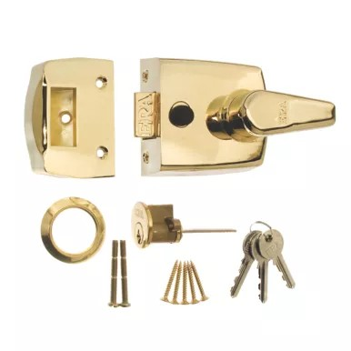

This is a Nightlatch cylinder

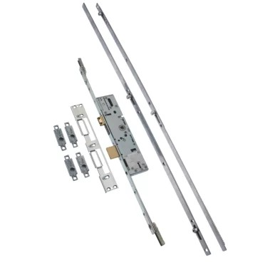

This is a multipoint mechanism

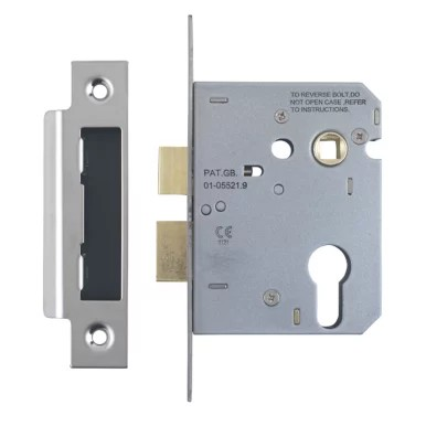

This is a lock case (without cylinder)

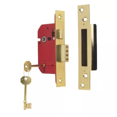

This is actually a latch, though some people call it a lock

OK thanks, it's a eurocylinder (Well 2 in fact). How does this change things, though?
It means you only have to buy, and change, a couple of cylinders, which is much cheaper, easier and quicker than changing the locks.

My personal preference is for lever locks, to the British Standard, than which you will find none better, but these can also have the levers changed at modest cost
