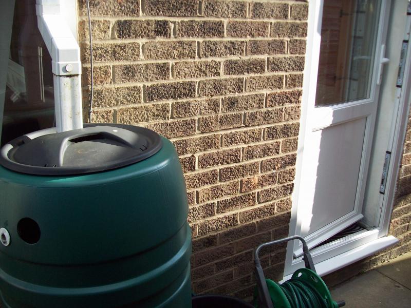

Hello,
I have quite a large conservatory that has the water going to a big water butt. Obviously, this fills pretty quickly when there is a lot of heavy rain and the continual emptying is getting me down (and my back!). I want to link the overflow from the water butt to the existing downpipe of the house. So, if we are on holiday or something we don't have to worry about the rain overflowing the water butt and flooding the side of the house and doing who knows what damage to the foundations?? :confused: :eek: But, equally, if we keep the water butt we can then pick and choose when to empty it, if we want to use the water for the garden or just can't be boterhed emptying it for a week or two!
So, the job I want doing would be to pull up the slabs by the side of the house (a distance of 20 feet) and dig down to put in the piping required and then to join up to the existing down pipe, and return slabs. It is all in one direction, no going around corners etc.
Does this sound like a plausible idea? If so, the next question, is how big a job is this and how much could I expect to be forking out?
Thanks to anyone who can find time to reply.
Duncan

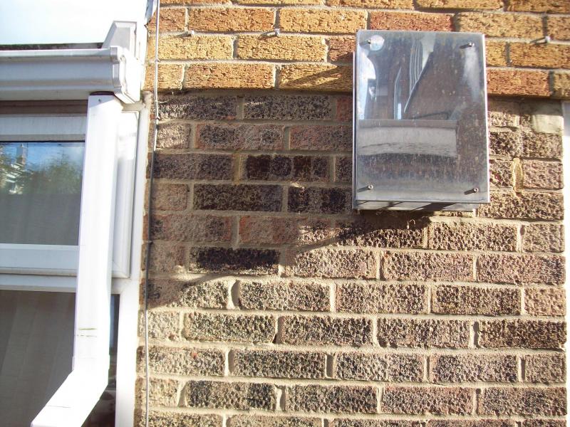

In the third picture, is that a soil pipe or rwp? Do you know if you've got separate foul and surface water sewers or are they combined?
Hello,
That's the pipe that takes the water from the roof. So, I'm pretty sure that there is a seperate sewer for foul and sewer, as the foul one is (I think) at the back of the house.
I tried to take the pictures in sequence, to show the water butt, then how the door and the boiler vent are in the way of potential piping to join up to the roof down pipe. The distance from the butt to the pipe on the third photo is 20 foot. The pipe that comes down in the 1st photo goes into the water butt.
