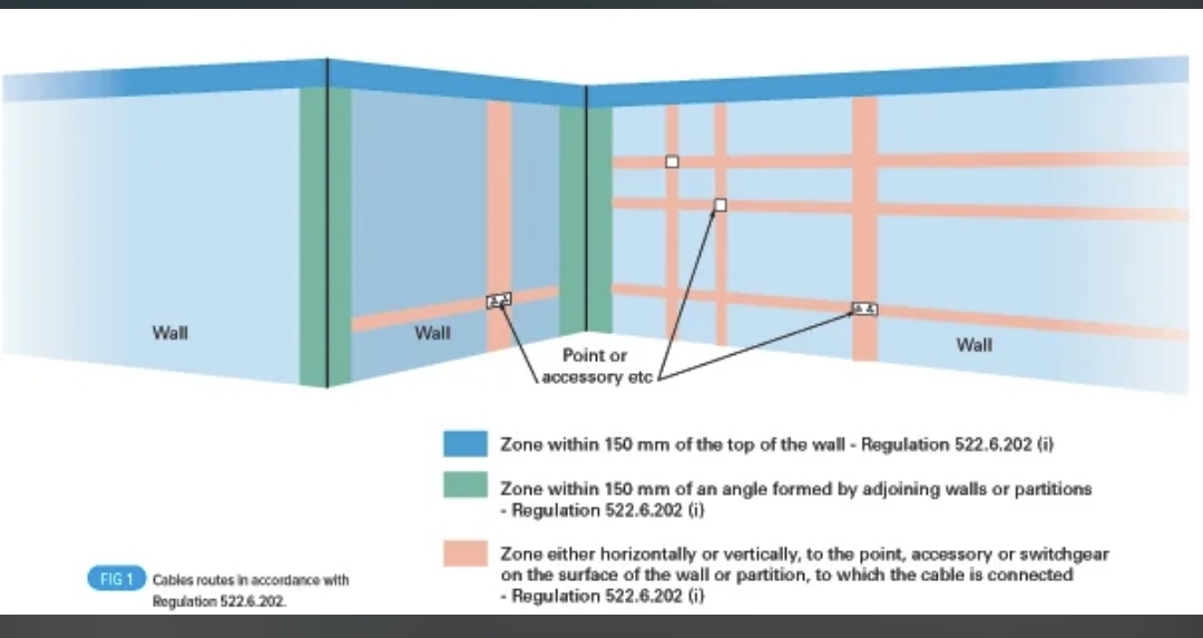

If the existing cables come from above or below to the socket then you can't spur to the left and cover over the connections, the cables need to be in the correct zones.
You could join them and fit a blank plate? I know you probably don't want that.

I don't mind fitting a blanking plate actually, it's a column radiator so won't see much behind it, amd the wall will be white anyway.
Regarding zones I can run up the wall, across and then down again. A bit of the ceiling is down anyway near the area I want to move it to.

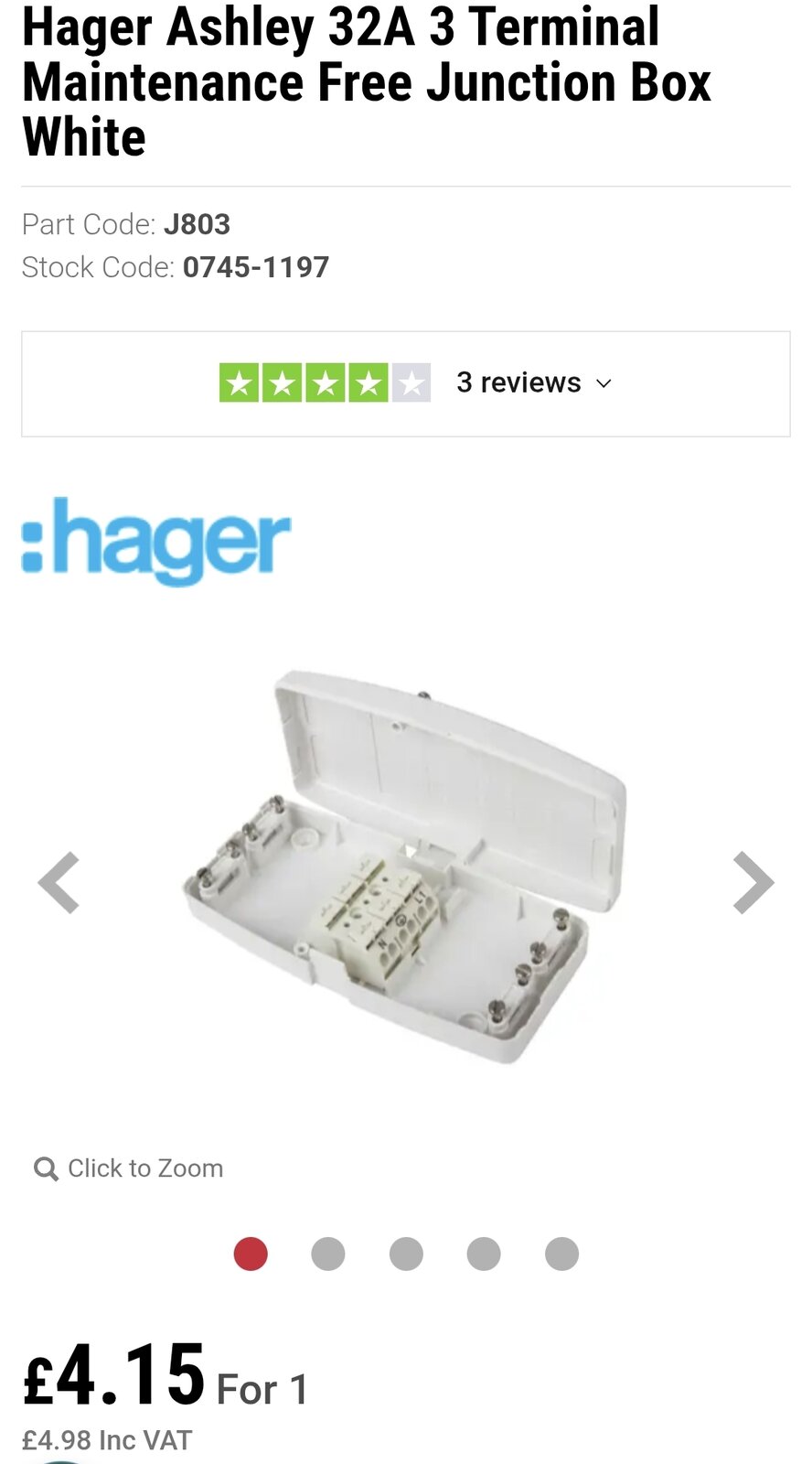

So really looking for recommendations for the jb itself that can fit inside a blanked off metal backbox?
If the ceiling is down pull the cables up and jb there or even better replace the 2 legs altogether, 1 might be long enough to reach the new socket position.
These is the best junction box in my opinion.
Actually that is a great shout about pulling the cables - removes them completely out of the way of the rad.
Thanks for the suggestion of the JB - ordered!

I don't believe that is OK because your blanking plate will not be visible and so there won't be a safe zone above it.
To create a zone, the wiring has to be connected to the accessory. A blank plate has no connections for wiring so doesn't create any zones.
