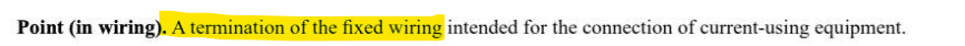

Also - after a socket has been removed and where two cables are connected, would that not still be a 'point'?
But what current-using equipment would be intended to be connected there?
Logic, and syntax, etc say that unless there is fixed wiring which is not intended for the connection of current-using equipment, and that such wiring needs to be differentiated from wiring which is so intended, then "intended for the connection of current-using equipment" applies to the point, not the wiring.
Of course it applies to the 'point'. It is the definition of a 'point'.
Now - what is your point?

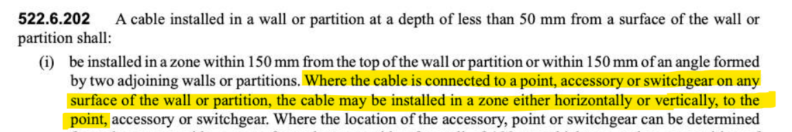

Therefore that regulation 522.6.202 talks about a cable connected to a point which is intended for the connection of current-using equipment.
As you have just agreed, "intended for the connection of current-using equipment." applies to the point. The point must be intended for the connection of current-using equipment.
So after the socket has been removed, what current-using equipment is intended to be connected there? Because if there is none, then by the definition of "Point (in wiring)" you quoted, it's not a "Point".
Bear in mind what I quoted is THE definition of a POINT.
The regulation:

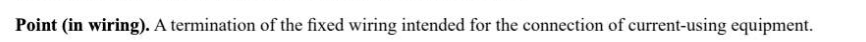

I looked at the definition you quoted, and thought "Why on earth is he asking that question? It's as clear as day what the definition says, and that is that a 'point' is a termination intended to connect current-using equipment."
And you agreed. When I commented
you agreed that is is the point which has to be intended for the connection of current-using equipment.
So what current-using equipment is intended to be connected to a junction box behind a blanking plate?
