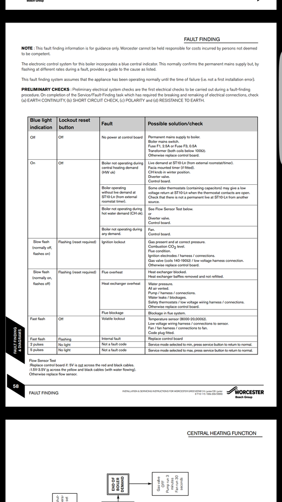

Starting from the beginning. This is a house I've bought, not not lived in.
Boiler is a Worcester Junior 28i. Fitted in 2013 by British Gas.
I've stripped the bathroom. Closed all upstairs rad valves and lock shields. Removed bathroom radiator, moved pipes to another wall, and capped them.
I've tested all pipework wet, with no leaks.
Boiler has been filled to a bit over 1 bar. Bled all rads, bled boiler via tube at the top.
After a few restarts, the boiler fired. Think the issues were to do with the rc plus not demanding CH. Never used it, so took a minute to figure it out.
After 5-10 mins, rads were no longer stone cold. But didn't get warm, and no HW after a minute or so of the tap running.
The boiler then faulted, with the blue light being on, and flashing off. And the red light flashing.
After trying a restart, the fan spins up pretty fast, then speeds up even more, then it faults again.

if you read the manuals you need to explain this a little
Sorry missed your reply somehow.
That's how the manual describes the fault lights.
As for bleeding, no air came out the boiler. I bled about 500 ml of water, no air.

as from your table , is blue light normally on , flashing fast , how many pulses , if you want to fix something you've got to RTFM :) .

AGAS, the blue light is on flashes off. Slowly. The red light is flashing slowly. Once per second roughly.
Manual says Flue overheat, Heat exchanger overheat, flue blockage.
It hasn't been on long enough to overheat anything?
