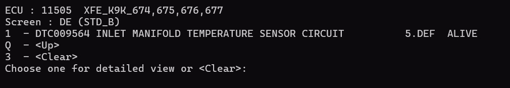

My daughter has a 2017 Clio Diesel Mk4 1.5 Dci 90hp and it has a fault that's proving a git to get rid of:
on TORQUE its P0096 DTC Error
I have changed the MAP (pressure sensor) and the MAF (air flow with combined IAT temperature) with new parts and cleared the DTC error code successfully and every time the next day (not immediately) when the engine started the Messages on the dash come back with the yellow spanner light and yellow engine warning light. Engine driving normally (not limp mode) and appear no loss of power.
when I clear the DTC errors all warning lights extinguish and messages got off the speedo dash window and 'no memorized messages' in the dash.
Next day engine is started and warning lights back on, messages on the dash about Injection warning, and same results in diagnostics as in pic above DEF ALIVE.
I am at a loss what to do next or if there is another IAT temperature on the engine that I am missing and cannot see.

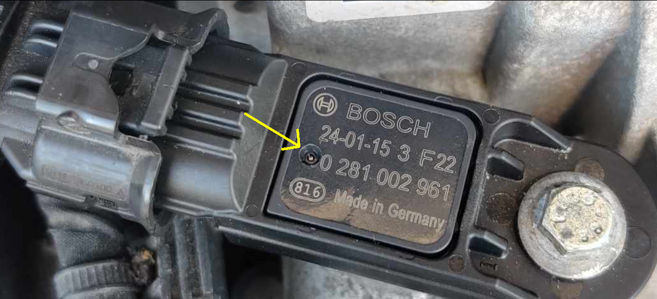

This is the MAP sensor that her Mechanic replaced - to me it looks a bit dodgy with a hole 'drilled' there on the top , .. unless thats how it is supposed to look!
And the part number is BOSCH 0281002961 - so just looks like its a pressure sensor only and no IAT built in

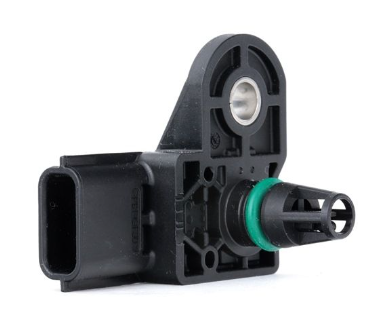

We also bought this IAT Sensor because it was cheap
So some sites said it fitted a Clio 4 1.5Dci .. and then other sites said that it would not fit the Clio4 so I am confused and wondering if this is the IAT2 that P0096 is supposed to refer to. I have had a look along the air intake from the air filter box along the inlet pipe across the engine and cannot see any sensor that looks like this. - I have a Haynes manual (petrol/diesel mk4 Clio) as well and cannot see anything about it in there too or any of the IAT sensors
finding it most confusing on this engine.

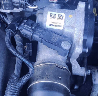

Hello again all , just an update my daughter took the car into the Renault Main Dealer today and they changed this sensor:
Part: 223653148R
Lights and messages are off now on the dash, I hope now they stay off - I never did find the location of this sensor in the end
Andy.
Yep, that's a MAP sensor right enough - plugged into the inlet manifold somewhere.
You would think that the inside of the inlet manifold would be clean - but courtesy of EGR it most certainly isn't!
There's no reason for the fault to come back, and thanks for the update!

Its strange that its a MAP (pressure) sensor as well if it is, because it has a Temp sensor thing in it, and there is already a MAP there on the top of the engine - this one:
