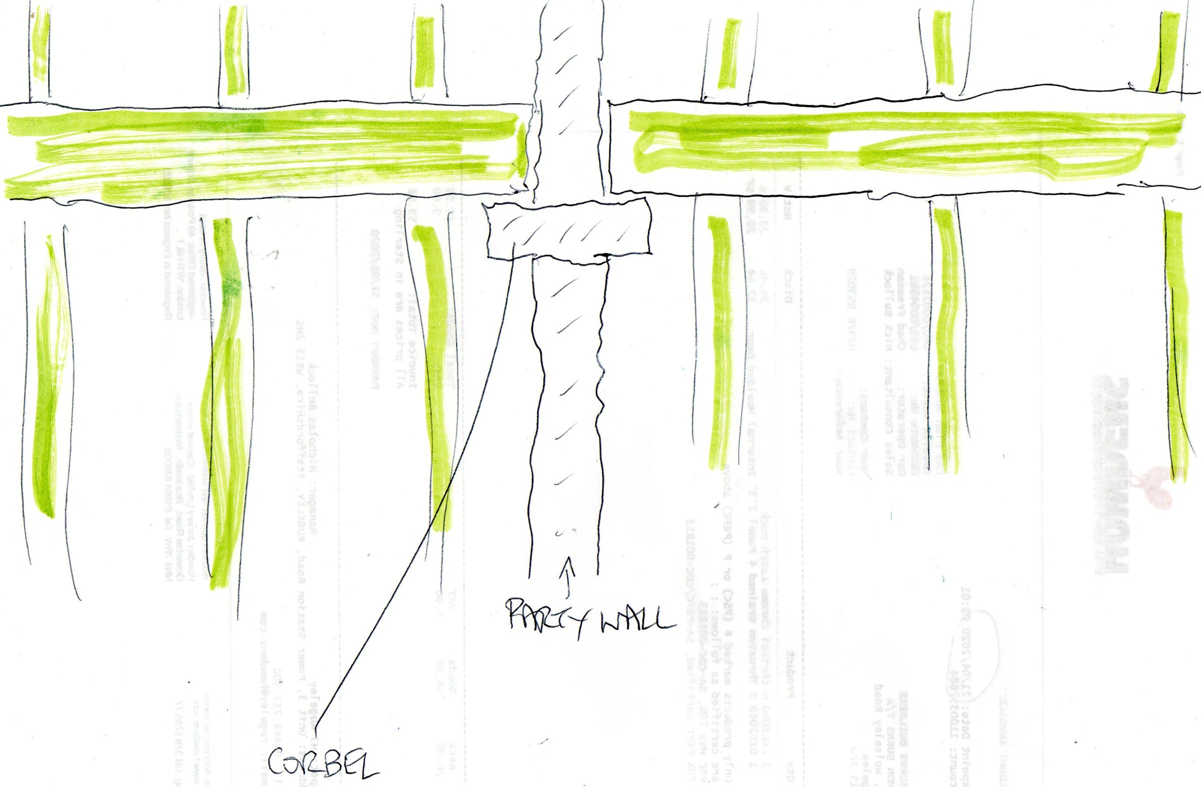

Have you given thought to the other end of the brick doing a mirror image of what we see, on the neighbours side? Bonkers - yes, but so is resting a purlin on a corbeled brick.
I'm concerned that this may be the scenario....

This possible scenario bothers me more regards remedial work and the party wall..
That's the thing - I don't think the purlin has. And I would want that purlin up where he belongs, i.e. up tight against the rafters and in his original position.
What would be the concern for the scenario in your diagram? Would it be better to rest the purlin on a metal bracket or plate which is bolted to the brickwork?
