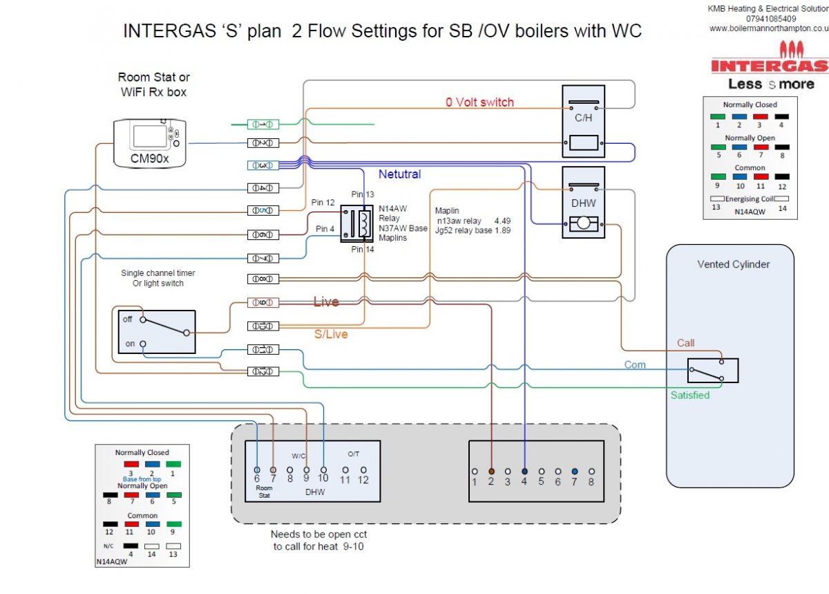

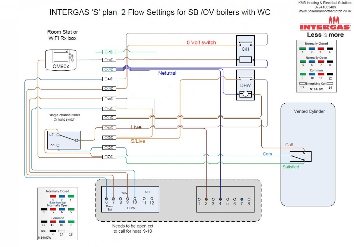

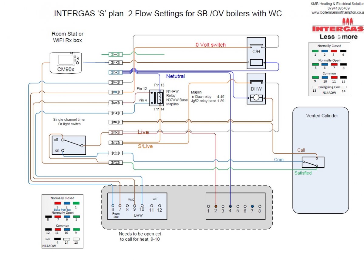

In which case, can i use orange/grey on my hot water valve to connect to the DHW pins on my intergas? (leaving aside the CH side for now as im still working on the drawings for that side).
My plan is as follows:
Currently, HW, UFH and RAD zones are wired as splan +.
Im looking to use the drawings mentioned earlier for splan to connect as follows:
Live in to programmer for HW. On from programmer to Cylinder stat. On from Cylinder Stat to live on HW zone valve, (and the bit im questioning is orange/grey to pins for HW on boiler - 9 and 10).
off from programmer for HW to in for heating programmers (both will wire the same in parallel). on from heating programmers to common on thermostats, and to live on Heating zone valves. Orange/grey to the CH pins on boiler in parallel - 6 and 7)
the off from cylinder stat will feed in to the CH programmer to allow for HW programmer on, but the stat not to want.
So i cant use the orange/grey pairs as voltage free?
There is an external pump for the UFH manifold only, and is controlled by the manifold board.
No other external items that need power once boiler is running.
In a sense, other then ive removed the relay, whats the difference between this:
and this:

By taking the relay out your not using weather comp I assume ? if that's the case why not wire everything up using 240v on the zone valve switches ?
The aim is to use weather comp, i don't see what the difference is with the relay in place and not. From the original diagram, the grey and orange energise the relay, which connects the two pins... So why not use the grey/orange to connect the pins and ensure that the valve is open when firing up the boiler?
Taking into account that the original drawing is doing exactly that for checking side?
