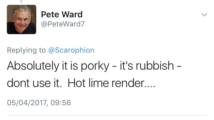

You may have come across Mr Pete Ward, who is very much against anything other than traditional materials (there are even links to his articles in this forum's wiki!)
But this is just one view and I was wondering what other plasterers think.
