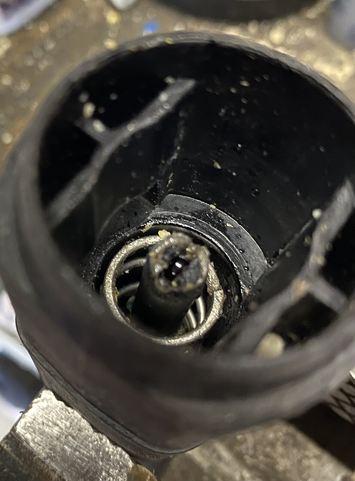

This is a Karcher K series lance where you attach various attachments.
Anyone know if the Male connecter in center can be removed. Found the Yellow bits from attachments being left after removal of the attachments.
Yet if the attachments are fitted to an old lance of a old small Karcher, no issues.
Tried to remove the Male bit in photo to rub it down to fit easier
For what ever reason despite greasing with silicone grease etc, the yellow bits are a tight fit and get left behind when disconnecting.
Mine is a hard push in & twist with alot of effort. Yet on a old smaller lance, they fit with no issues..
Thanks already looked here.
The photo is showing the end of the lance/handgun where the attachments fit.
The male bit in the centre is what the attachments fit over and the yellow bit from the attachment is left behind, where the fitting between the male part and yellow bit are too tight.
Asking if the male bit can or suppose to be removable, so it can be rubbed down for an easier fit between the two.
Thanks, yes in principal.
Although I dont have any leaks etc.
Its just that the yellow bit is a tight fit on the male bit in the centre of the lance/handgun.
This male bit has a slot in its head ‘in photo’, but its soft a plastic for a large screwdriver to move it, if its suppose to move/be removed.
I think my option is going to be having to ream out the yellow bits on all my attachments for a easy fit like I had with a old lance/handgun.

Update…
Problem solved.
Used a 8.5mm drill and slowly drilled the yellow bits in the attachments using a cordless drill controlling the speed.

Thanks for posting as I'm having precisely the same issue. I'm struggling to understand how you solved the problem. Did you drill the yellow plug in the dirtbuster lance until it came out?
What is the actual fix that is needed?
Moose1971
Yes I sorted the problem with my lances.
I took out the yellow bit stuck in the lance with long nose pliers and the others still fitted in the various other attachments.
I found a sharp 8.5 drill that was a tight fit in the Yellow piece and basically used the drill as if it was a reamer. Dont use a drill too large as I still managed to hold the yellow bit with my fingers and drill in a slow speed drill or held in some mole grips
