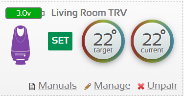

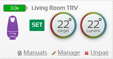

However not convinced that the differential is any set number of °C drop, the TRV gives me current and target, TRV_report.jpg and I think the main thing is they should after a reasonable time be the same, if the lock shield if open too much, it will over shoot, and if closed to much will not reach target temperature, I have set using that philosophy and then tested with no touch thermometer and each radiator has given different results.
So basic the differential thermometer is just a fast method of setting which will need tweaking after anyway, it allows the installer to get a near enough setting which he could not do by trial and error as simply does not have the time.

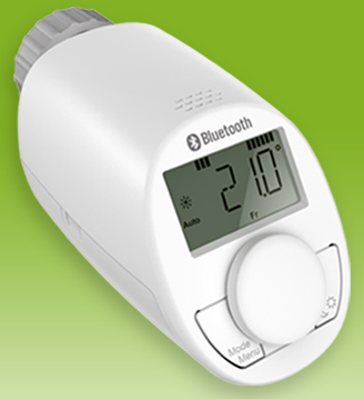

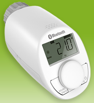

Biggest problem is silly TRV heads with *123456 written on them, or I, II, III, IIII I have a TRV head in my draw, and when writing this I have tried adjusting so it just stops passing air when I blow through it, room at 19.7°C and it stays reasonably static at that, but the setting at which it stops passing air seems to vary between I and III, normally around I or less, it seems rather inaccurate, of course old that's why in my draw, but a new one marked *12345 not much better, again blowing it seems wide open at 3 and closed at 2, so 20°C is some where between 2 and 3, the ones in my mothers old house found around 3.4 = 20°C, which is rather useless when trying to set room temperature, you want the thermostat marked in °C this 61dmtMm13BL.jpg at least gives on a chance of setting correct, if you know set at 20°C then you can adjust the lock shield valve. As long as the wall thermostat does not turn the heating off while adjusting.
