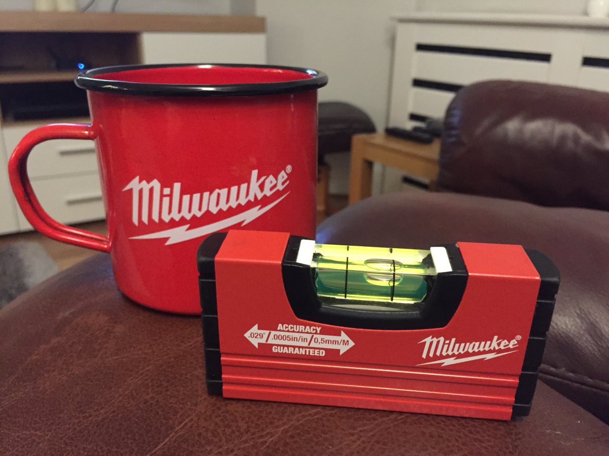

How was the show today?
Andy
I'm saying nothing! I browsed only and didn't buy a thing [darling]!
:whistle:;):D
It was a very enjoyable day and we were in my favourite gastro pub, eating ribeye steaks, cooked in a josper oven, by 4pm! I'm now peckish again and don't know what to cajole the missus into preparing for me, or what else to drink! :confused:
Best freebies of the day...
