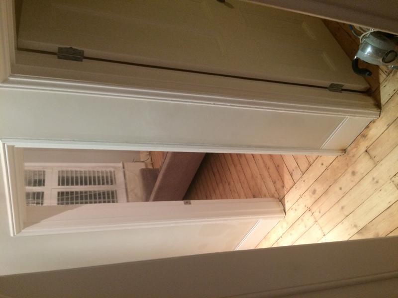

I have just sanded off the varnish from my old pine floorboards. They are now a light colour, which I really like. I love the natural, Scandinavian look.
What would be the best finish to apply to the boards that would keep the natural colour?
I have bought 'Blanchon Wood Floor Oil Environment' in Ultra Matt, after being told that it would achieve this, but I have applied it to a test area and it has made the boards darker/more orange.
Any tips much appreciated!
