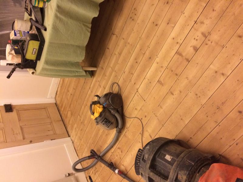

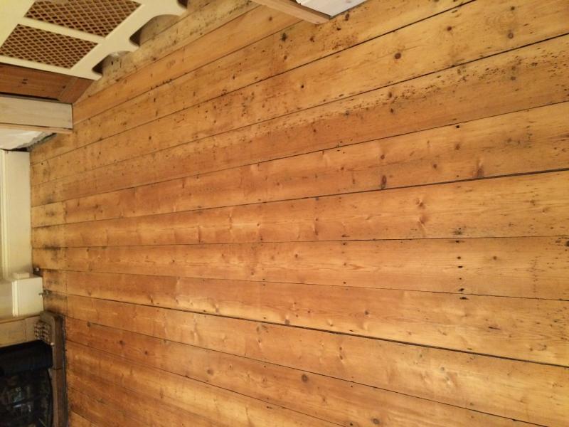

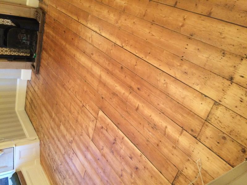

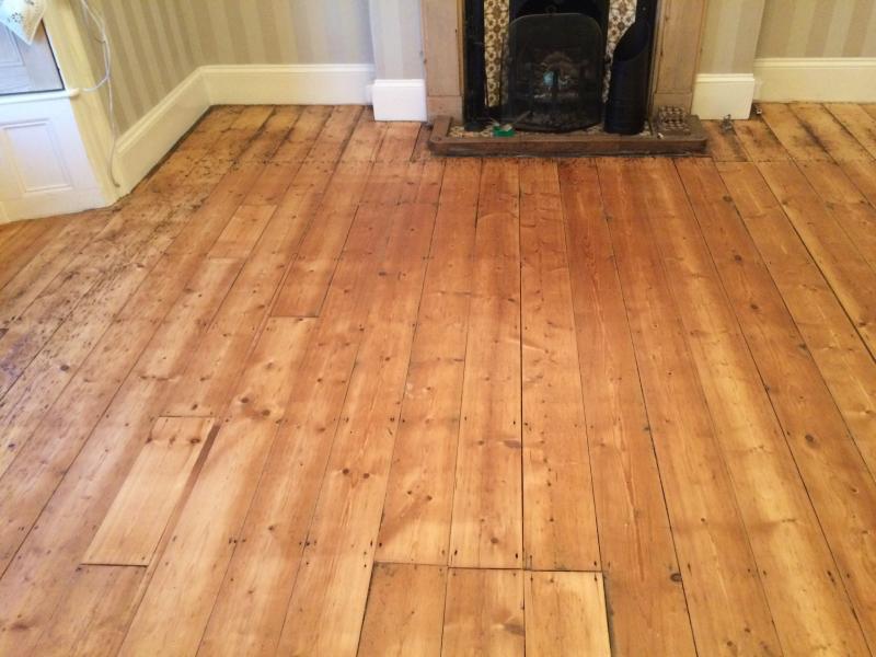

Here are some pictures of the floor now and the product used. All I done after sanding was hoovered the area, hoovered a lot, and then applied the varnish to the bare timber. I used a roller to apply the varnish.
As you can see it looks patchy and orange. The timber was a lovely natural colour prior to the varnish.

Any solvent-based varnish is going to deepen the colour of pine. This will vary depending on the timber. Water-based varnish doesn't do this (but can look plasticky).
I don't see any way to remove this without sanding again fairly deeply, as it will have penetrated the surface. Personally I think your floor looks OK - think "golden" rather than "orange" :-)
Cheers
Richard
Unfortunately you will have to resand.
Dont use the Sadolin.
I would suggest a high quality water based sealant probably Bona Traffic.
You would also need to applly Bona Prime first.
Its expensive but looks great not platickyy at all
Remenber the smoother the floor the less dark it will go especially when using any finsh that has a stain in it.
