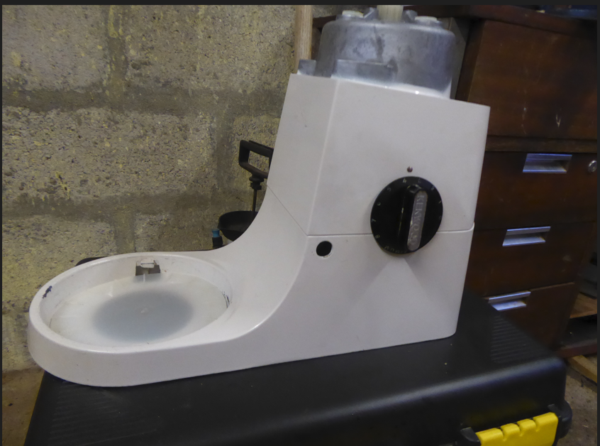

Our Kenwood Chef A901P is in bits waiting for me to fix the speed control circuit. Looking at other bits the flex looks a bit rough so I might replace that. The original is two cord, is there any reason not to replace it with three core and fit the earth to some part of the metal chassis? Just looking at the flex it looks possible that with a bit more damage one of the conductors could have touched the metalwork.

The metal chassis is most definitely touchable, it forms the base where you fit the bowl, the bit that pivots up and holds the motor and the control knob. I would also include the gearbox as that's metal cased and bolts onto that second part, so potentially that might extend to the attachment as well since the connection to the gearbox is metal to metal.

Some quick photos. First the metal chassis, the parts that are exposed and handled when the mixer is fully assembled.

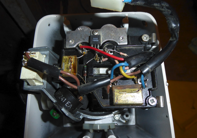

The motor wiring, I must say I don't really understand why this would be "double" insulated but then I don't know how that term is defined. Note the exploded capacitors and cooked resistor by the way.

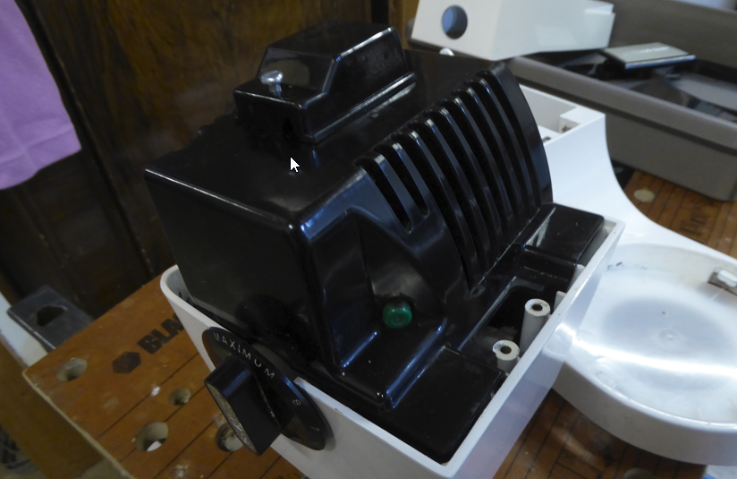

When fully assembled that wiring is covered by a plastic shroud, so when the mixer head is tilted up, those uninsulated leads and soldered connectors aren't finger touchable (is this shroud the "double"?)

I replaced the same circuit in wifeys chef, along with brushes and a general service.
One thing that foxed me for a few mins, after taking it apart, was it wouldn't turn on again.
The screws in your picture 2, have springs under, and tightening them moves the board closet to the motor brushes.
So if it doesn't turn on after your work, try adjusting these.
Essentially yes,
By putting a plastic shroud between the electrical connections and the touchable metal parts, the manufacturer ensures that even if a wire comes loose, it doesn't touch the metal case and cause a dangerous condition.

Essentially yes,
See my second picture, if one of those soldered connections came apart (unlikely I know) then the shroud does nothing to stop the loose wire touching the upper part of the chassis. I think all the shroud achieves is preventing fingers from touching those uninsulated conductors when the mixer is tilted up.
