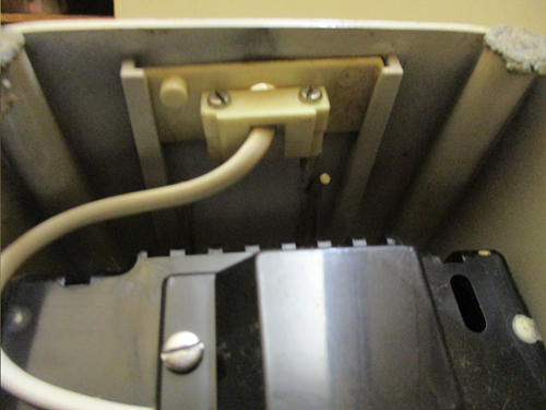

I will perhaps take a photo of the "acble"
It will show the chafing I mentioned, on the metal casing.
Does yours look anything like mine? As you've seen, in mine there is a lot of (definite!) plastic between the cable and casing (whether the casing is metal or not).
Kind Regards, John

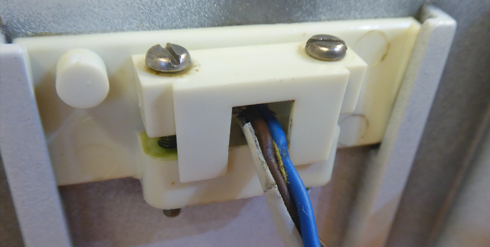

Like JohnW2 ours has a plastic strain relief clamp on the inside, which also forms a plastic bushing between the mains lead and the (metal) chassis.
From inside ...

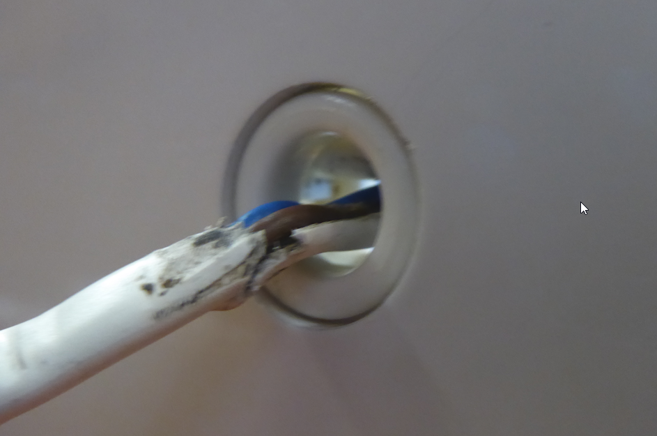

And from outside (sorry about the focus) ..
Like JohnW2 ours has a plastic strain relief clamp on the inside, which also forms a plastic bushing between the mains lead and the (metal) chassis. .... From inside ... And from outside (sorry about the focus) ..
Thanks. That's identical to mine (in erms of the machine itself).
However, what on earth has happened to the cable, and how? was the strain relief actually tightened (onto the out sheath of the cable?
Kind Regards, John
I think the machine walked off the counter at some time, and the resulting yank on the cable pulled it through the strain relief which stripped the sheath off part of the flex. I can bodge by pulling a few inches back into the machine so the clamp tightens on undamaged sheath. I guess heatshrink over the damaged length would reinstate the "double" insulation.

Fair enough.
I wouldn't call that a 'bodge' - I would say that it is the correct/proper repair.
Now that would be somewhat of a bodge, and really unnecessary. By the time you've disconnected the cable so that you can get the heatshrink on, you might as well cut the damaged end off the cable!
I think you can see why I was considering replacing the flex, which is what started this whole discussing.
Yes, that clearly needs to be addressed - but, as above, I would have said that what you regard as a 'bodge' would be the correct repair!
Kind Regards, John

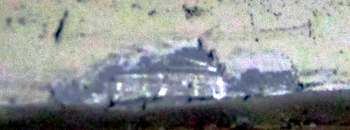

The picture below is awful, but when I took a sharp knife, and then a file, to a small area on the bottom inside of the casing, I eventually got to a shiny ('silver') and fairly soft metallic material, which I imagine is probably aluminium.
However, that metal is covered by a thick layer of extremely hard 'something', which cannot reasonably be described as mere 'paint', and might even qualify as 'reinforced insulation'! It's certainly very strong/durable - until I took my tools to it today, there was no sign anywhere of any of the white 'covering' having been damaged anywhere to the extent of revealing any underlying metal, despite 50 or so years of usage.
