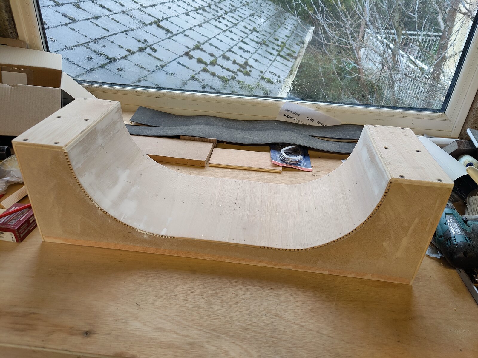

The flexi stuff is great, used it for some set we were building to do some arches

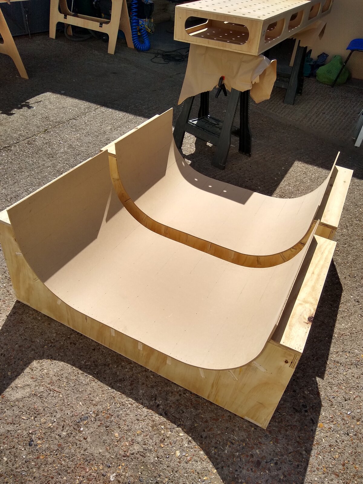

I did something similar but for plywood, for a kids project, so I had to only use materials I already had, but if I was doing something for the house I would have paid up for the right thing.

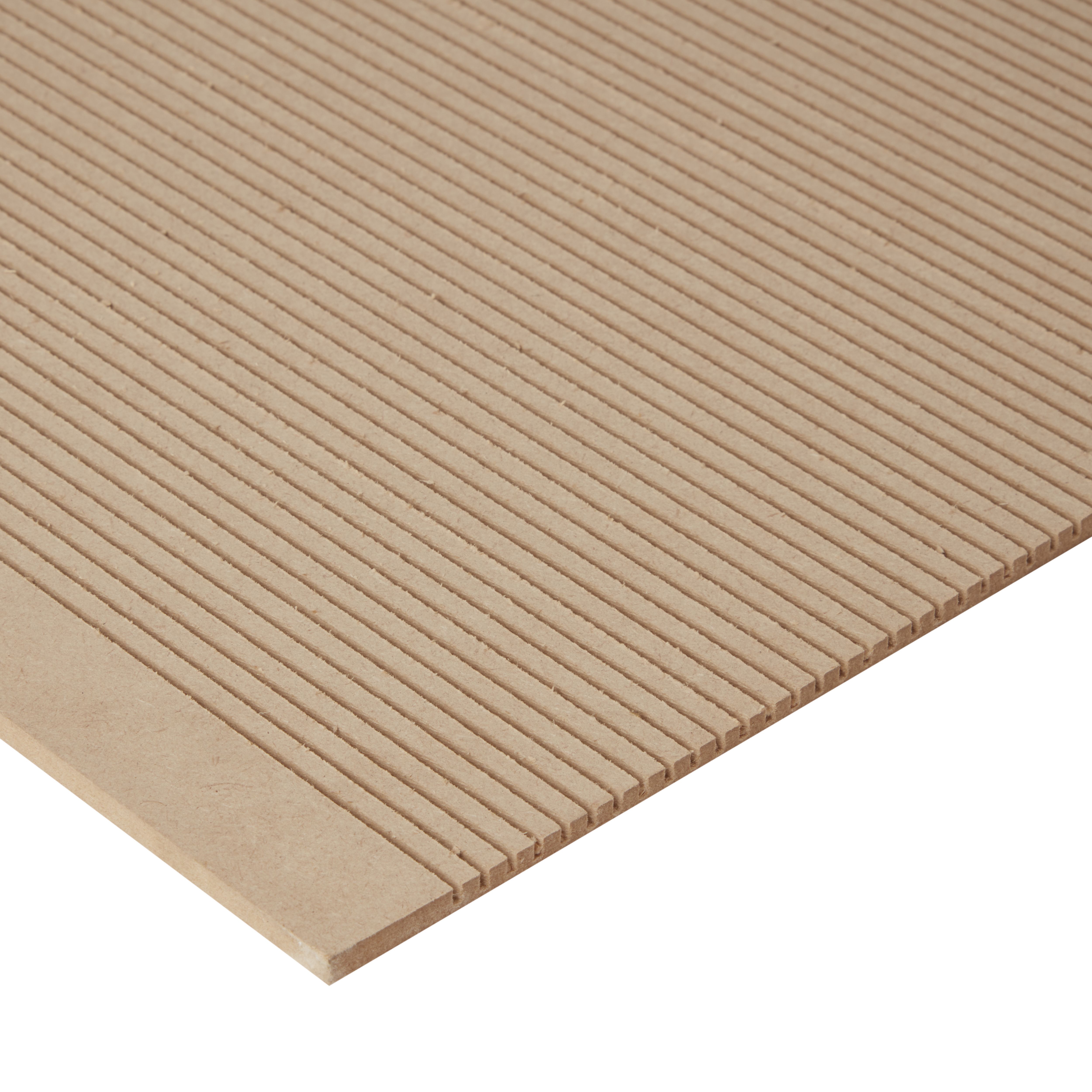

I can buy bendy MDF - I just need to pack it out to somewhere near 18-22mm so could do it in stages.
