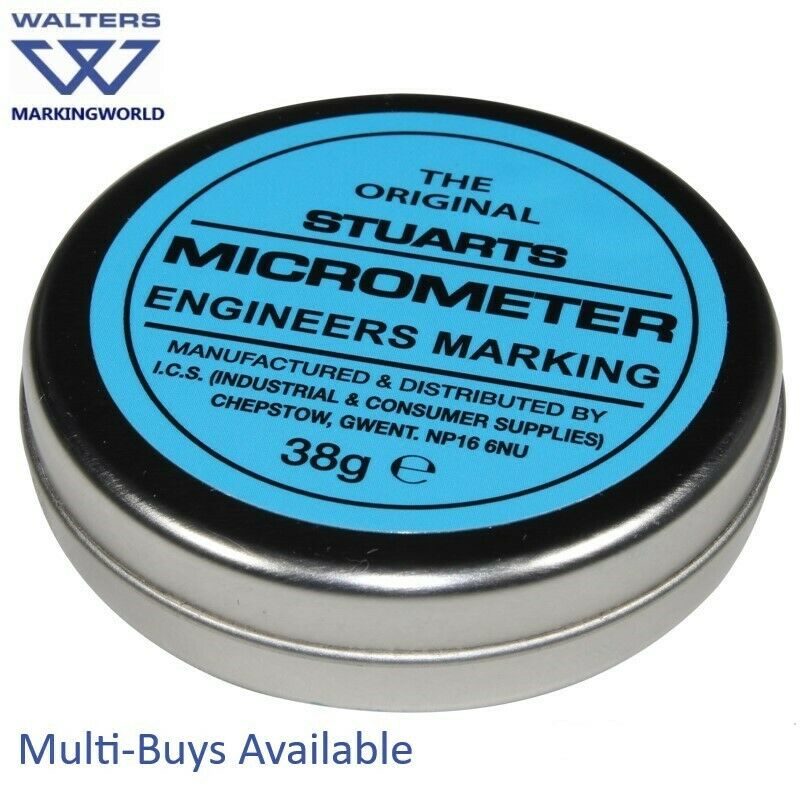

You can also get a tin or tube of Engineers Blue, which is cheaper than a woman.
