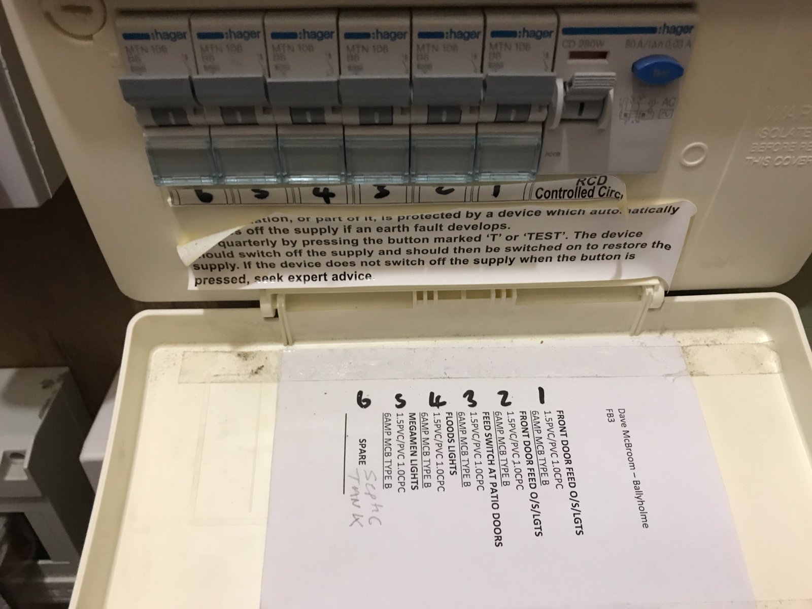

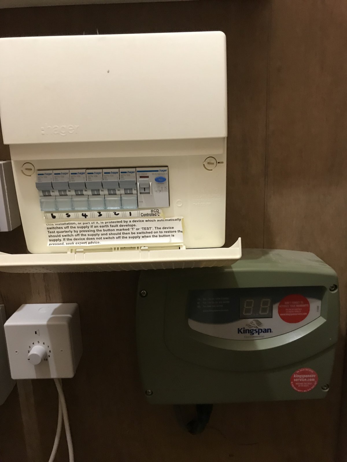

I'm no spark unfortunately but this is what I've got..
The lower consumer unit is the one that states the tank and nothing has tripped here. The only other things that I'm unsure about is the switch on the wall to the right (marked spur) and to the right of that is a blank marked TC or TL in unsure of what this is also?

Your photo is super-blurry but it looks like the RH trip on the lower CU has tripped. Can you post a close up of that CU?
although it would be possible to try and trace your circuits from pics on the web, your installation is unusually complicated for a domestic, and rather short of diagrams. Unless there is a circuit digram pinned to the wall or pushed behind something, I think you would do best to drop the DIY route and ask around for a well-recommended local electrician.
The label in that lid is a good sign, if the installation was done by someone local and those are his details, try to get him back.
Sooner or later you're going to need better labelling to identify what's going on in that cupboard.
The green 'box' is an alarm kit to notify you of an issue with the Biodisc, e.g. loss or rotation, high level etc. Can you check if this has power? Not familiar with the electrical side of the Biodisc, (other than it needs mains supply!), but thinking if that unit is faulty it may not be supplying power to the tank.
