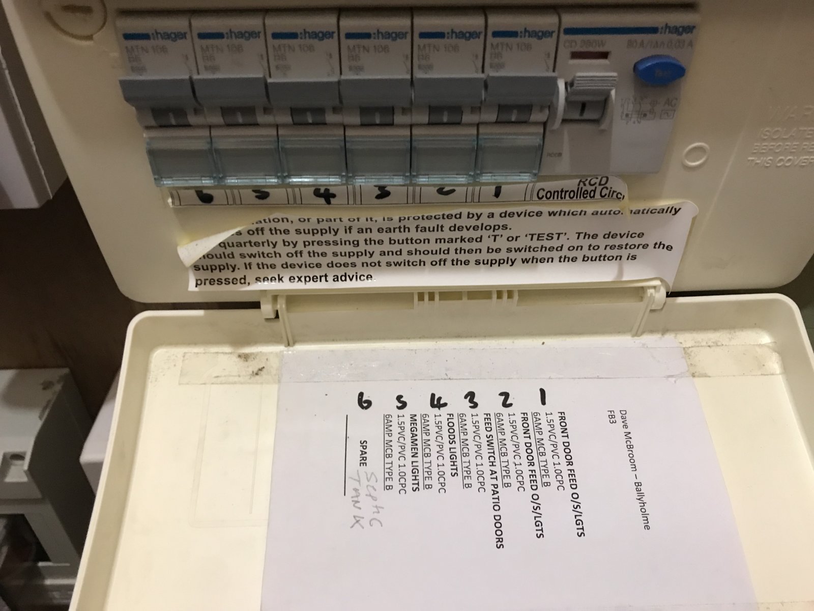

Could the supply to this DB be controlled by a timeclock or light sensor and only be on at night, as all the other mcbs supply outside lights.
It could be that the DB is not powered up at the moment in the daytime.
Check if the lights powered off this DB are working at the moment

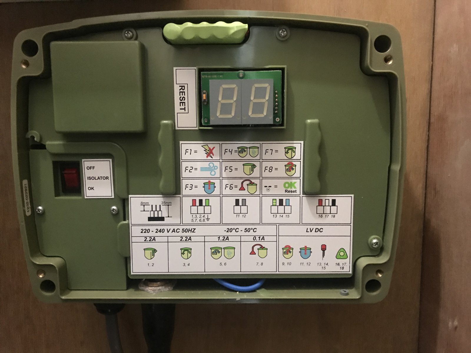

The Kingspan box.... out of the bottom is a grey flex and a black SWA. I guess the SWA goes to the outside and they grey flex is the feed in?
Where does the grey flex go to?
the grey flex goes to the smaller consumer board above. I can only assume that the green control unit has failed and not supplying power to the tank.
Have you check the above?
Ah yes sorry I did check this and the lights are working correctly and didn’t trigger the power to the unit.

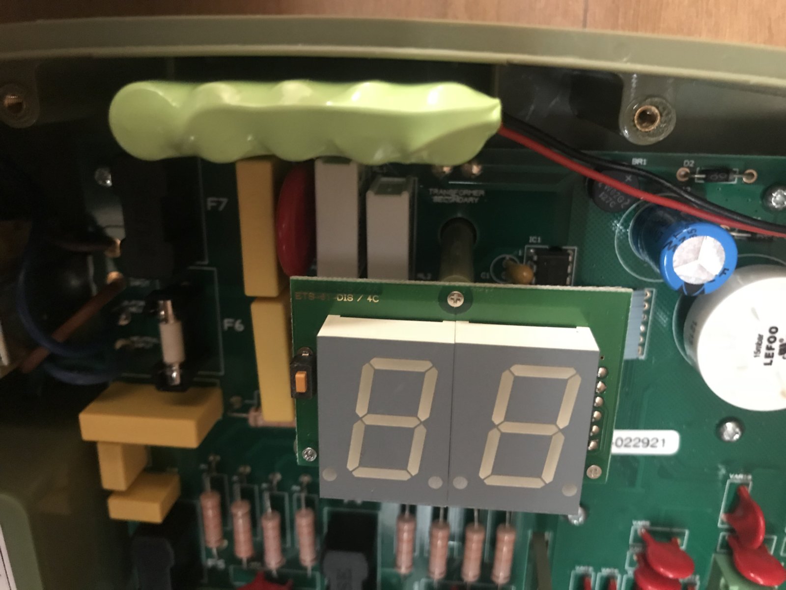

OK, it looks like there could be a fault with the Kingspan box, or a fuse inside the Kingspan box which is blown.
Thanks, I’ve just isolated the unit and had a quick look inside. There appears to be 4 fuses possibly an extra two hidden behind the display. see second photo.
How can I test if these fuses are blown as they visually appear sound. Many thanks for the help!
Multimeter on resistance setting. If you haven't got one, car lamp bulb, some lengths of wire, and test it on your car battery.
It's unlikely the fuses are like 3-pin plug fuses, but if they are you can test by substitution.

In any case, it's no good expecting the kit to work if the biodisc isn't turning, so that needs fixing first of all.
Thanks guys, this is the inside of the unit. Was meant to post these photos before. Will take another look later when Home.
