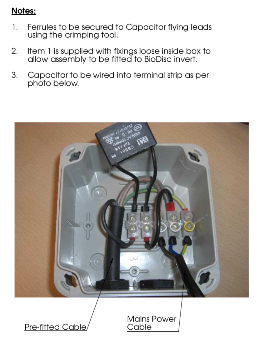

Hi guys, I've got a new motor and cap could some kind soul explain how to wire this as the wire colours differ. The original cap was housed in with the motor but kingspan tell me that it should be within this separate unit...
Many thanks.

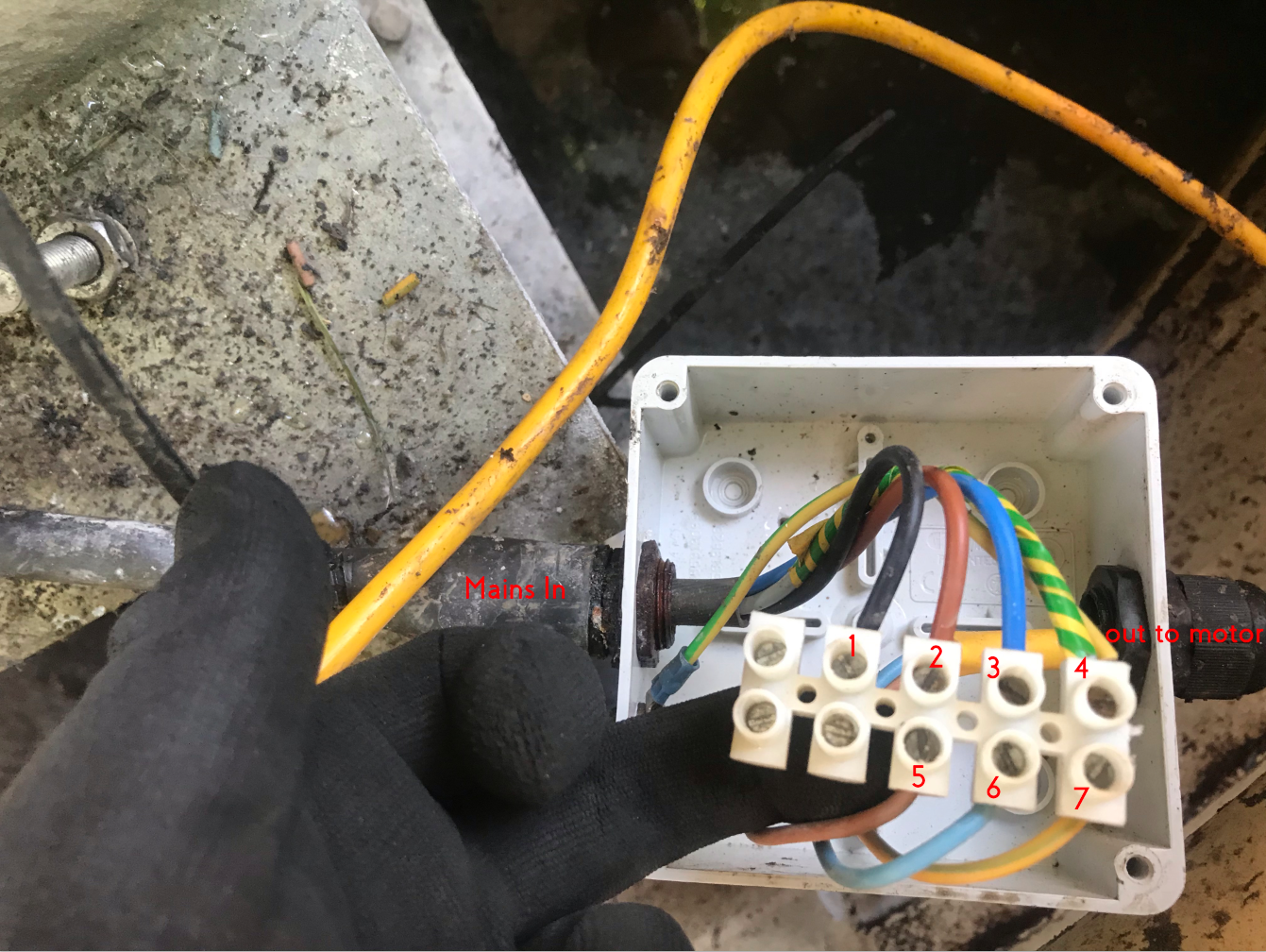

Thank you and yes thats what I have, here is a photo of how it was originally wired at the motor end with the cap 'incorrectly' installed...
If you have only 3 core to motor then cap cant be fitted there. Unless you fit 4 cores!!
Is there not room in motor JB ?......Its in series with start winding so why mount it remotely ??
