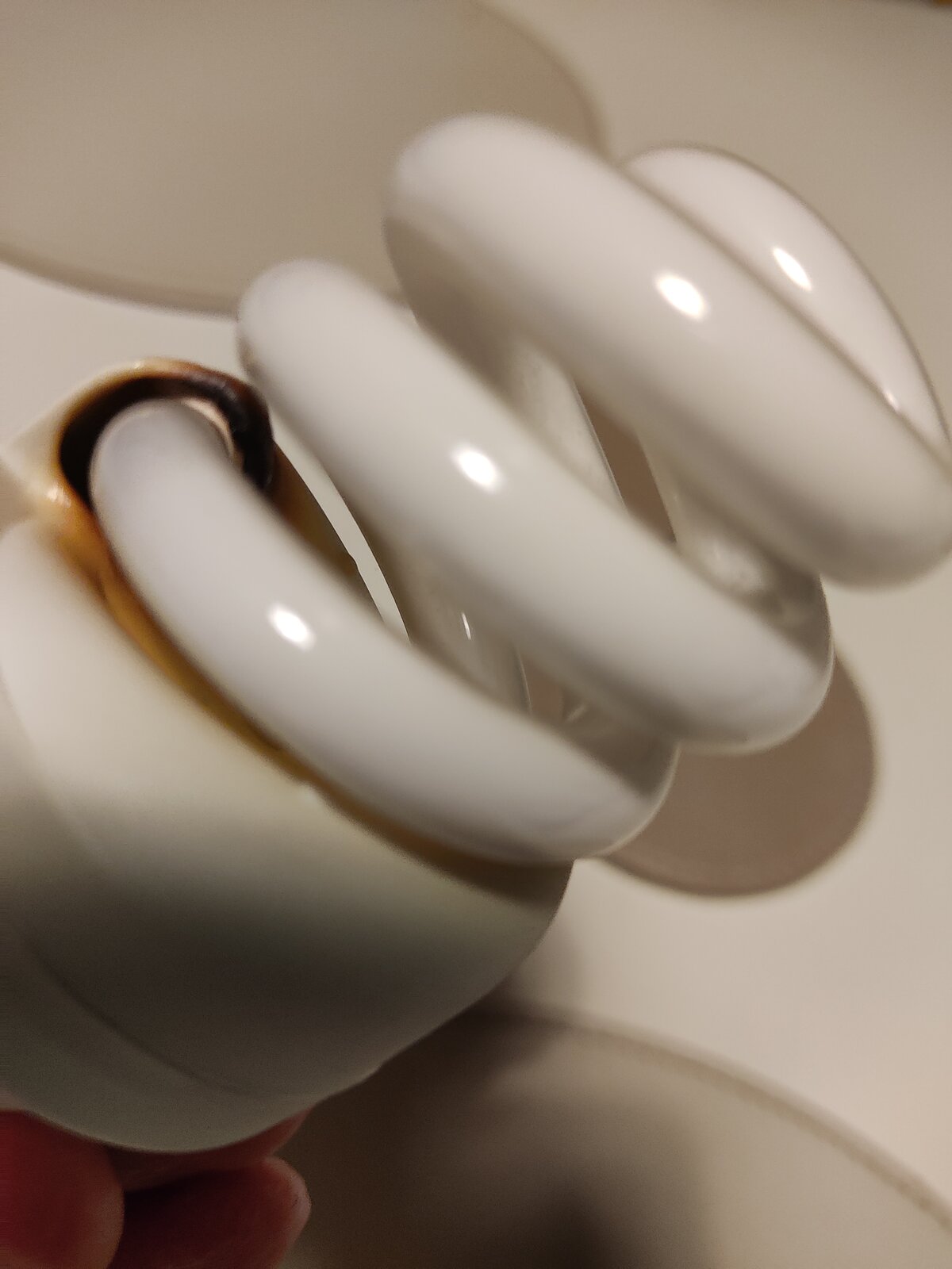

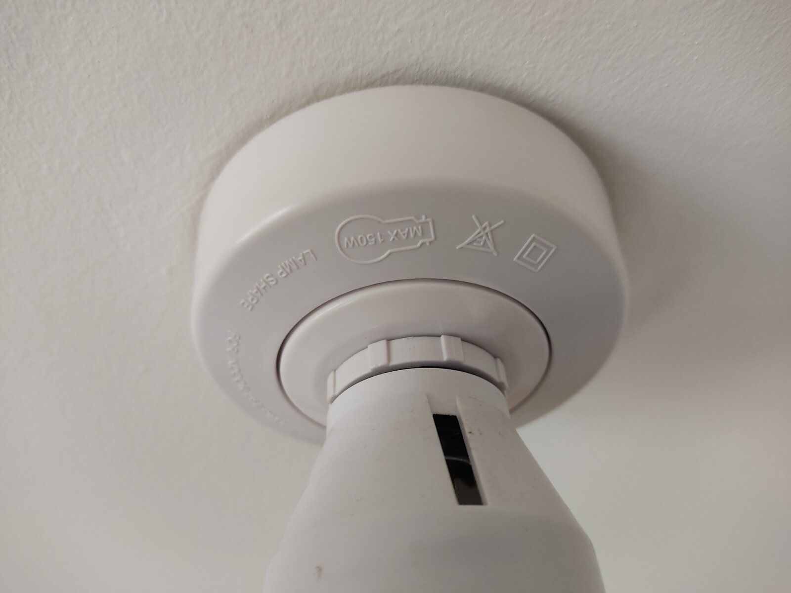

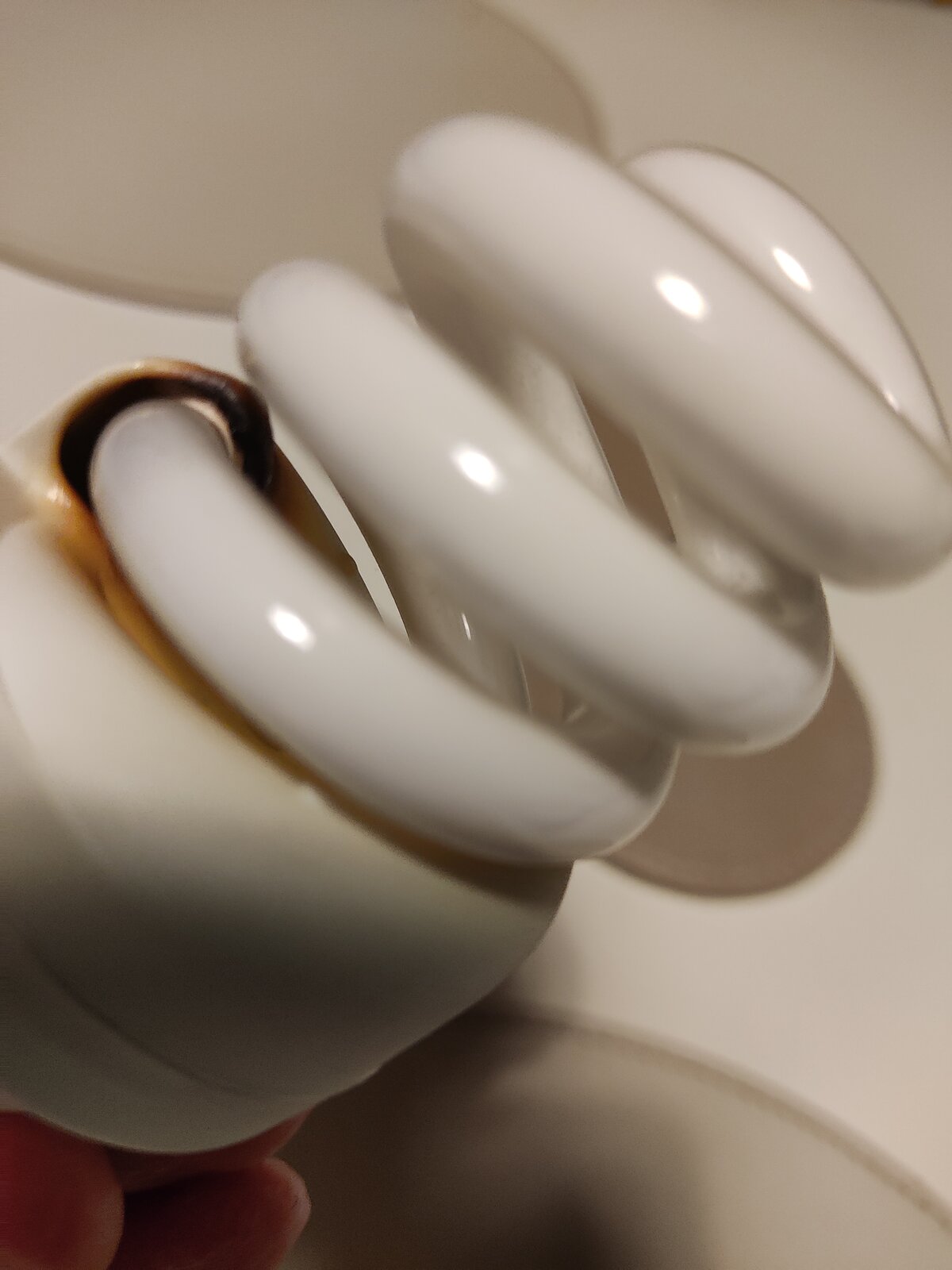

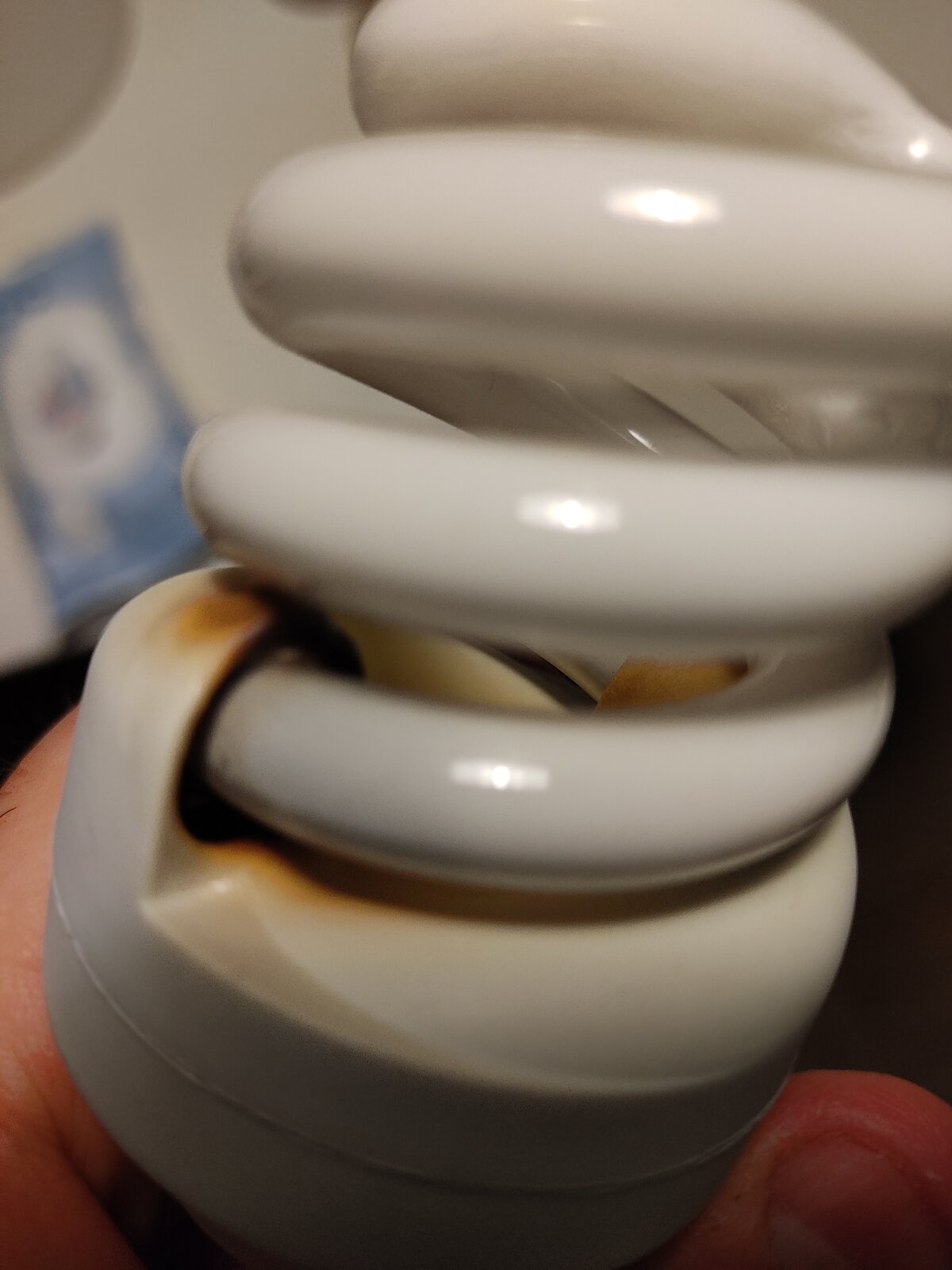

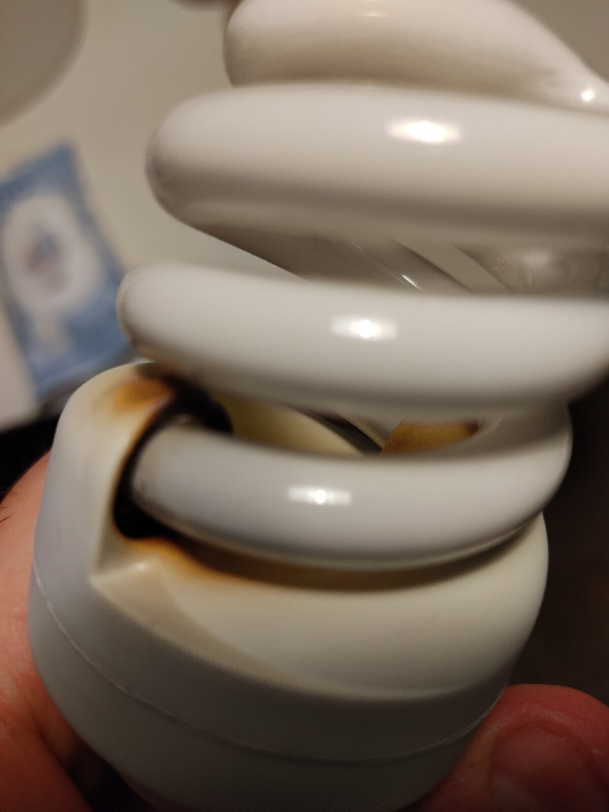

Hi all. Was hoping for a bit of help please. There are two light fittings in my kitchen and one of them has blown out about 6 or 7 times in the past couple of years. Would there be a reason why this keeps happening on one light fitting but not the other? Tried using different bulbs but no difference, the bulbs will work for a few weeks/months typically then blow.
Carefully Check there are no lose connections in the fitting.
Have a look on the back of the failed lamps to check for any signs of burning / arcing / pitting on the contact pads.
The yellowing to the lamp in your picture suggests it’s been used for a substantial amount of time.
A good quality LED lamp should last for a decent amount of time.
In my experience Philips branded lamps seem to be well made.

Cheers, will take a look in the morning when the lighting in the room is a bit better
The yellowing is probably due to it being in a kitchen too.

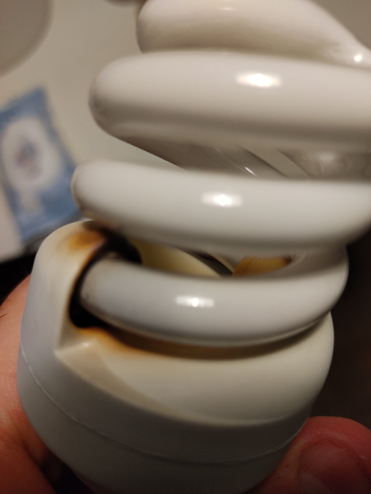

Definitely signs of burning etc
I have heard the 'pop' a few times in the past and sometimes there's been a little smoke with burning smell to go with it

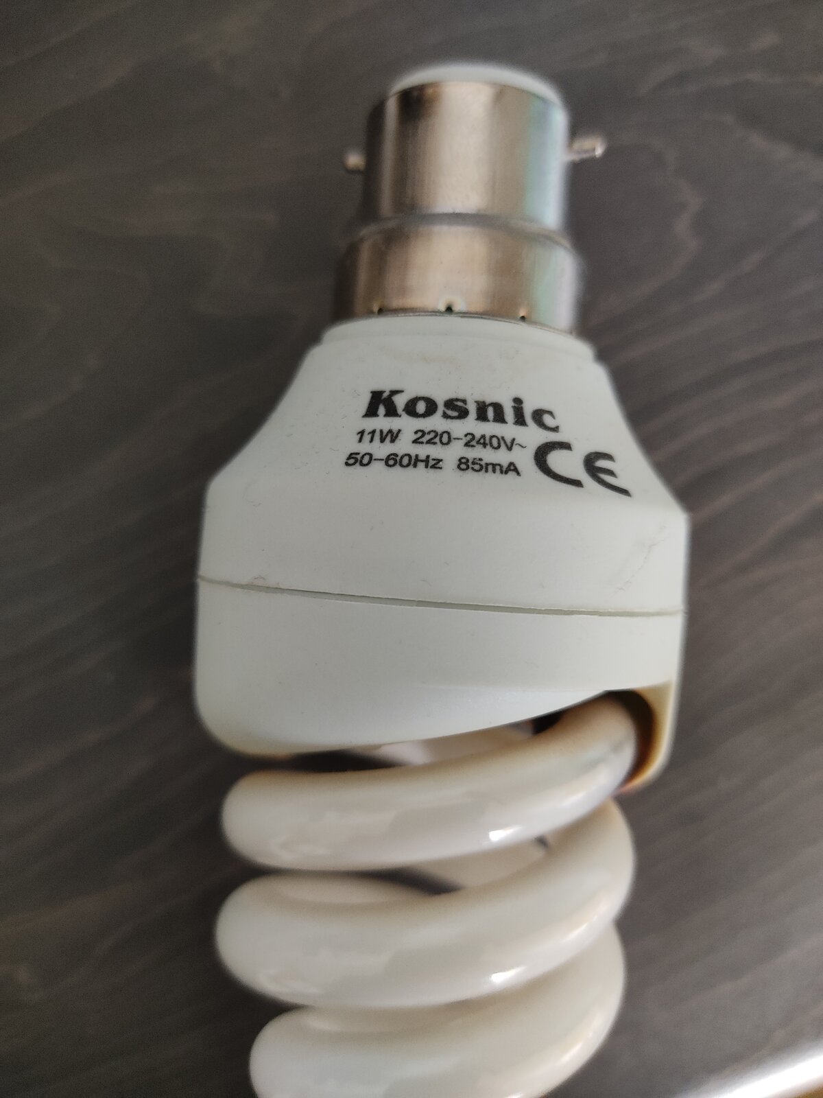

Also, I'm not sure that brand is a quality one. They tend to fail prematurely.
The "it's in a kitchen" may also be a reason why these fail.
As a kitchen can have fumes, oils/fats etc. in the air when cooking then perhaps an unsealed lamp is not the best to use?
There appears to be gaps around the tube itself where the ingress of stuff can get into it, if that happens and it's getting on the PCB then it can cause tracking and premature failure.
Have you considered trying LED lamps instead? OR perhaps look at sealed fittings.

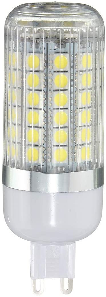

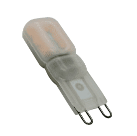

The biggest complaint about LED lights is you don't know until after you buy if smooth output or pulsed output, these two bulbs G9-small.jpg G9-big.jpg both fit the same bulb holder (G9) the first one has a tendency the flicker, the second has an electrolytic capacitor to smooth the rectified DC so no flicker, but there is nothing in the spec to say which is which.
The CFL could also flicker, and like the LED flash when turned off, but I never noticed it with the CFL but have with LED.
On the plus side I find the colour under LED lamps far better than fluorescent, but the suck it an see approach is really not good enough. I have not worked out why LED lamps with electronic switches flicker to start with, my switches you can hear click, so clearly a relay makes the circuit, but bulbs under 5 watt tend to have a shimmer or flicker, and it seems to be down to bulb size not load, 5 x 2.2W shimmer, 1 x 6W does not.
