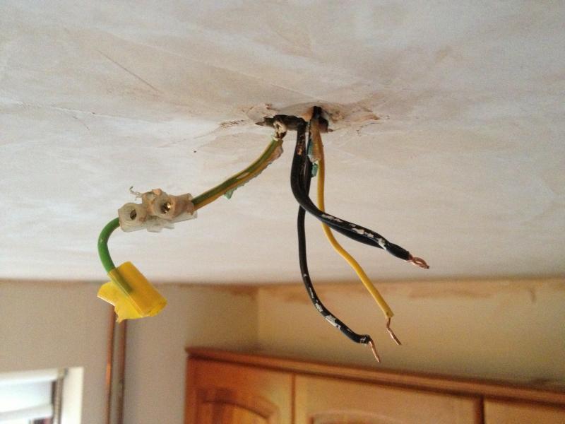

I've done something silly and now can't get our kitchen lights working. A month or so ago we had our artex ceiling throughout the downstairs skimmed by a plasterer. Before he arrived, I removed all of the light fittings so that he could do the job properly. They were such horrible outdated fittings that I (stupidly) just snipped the wires and covered bare ends with insulation tape.
Before I did this, all lights worked including some undercounter ones that are fitted under the kitchen wall cabinets. These were left in situ but now no longer work - presumably because they are wired up via the ceiling rose which was removed.
I would like to get the undercounter lights working whilst we decorate etc and before new ceiling fittings are installed. But I can't work out how???
Here's a pic of the ceiling rose wiring.
Could you confirm the core colours?
Is it three black and three green-yellow?
Or have you also got solid yellow cores.
Also do you have any approved safe equipment for carrying out continuity test and live voltage tests? If not it is purely guess work and assumptions.
It is likely that at least one black is a neutral, but possibly two and the green-yellow cores are earth/CPCs, then the remainder line conductors.
But without proper test procedures impossible to know!
Please make a note to ones self, when dismantle and disconnecting electrical cable, take a note, picture/diagram of the arrangement prior to messing!
Looks like the two blacks together are half twisted together: could be neutrals. If they are not touching, that could break the circuit and stop other lights from working.
The other black could be switched live.
The reds could be tucked away: are they in the ceiling?
You need to switch off and investigate to see if there are more wires hidden away.
The colours are (from left to right): one earth (yellow/green) connected to a block, black, yellow, two blacks twisted together.

You require approved test equipment, such as a multi-meter.
As it is guess work at the moment, as it is possible that some of the black cores are line conductors and joining them could result in a blow out!
It is an odd combination of colours: all blacks plus one yellow.
Sure, as PBoD suggests, the other rose is most probably associated: find all those connections and report them here, as they need reconnecting as well, no?
Can you pull the wires out of the ceiling some more until the grey outer sheath of the cable is exposed?
There may be additional wires or even joints pushed up into the ceiling void.
Make sure the power is properly isolated at the consumer unit before working on any of these wires. They may be live or come live even when the switch is turned off.

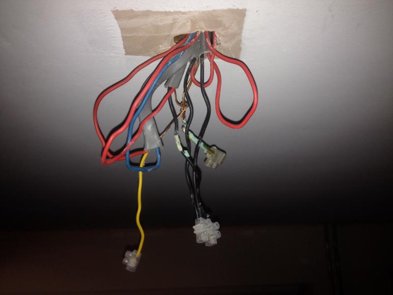

I've pulled down the cables to expose some previously hidden wires. It's not a pretty sight and I'm thinking I'll need an electrician tbh.
Do you still have the live loop (Reds) in the ceiling void?
Seems you have now connected all the blacks together has this brought power back to the lights that were not working?

So the blocks you see in the latest picture were fitted by a pro leccy, not me. Surely he would have tested them before applying the blocks?! Not just guesswork surely.
