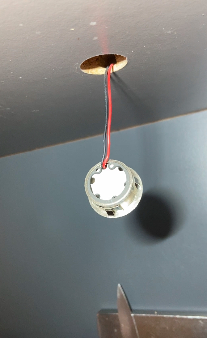

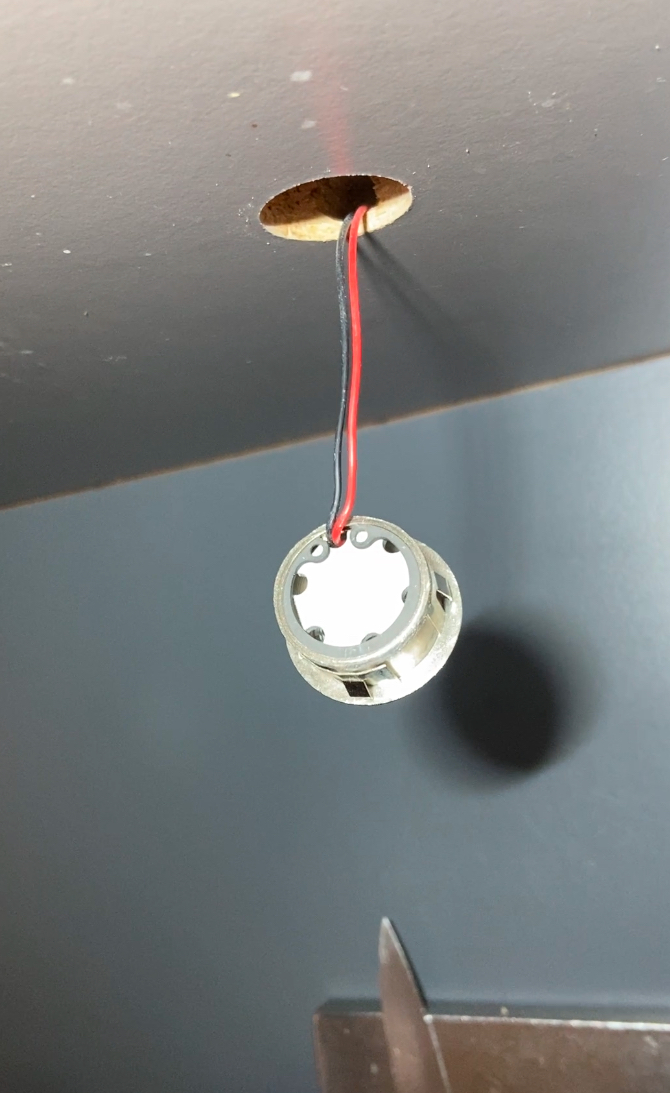

Ok, an update- as this is a neighbours flat it hasn’t been a priority but I was reminded about this and had another look. So it turns out the Led downlighters aren’t glued into the shelf bottom as suspected, but just pressed in and can be carefully removed by inserting a knife into the gap and gently levering one side at a time.

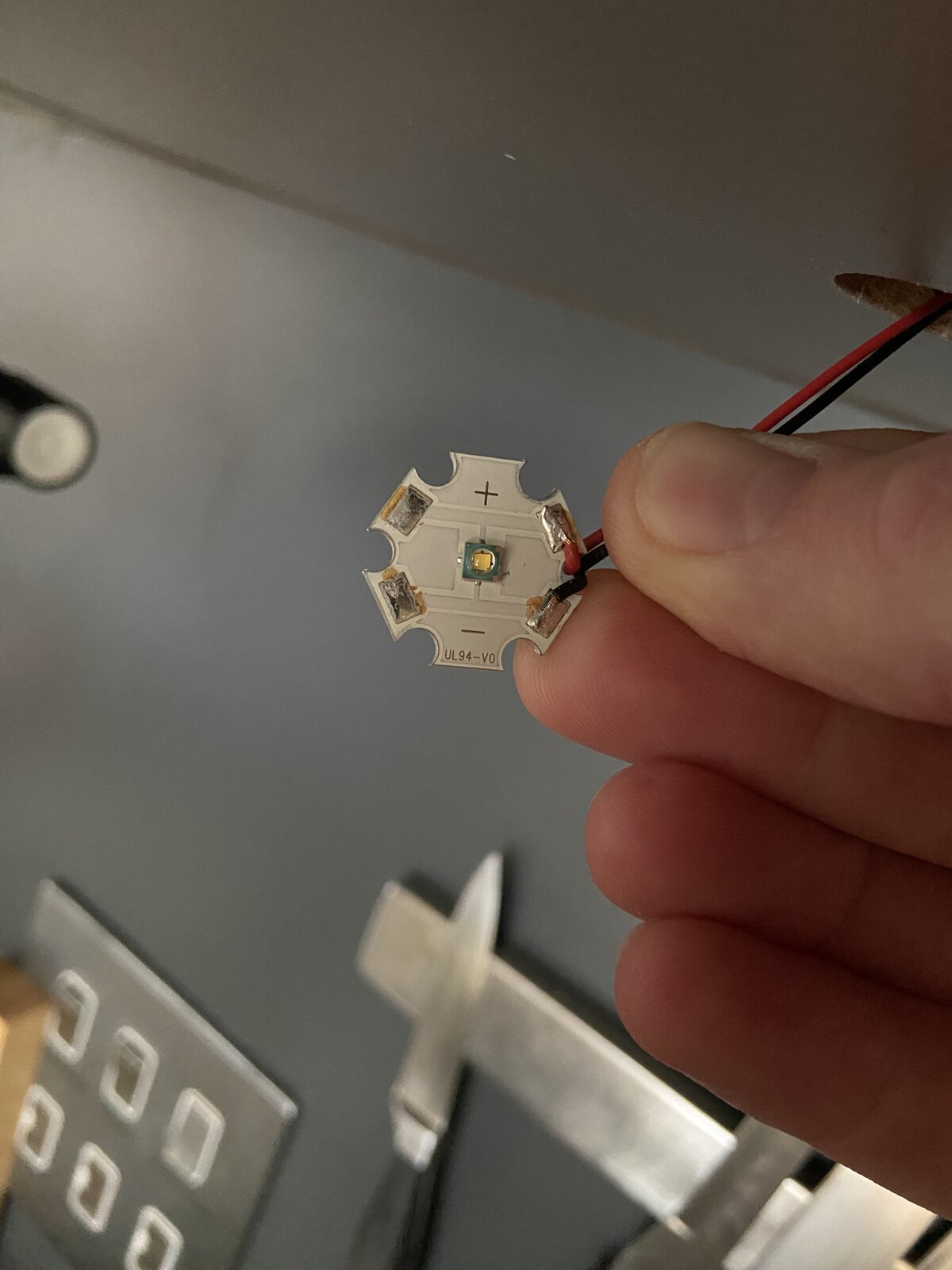

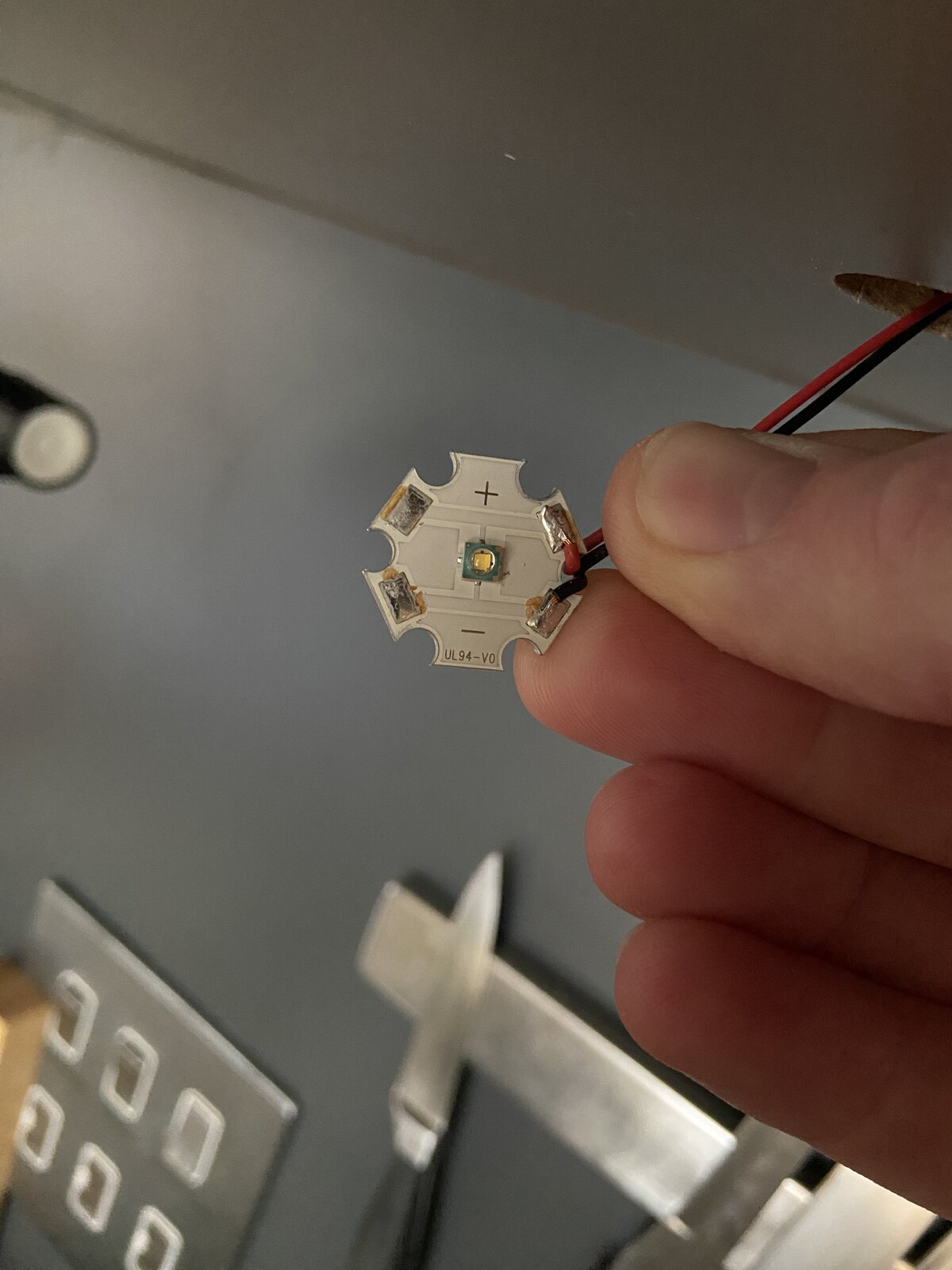

Once removed, removing a circlip separates the holder/diffuser from the led itself. I could solder on replacements easily enough - providing I can find them. The code ul94-v0 turns out to mean they won’t propagate fire, rather than a helpful serial number to identify them.
Any suggestions on where to find appropriate replacements?

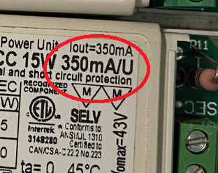

Step one is measure the current
is it using the 350 mA stated on the driver? Likely not, if as I suspect lower, then you may find a faulty one by shorting out each LED in turn, but I suspect LED's damaged due to a surge, I suspect the lot needs changing, but until you measure the current, just guess work.
Yes, I did a reverse image search and found similar- but I don’t know which ones are suitable.
The information I have is the transformer is putting out 43v and there are 10 leds (I’m expecting to replace all of them).
I don’t have a way of measuring the current on the circuit. Surely there’s a way of specifying 10 LEDs based on what I do know above?
Cheers
This is the salient point
the LEDs need to be rated at 350mA, the driver will regulate the voltage (up to 43V) and likely to be around 30-36V (depending on the LEDs) to provide that current.
So you are looking for LEDs rated at 350mA and about 2.5 to 3V.
