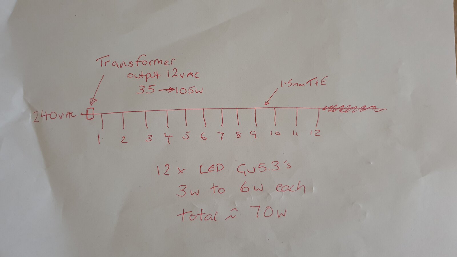

Hi all,
Over the past few years I have had regular issues with my 12 kitchen downlighters due to replacing the standard 12v lamps with 12v LED's and leaving the old transformers in place.
As I understand it, the issue is that the transformers require a minimum wattage to be drawn to work correctly.
Therefore I finally decided yesterday to simply remove all of the transformers and replace with 1 transformer.
However this has not worked as only some of the lamps do not come on and when I fit some lamps others dim.
I have attached a sketch showing the set up and would appreciate any help as I cannot understand why this will not work.
Could it be anything to do with LED sometimes requiring an initially higher current?
Any help much appreciated.

There is also the issue that those power supplies (they are NOT transformers by the way) operate at tens of kHz not 50Hz. 12v LEDs are typically designed for DC or 50/60Hz AC. Either get a real wire wound transformer or a proper LED driver.

From the above 2 replies I think the 2nd is correct and I do have a "transformer" that is probably a "power supply" and it is designed for LED's so I am confident that it is the correct piece of kit.
However since my original post I have discovered that the maximum length of the output cable is stated as 2m and hence I am exceeding that significantly.
Does anyone know why this would make a difference?
Could it be due to increased impedance?
Many power supply units use high frequency ON-OFF-ON-OFF switching to control the voltage on the output. With long leads there are two main problems.
The high frequency switching creates radio frequency ripply on the output, this radiates from the cabling and can interfere with radios and other wireless items.
The external capacity between the cores of the lead can affect the stability of the circuits controlling the voltage.
A power supply produces power with a controlled voltage. This power is then fed to a driver which controls the current that is driven through the LED element(s) of the lamp.
An LED driver provides a controlled current which feeds the LED element(s).
Many items are mis-labelled
It is described as an LED Driver It is NOT a driver but it is a power supply. If it were an LED driver it's output would be a rated CURRENT but as can be seen this item has an output that is rated as a constant VOLTAGE.
If you connected this directly to an LED element then the LED element would be destroyed.
This item is intended to supply power at 12 volts to a driver inside a lamp.

You don't .
1. From your diagram in post 1 you show a supply with an output of 35 to 105w. Real transformers don't have this minimum restriction, it is typical of halogen power supplies.
2. Real transformers don't have a 2 metre restriction on their output cables. Halogen supplies operating at switch mode technology in tens of kHz generate radio interference. The shorter the cable the less of this interference is radiated.
