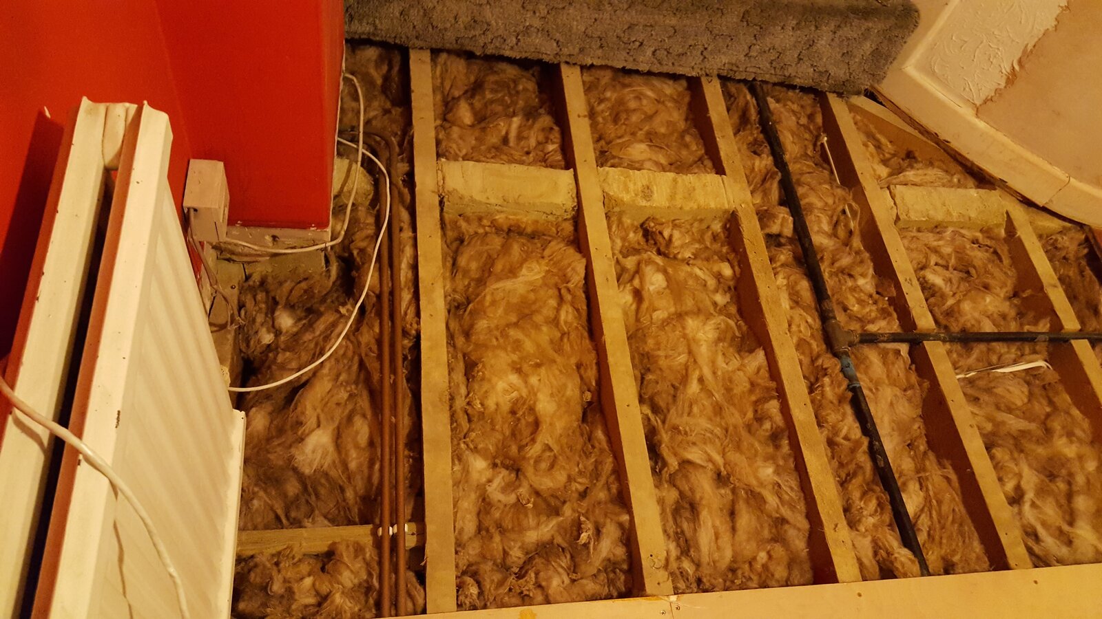

Before fitting the new cover is the best time to take up floorboards, clean out airbricks, remove rubbish, insulate pipes and run any wiring you might need for sockets, phones, LAN, speakers, alarm or aerial, and go repair or screw down any boards that need it.
You can also insulate the floor if you want, and block draughts with mineral wool round the edges
Any advice as to what to use and where to get it? I've tried getting underfloor insulation before and it was impossible to get something that I could fit myself.

You can use loft insulation. Get the brown mineral wool treated with ecose, which does not shed irritant dust and fibres. It will be marked on the packaging. Most heat loss from floors is draughts round the edges and any holes, so take extra care here. If you can't do the whole room, go rou d the edges. Do not block airbricks.
Oh okay. Presumably you need to suspend it, somehow? Otherwise it just ends up on the ground :D I seem to remember seeing something about netting, but I don't know if it was for use with using loft insulation or something else, now.
If netting, how do you protect that from rodents? I'm guessing they won't be interested in mineral wool, but they will get at anything plastic (just to p**s us off, I think). Countering rats, or even mice, with metal netting is possible but I know the wire used needs to be of certain gauges etc. to do so. I don't want to spend money on insulating only for it all to fall to the ground and be useless.
