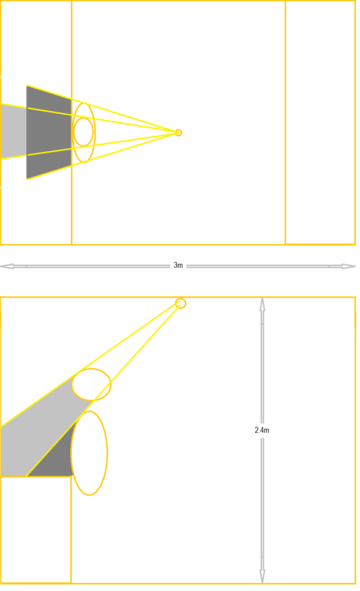

Bear in mind that the kitchen is almost unique in that a majority of the time you are working close to and facing the wall and hence creating a high risk of shadow on your work space, as such I'd avoid point lighting and my choice has always been linear fluo's and the longer the better simply to cut down shadows.
However the rental property I mentioned earlier was 2.4m x 1.5m with heck a sketch is easier
with a run of wall cupboards and cooker hood opposite the door, creating a shadow was nigh on impossible other than the wall cupboards themselves.
Roughly speaking this shows a 3m wide kitchen with 600mm worktops both sides, single light at 2.4m ceiling and 1.8m person standing at worktop
Dark grey shows shadow cast by the shoulders/body and light grey shadow cast by the head.

...... with a run of wall cupboards and cooker hood opposite the door, creating a shadow was nigh on impossible other than the wall cupboards themselves. ..... Roughly speaking this shows a 3m wide kitchen with 600mm worktops both sides, single light at 2.4m ceiling and 1.8m person standing at worktop
.... Dark grey shows shadow cast by the shoulders/body and light grey shadow cast by the head.
Whilst, as I have said, I certainly agree that 'point light sources' are undesirable in locations like kitchens and workshops etc. (maybe even some offices etc.), and whilst I don't disagree, conceptually, with anything you say and illustrate about shadows, I think that, in practice, the shadow issue is nothing like as bad as one might expect.
Particularly if (as is commonly the case) everything is fairly light-coloured, reflections off walls, ceiling, cupboard doors, work surfaces and even floor have light bouncing about all over the place, thereby mitigating the shadow issue to a very appreciable extent.
Certainly traditionally, and probably still today, the majority of rooms in domestic settings are lit by a 'point source' (very commonly a single pendant) and, although there are presumably always at least some shadows to be seen if one 'goes looking for them', in practice one usually does not notice, or become aware of, any shadows at all.
