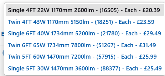

This: https://www.toolstation.com/integral-led-lightspan-ip20-ik08-batten-light/p57915
which will cover the same area on the ceiling and very likely use the same fixing and cable locations. It will be significantly brighter than the old fluorescent tube...

I've just looked back in my records, and the LED tube I 'shoved in' is 17W and claims to have an output of 2,300 lumens - and, as I said, seems to produce a quite reasonable level of illumination, given that, the (60W) panel you recommended has a claimed output of 7,200 lumens - that's over three times the output of what I have, so wouldn't it be far too bright?
I was also surprised to see that, based on those claimed figures, your panel seems to produce 120 lumens/W, whereas my cheapo LED tube claims about 135 lumens/W - would you expect that? In fact, 60W of LED seems an awful lot - many of the rooms in my house are lit with 12 W or so of LED.
The 6ft twins have two long led strips within hence the high wattage and brightness , the single version is likely 30 watt, though as you say still considerably higher wattage than your existing

How about a couple of 4 or 5ft singles instead?
from the drop down list on FPs link.

How about a couple of 4 or 5ft singles instead?from the drop down list on FPs link.
As I said, that is the idea I have been toying with (and inviting comments about), with the two fittings 'in-line' down the middle of the ceiling.
Mind you, from "the list on flameport's link", even 2 x 4ft would be 44 W and 5,200 lumens, with 2 x 5ft ones being the same as his double (60 W and 7,200 lumens) - both an awful lot more than the 17 W / 2,300 lumens I have at present, which is more-or-less adequate.
I have a garage a very similar size to your kitchen. .... It has two 6 foot twin LEDs along most of the length, and a third across the width, just where the up and over door comes to when open. The garage is not painted, so I would say 2 x 6 foot twins would be fine. .... The ones I have are Ansell Tornado Anti corrosives, but obviously you won't want those in the kitchen. Something like the second option rocky posted looks OK to me, though.
[ I presume you mean Sunray? ]
Thanks - but two of those 6 ft twins would surely be way OTT, wouldn't it? They would add up to 130 W and 15,600 lumens, which sounds an awful lot for a room which is currently 'reasonably adequately illuminated' with 17 W and 2,300 lumens :-)
My current thought is to go with two 4ft or 5ft singles - in-line down the middle. That would still be a fair bit in comparison with 17W/2,300 lumens (44 w, 5,200 lumens for 2 x 4ft, 60 W, 7,200 lumens for 2 x 5ft), but seemingly more sensible than two 6 ft ones?
