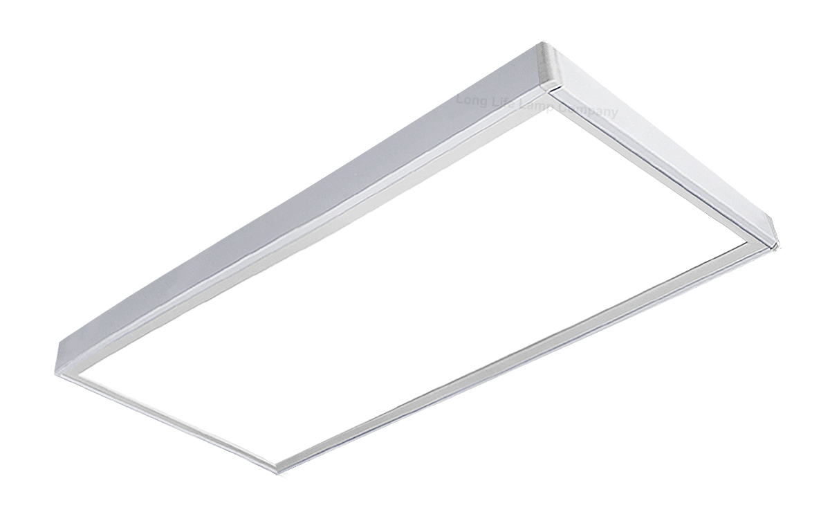

So you do not have to do any plaster boarding how about one of these - its the frame for it but something like this in 48w \LED I would go for the 6000k
I have 2x 18w 10inch round slimline ones in my much smaller kitchen and they give a very good even light so much so that I do not need under cabinet lights as the light spreads out under the wall units.

How does having a frame make it any easier (less invasive) to install the wiring (which is the main work-generating issue)? You surely aren't suggesting wiring in surface-mounted trunking, are you?
