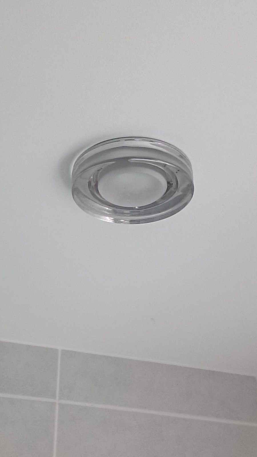

I thought I wanted downlights for our new kitchen (approx 4m x 4m) as I have been more than happy with our choice in the bathroom. Astro lighting's Vanvouver. Photo attached.
I believe they are now considered to be "the devil's work" (halogen!) and I should go for led.

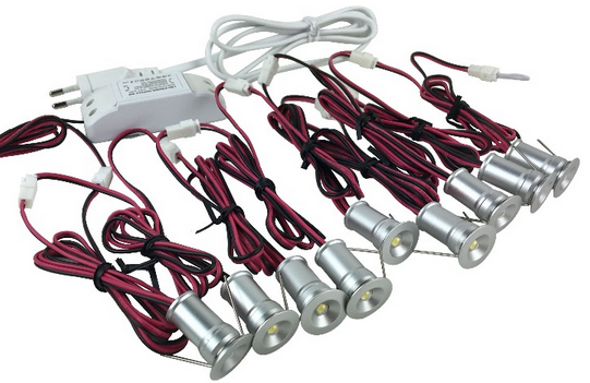

Yes, under cupboard lights are not a gimmick - it's a good way to light the working surfaces, especially if you've fitted "poor" main room lighting (and yes, I consider small recessed torches to be "poor" for functional lighting). I'm half way through fitting them in our kitchen which is lit by a large array of little torches (previous owner's choice) - not helped by the PO putting the JBs behind the cabinets meaning I have to partially disassemble the cabinets :evil:
I would choose strip lights rather than individual LEDs - the latter give you hard shadows. I've chosen flexible LED strip fitted into an aluminium extrusion with translucent cover - and fitted them about 4" back from the front of the cupboard so they aren't lighting the work surface (and things on it) from behind.

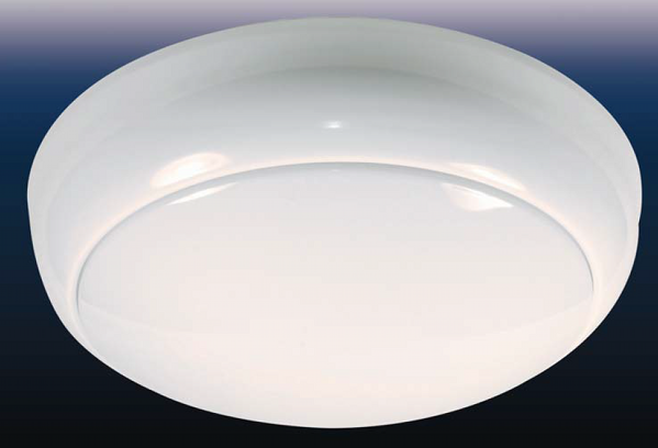

I'd suggest surface mounted lighting, either round types such as these (in particular, look for those with diffuser visible round the sides) or LED battens such as these. By having a surface mounted fitting, it can shine the light all around and the ceiling will act as a diffuse reflector.

Seriously - don't dismiss the idea of lights under your wall cupboards shining down onto the worktops. LED strips can provide nice, even lighting.
And don't dismiss the idea of being able to change the colour or brightness of those lights - depending on what natural lighting you have you might find that in "daylight" hours you want different artificial lighting to when it is dark. Or when you come down in the night to get a drink.

So you've seen for yourself how they are great for "looking good" but have "poor" efficacy for actually lighting the room and stuff you want to use/do :whistle: I can't help thinking they are often specified by "architects" who don't have to live there.
Having said that, our kitchen was improved quite a lot by fitting different LED "bulbs" (ones with a single central emitter) allowing both a wider spread and allowing more light to escape the fitting - but even with a dozen of the damn things, still not half as good as a couple of LED battens (flouro tube replacements) or about 3off 10W surface mount round fittings would be.
