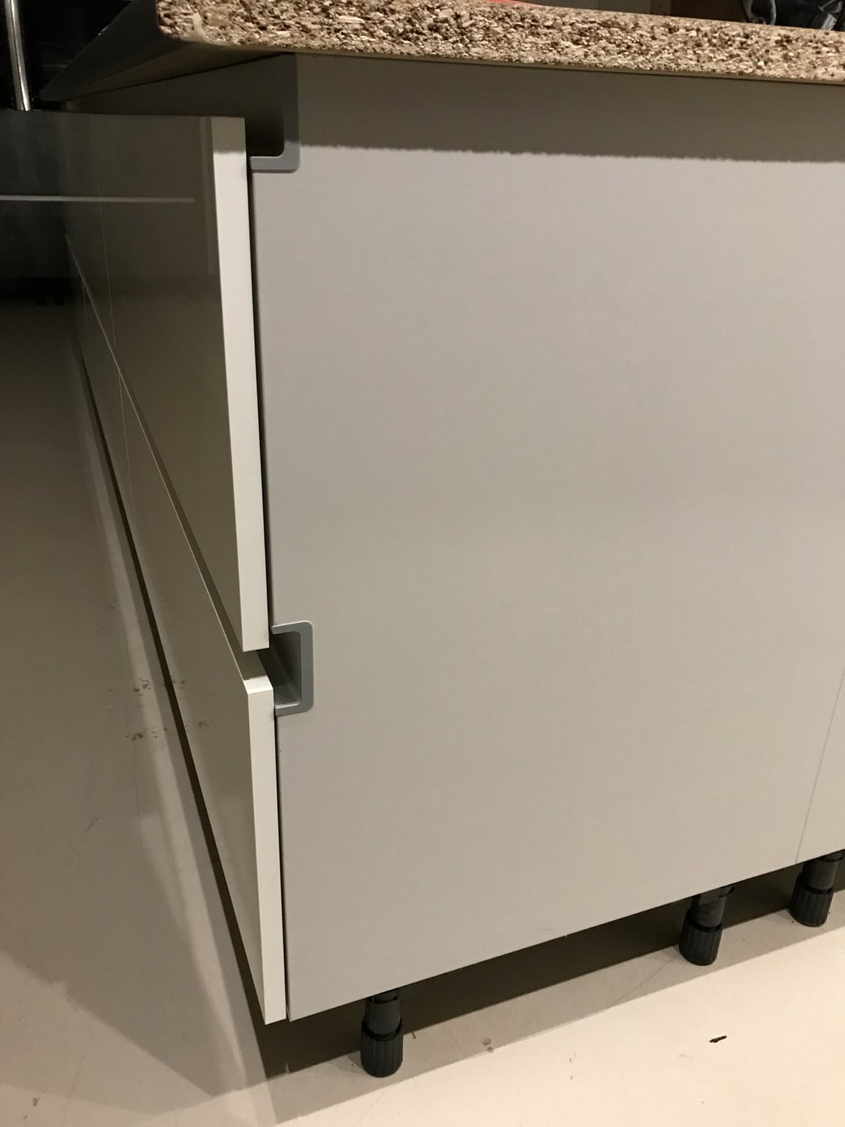

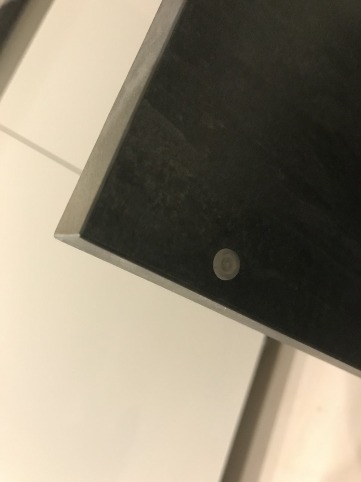

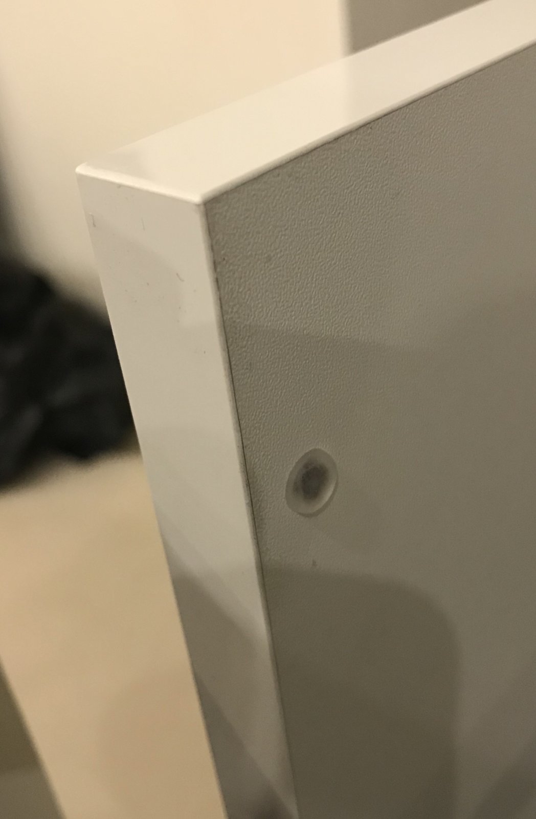

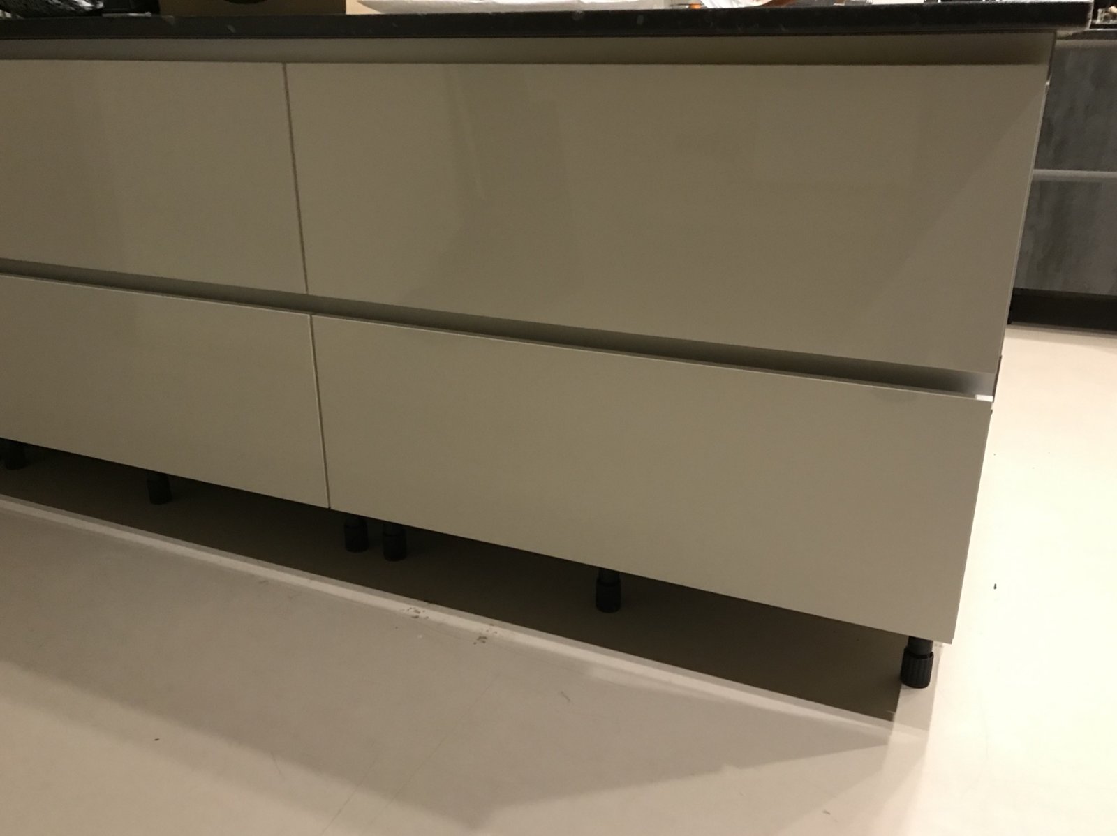

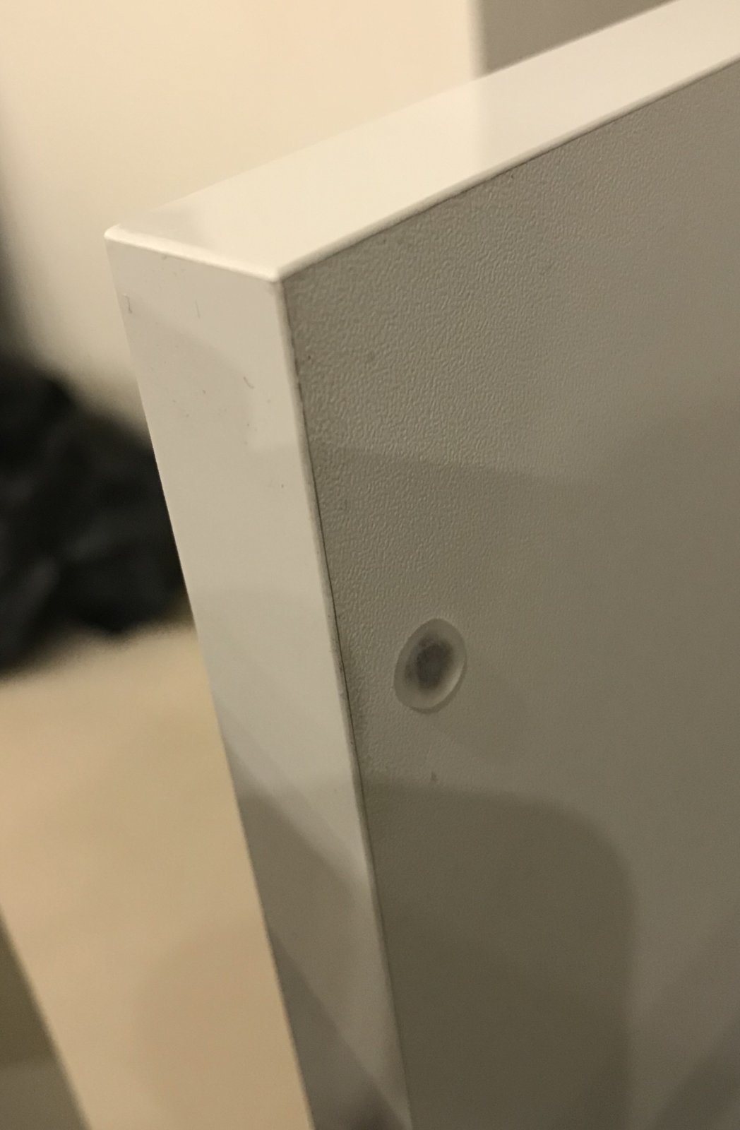

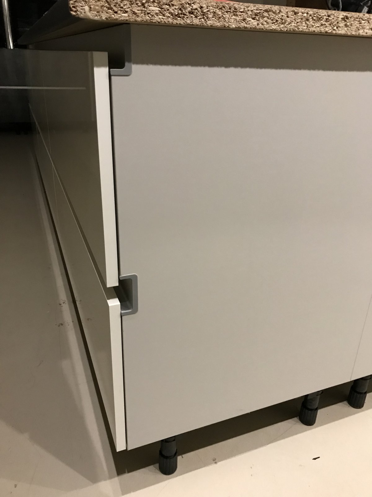

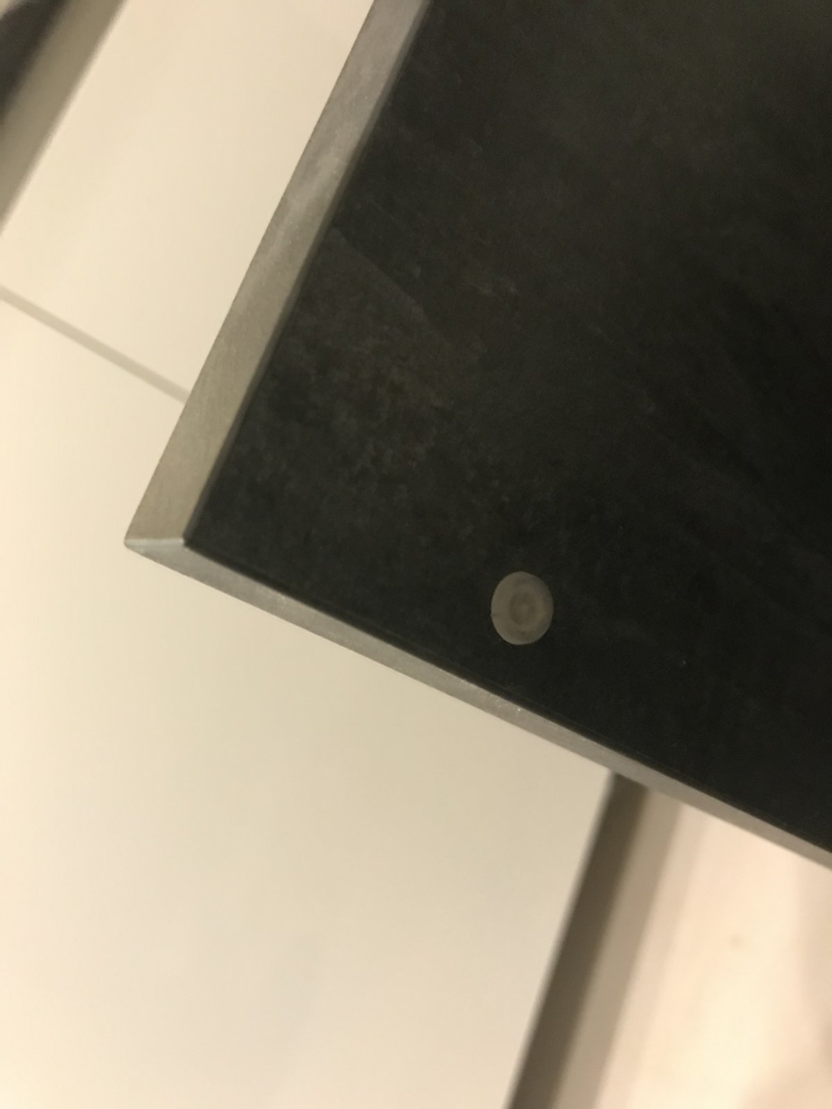

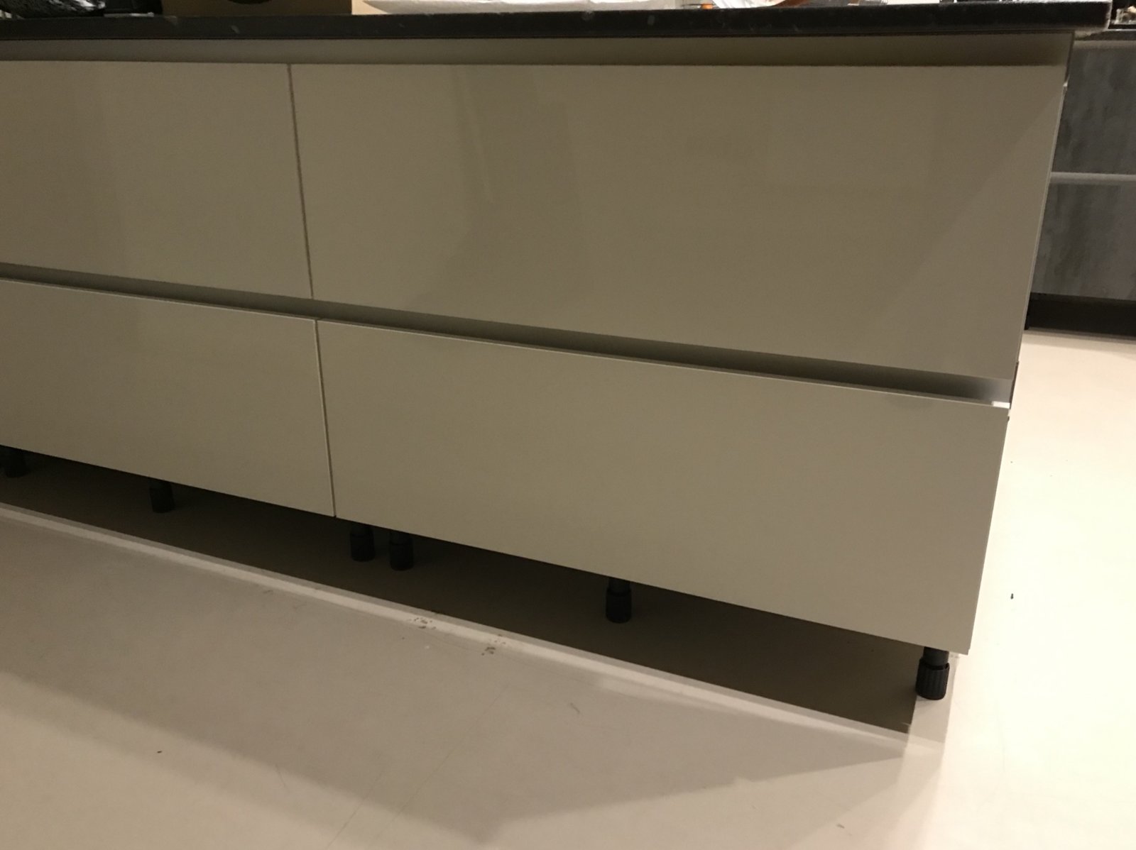

Cool, thanks for your help with this. Do these images help? I’ve also included the contrasting colour too which “seems” better quality.
Thanks for the photos. I'd say they were PVC or ABS edge banded. TBH they don't seem at all bad - but then I'm not viewing them in the flesh
I don't think PVC edging is much good. I remember there was an extra charge for the laminate edging, but it is just like the face laminate, looks good and durable. I would worry that PVC would peel.
This isn't the soft stuff they were using 30 odd years ago, John. Modern PVC and ABS edgebanding is applied using a PUR glue on a purpose-made edgebander machine and is both tough and quite durable (but like anything in a kitchen don't direct hot steam persistently). It rarely peels off when correctly applied and is far superior (wear, peel-resistance, impact resistance) to the pre-glued melamine tape you get for low-cost edging tasks. It's also a lot less brittle that HPL (laminate) and doesn't have a dark brown or black edge at joints. We use it a lot on carcasses supplied for interior fit-out (shops, bars, restaurants, etc) precisely because it is so durable and stable whilst being relatively economical. The only thing better (nicer) IMHO is solid wood lipping - but in comparison that costs an arm and a leg a there is a lot more work/material cost involved in producing boards that way
You're right, they do look cheap. I would accept that material for internal shelves, but not doors. Those corners will be peeling and cracking within months.
