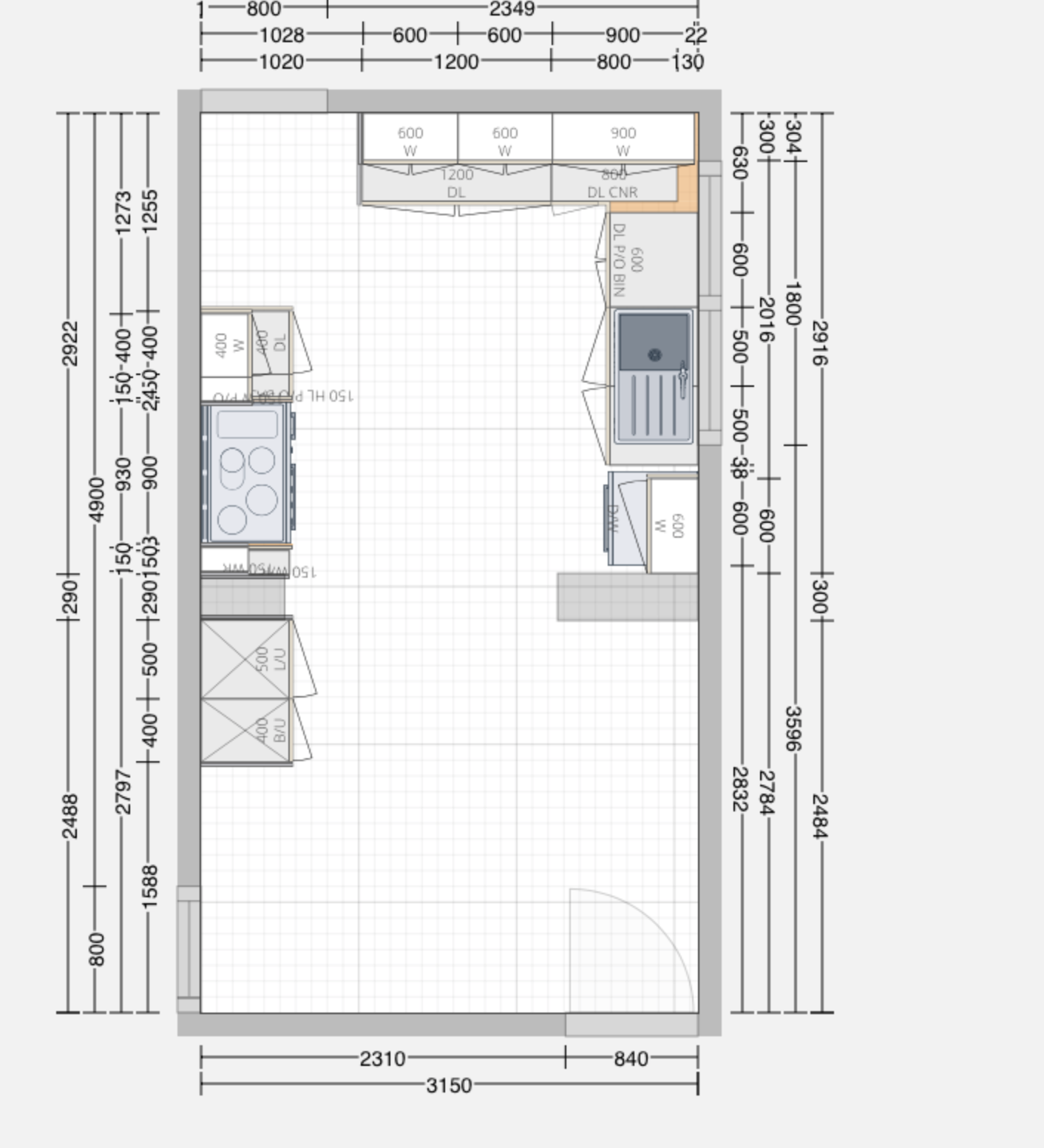

I am putting in a kitchen but don't know which is best next to the corner unit the 500mm base unit with the sink unit and the 600 bin unit with dishwasher at the end or the 600mm bin unit then sink unit and 500 mm unit. which would be better normal base unit or bin unit next to corner unit (its a 800mm blind corner unit)

Corner unit, bin unit, sink unit, dishwasher. Also if youre right handed I'd change the orientation of the sink so that the drained is on the left as you'll as this is ergonomically better
Sorry, pressed post before I'd finished.....your dirty dishes this way will stack up on the worktop above the dishwasher making it easier to load, not on the opposite side of the sink.
Difficult to comment without knowing how you are using the kitchen? Any dining area ?
