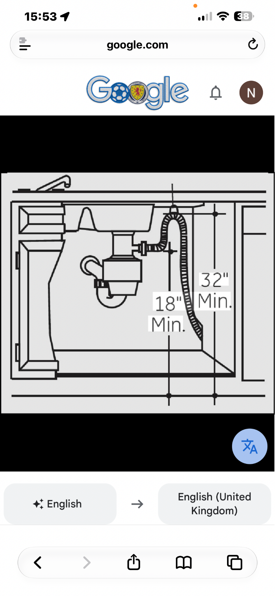

Thanks, I'm confused - dishwasher hose is the dark grey hose on the right which is higher than the discharge point which is the pipe that meets the trap at the bottom?
It could well be that the pipe is slightly uphill or level so I guess I could look at adjusting it downward
Sorry yes sink overflow seal has dropped down the back. I think there's no way to retrieve it unless I take out the supporting cabinet shelf to get under and around but I fear that the supporting shelf is holding the sink in place so it will fall out if I remove!
Grey discharge hose has to have a high point above outlet, your hose is pumping up into waste, not down.

Thanks for the help all, sink is now wonderfully unblocked and runs like a dream.
After replacing the trap I damaged I filled the sink, sealed off the overflow pipe with my hand and used a plunger and proper gave it some using muscles I've not worked as hard since I was a teenager
There appeared to be a big air block which burst and the sink drained immediately.
