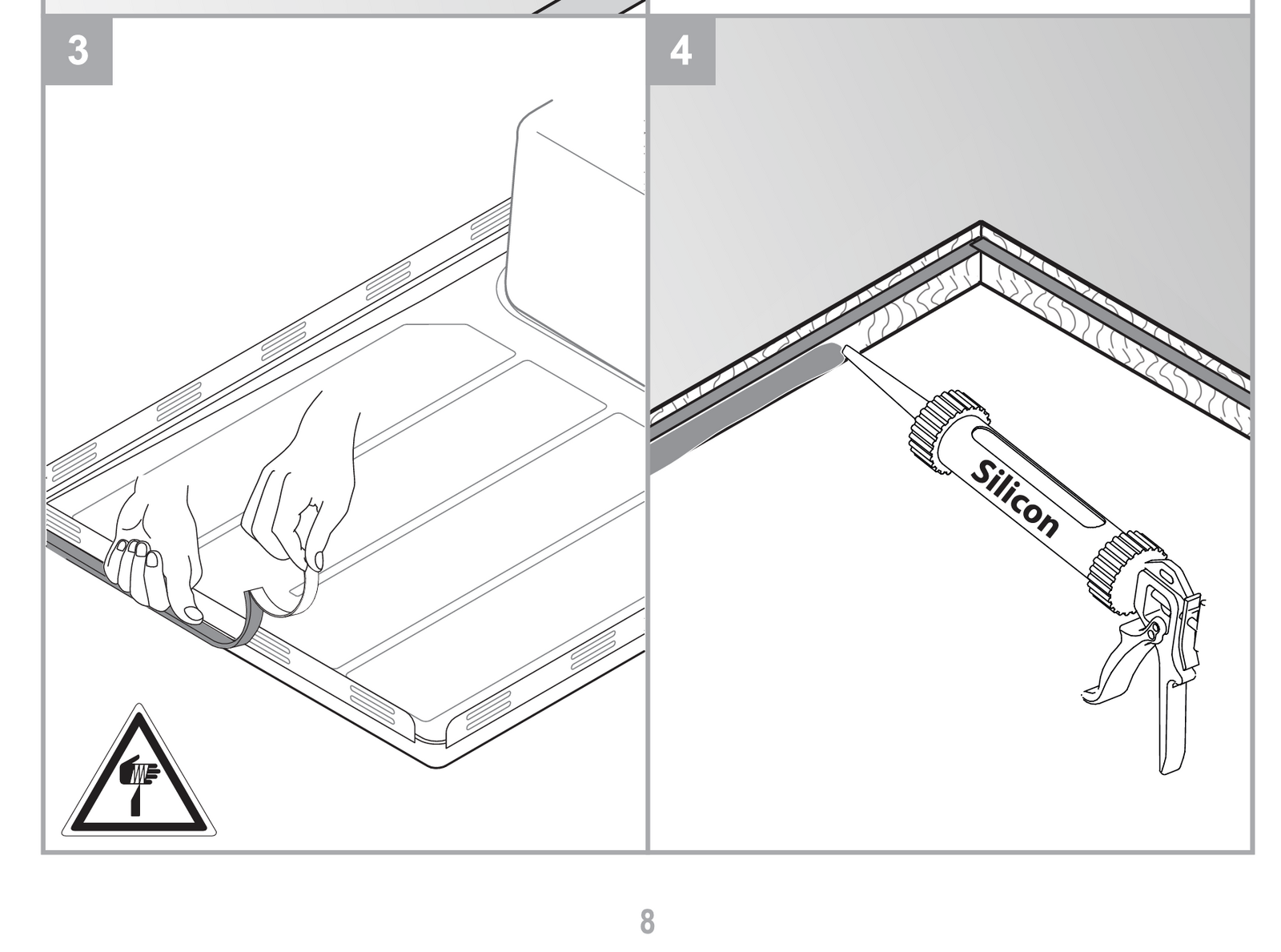

The sink came with a roll of adhesive foam tape so I applied that to the sink and lowered it into the hole in the worktop. The thing is that no amount of tightening the clips will pull the sink close enough to the worktop (they can't compress the foam enough). There is a ~2-3mm gap between the worktop and sink all the way around. If I tighten the clips any more, they just bend and fail.
Am I doing something wrong or should I just expect this gap? It looks pretty terrible. I'd really like it to sit cleanly against the worktop without sitting 3mm proud of the surface as it currently does.
Suspect I just need to start again, remove the tape and use silicone?

Did you overlap the foam strip and trim off excess?
I did overlap the foam but posibly not enough. I had about half (~3mm) in and half outside the perimeter of the sink. Didn't want to go too muchg thinner than that but maybe that is how the tape is meant to work?

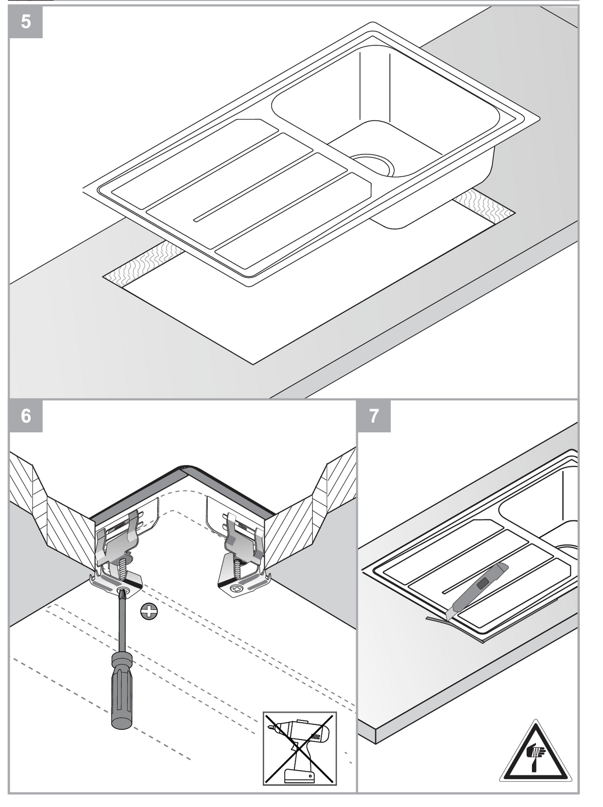

The clamps are to hold it down not to pull it down so it would suggest that the hole isn’t quite large enough to accommodate the sink and is binding at the sides.
No, it fits great without the foam. Nice and flush all the way around.
If the clamps arent't there to compress the foam, what is meant to compress the foam? It's pretty springy and the sink is really not that heavy.

The foam is to form a seal .
The foam isnt waterproof, it is water resistant it requires silicone as a secondary product to create a waterproof seal.
I dont see the point in using foam when the secondary product is both an adhesive and a waterproofer.
Is a bit of a puzzler, there must be a reason why they've supplied it and also suggest to use silicone.
Sinks supplied by outlets such as b&q or homemade screwfix etc tend to come with a foam strip.

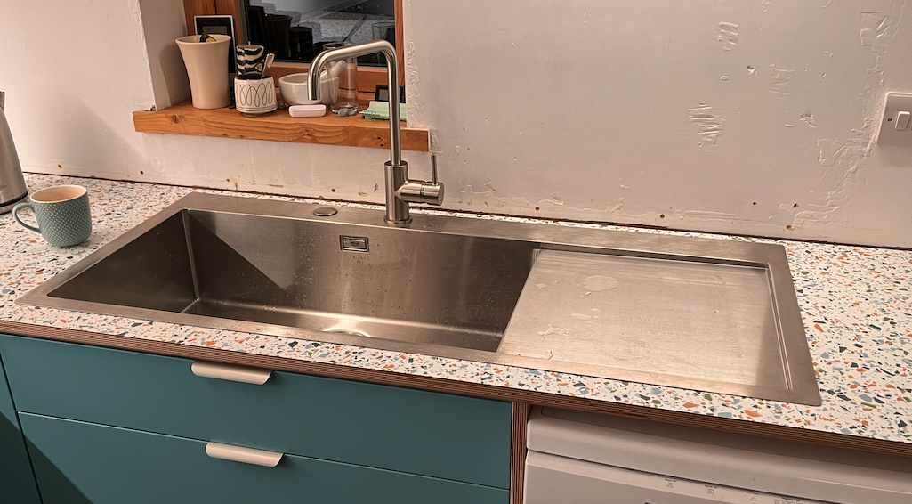

I fit mostly Kohler. Blanco Staiinless Steel and Silgranit and occasionally Villeroy & Boch.none of which feature a foam seal.
I fitted this Blanco today on a bed of Silicone!

Update on this:
I didn't have time to refit the sink so left it sat in place meantime. Over a few days, the foam started to compress under the weight of the sink (though only at the sink end, the lighter draining end still sat proud).
Encouraged by this, I got some better clips (where better means the steel is sprung steel vs the softer steel used for the previous clips) and fitted those:
By using these and G clamps to hold the sink down in place whilst tightening the clips I was able to get a much better fit. The sink now sits only a fraction of a mm proud and looks pretty good.
So, in summary, the foam tape worked but I needed better clips (sprung steel not soft) and had to clamp it down during install. It's a bit of a faff but at least it's a 'dry install' and can easily be reverted to silicone later on if needed.
