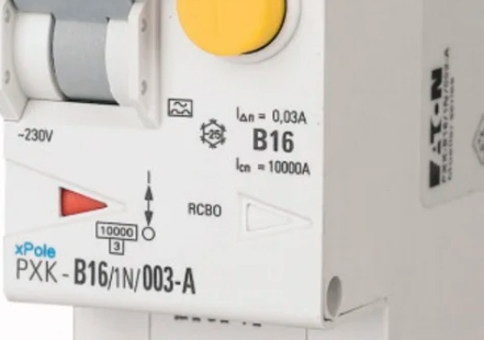

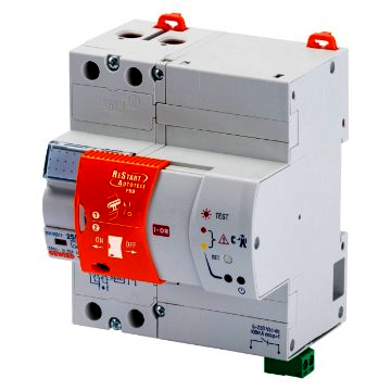

I did look at the X-Pole X-pole.jpg with the warning dart to show getting near to tripping current, and the temprcd.jpgauto resetting type, now no longer permitted for domestic, but the ability of the RCD not to trip with spikes has moved on, in the old days there were no type AC, A, F, B etc, were some type S my son bought my old house from me, and fitted a modern two RCD consumer unit and tells me it has never tripped, as to if he would admit it should it trip after the ribbing I gave him for no using RCBO's I don't know!
I thought I was buying type B, plastered all over the packets, but after fitting found type AC, slowly replacing with type A, but in no hurry, as not primary protection, house on a TN-C-S or TN-S supply, depending on if using DNO or batteries, so RCD is an extra protection.
