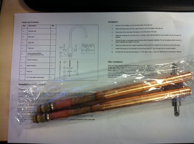

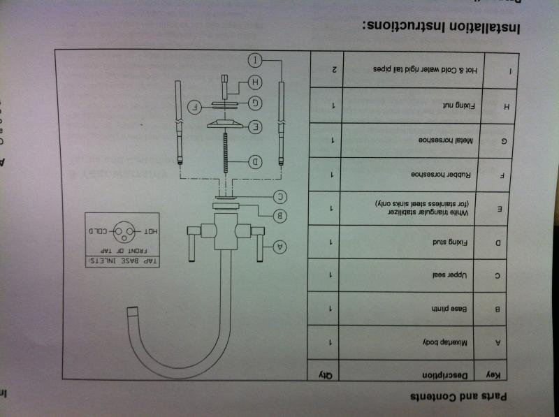

Thanks for the replies. I cannot see any mention of the pipes acting as a reducer but they do taper slightly. Please see attached pics - they might give a clearer picture.
The installation says in the last step:
'8. Connect the hot and cold tail pipes to the water main using a 1/2" BSPx15mm compression fittings.'

Those copper tails are 15mm diameter, and therefore will fit into any 15mm fitting - compression, push, solder, plastic et al.
Again, its the threads on the other end that play the important part here.....they may screw in fine, but they may not!
