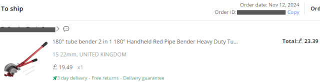

One step at a time! Got myself a beginner pipe bender for giggles. Will be needing some cheater bars. With this, hopefully I will be able to remove the compression elbow hanging off the cold tail. I want to terminate compression fittings with great prejudice.

Have a look at some YT videos, some good ones out there
